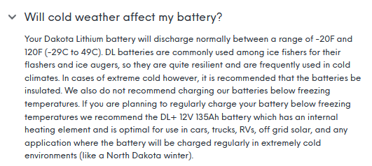

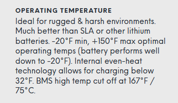

The ideal data point would be the internal battery temp. This is what Battleborn (and others) is using to regulate. So we're left, at best, with an external surface monitor. The IR cameras or guns are good for this, but only at a single point in time.
I would suspect that with some type of battery heat shield or blanket that heat could be minimized, however with as cool as it was during my runs I was surprised to see a temp in excess of the advertised battery limit (140F for Battleborn). Dakota has limits that are different depending upon what you click on.
I'm going to keep running data as we move toward summer. But as much as I'd like an under-hood solution for space management, a cargo-area install seems the most prudent for my use case.
From Battleborn:
From Dakota for 135Ah (135Ah FAQ):
From Dakota 135Ah spec sheet:

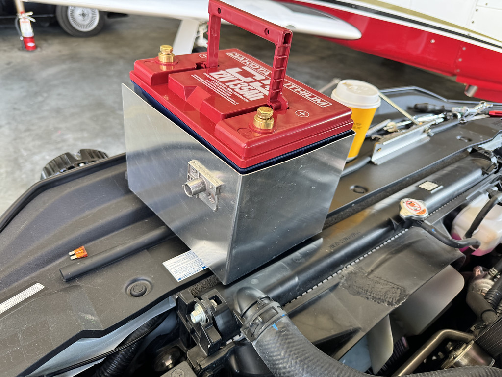

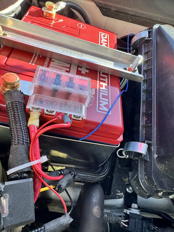

All I have to report is no shutdowns yet from the Dakota. If I can find an economical way to put a probe on the battery surface with a data logger under the cooling shroud I will do so. The Dakota BMS does not broadcast battery temp to the best of my knowledge.
The battery cooling fan thermostat turns on at 40 C and is always on after 6-10 minutes of driving. Runs for about an hour to 90 minutes after shutdown. Hard to gauge how effective it is, but the theory is that the aluminum acts as a reflective heat shield while the cool air flowing behind the shield prevents re-radiation and air transfer.

This is how Cessna cools their firewall forward starter battery installation. Blast air routed from the engine cooling baffles ducted through the 1” scat tube. I took a similar approach except I extended the shroud to cover three sides of the battery.
I like your creativity. The thing aircraft have going for them is the constant supply of cool air. Completely passive system; if it's flying it's cooling. Hill climbs in Moab in summer temps are a different animal. Interested to see your results as we move into hot season.
Exactly. That’s why I used a small blower with a thermostat control- which has the added advantage of running after engine shutdown to prevent heat soak. I pulled the trigger on a temp data logger with an adhesive mount k type thermocouple to take some measurements over the next few week.

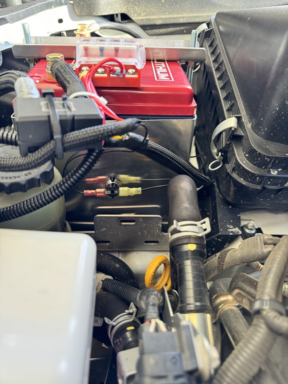

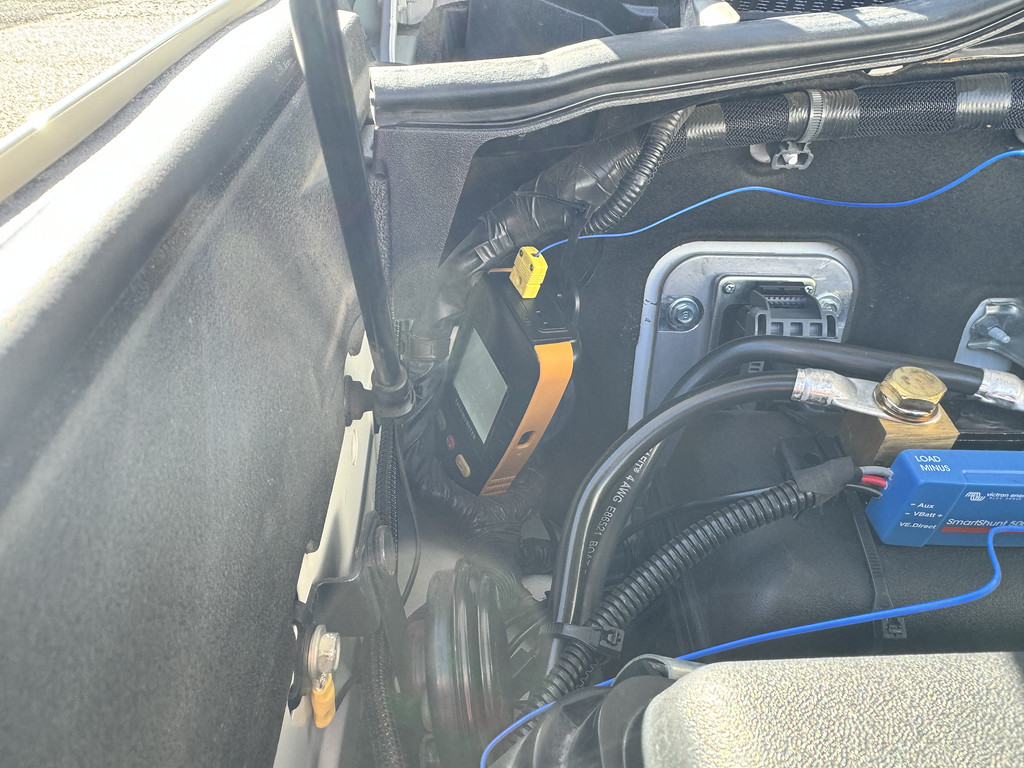

Thermocouple and data logger in place. Right now the TC is just floating between the shroud and the battery. I have a second channel which I might tape to the side of the battery furthest from the engine.

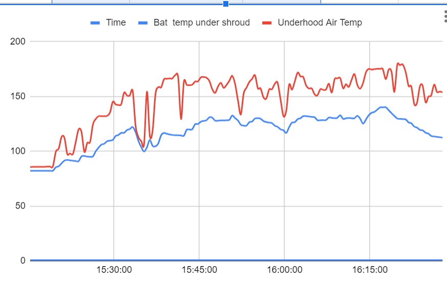

I have the second TC in free air adjacent to the PS reservoir. The spots where the two curves come closer together was a brief freeway section. Generally the shroud seems to work well in keeping temps stable and quite a bit lower than underhood air temp at city speeds.
@gluaisrothai you've probably already posted this elsewhere, but what did you do for your battery box? Custom made? Repurposed from something else?

Good stuff! Toasty in there and box is doing a great job.
What was the ambient conditions and use case?
Looks like underhood has potential to get hotter still.
Toasty is right, almost burned my hands on the datalogger. 75F ambient, daytime, sunny, heavy traffic including in the Webster tube from Alameda to Oakland.
Hi- just 0.040” aluminum cut on a band saw and then bent using an el cheapo sheet brake.
