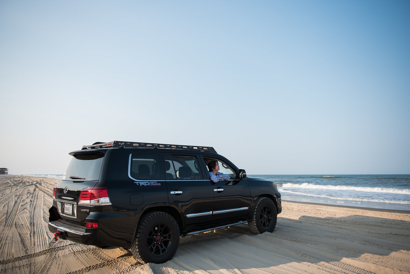

My wife and I road trip a lot, we camp, hike, fish, and do offroading whenever we have time. I set this up as a reliable/capable/comfortable vehicle to do all of that. My 100 series took us all over America national parks, we paid through the nose for gas but smiles per gallon was worth it :) This one gets a little better MPG but not by much. I'm building a sleeping platform in the next couple of weeks then some storage up top of the rack so we can sleep inside.

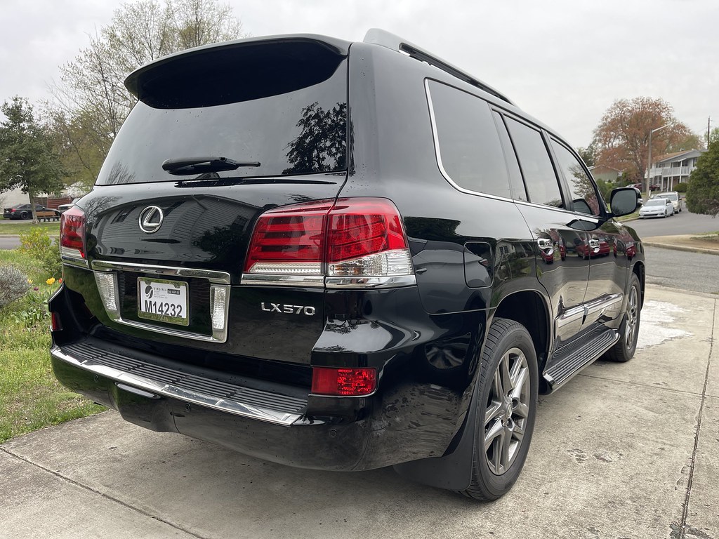

Day i brought it home

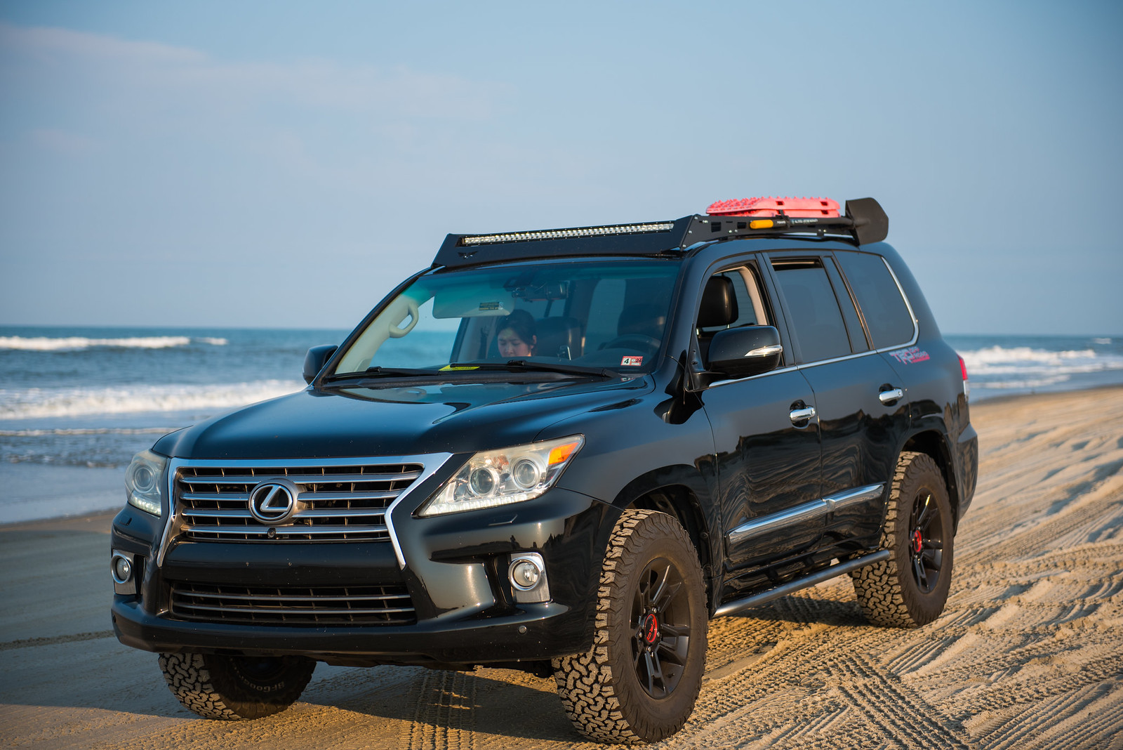

After a few mods, here's what it looks like now

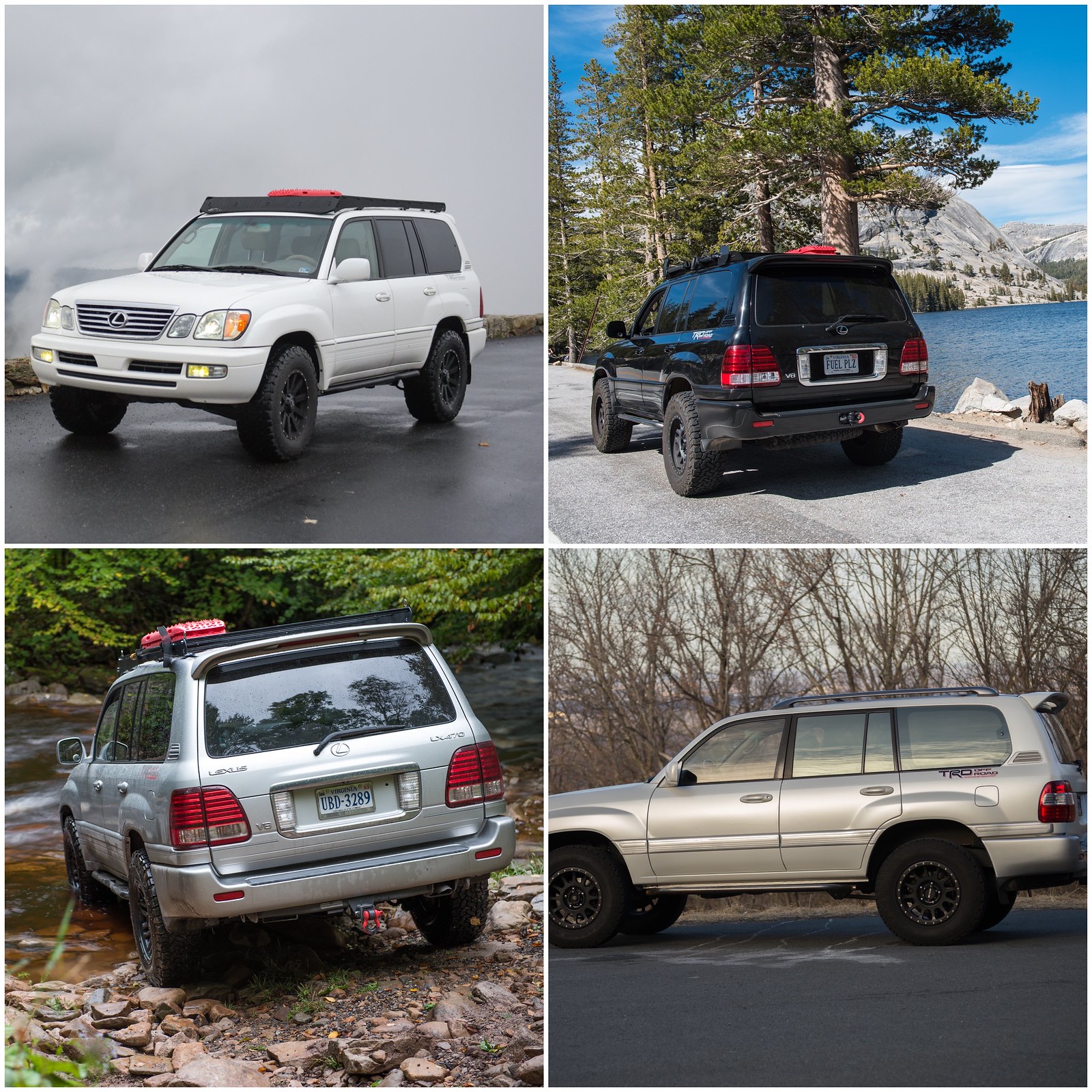

Here's my previous 100 series, I had 1 more but it was stock and didn't have it for long

is your last beach pic in Corolla? I think I recognize that house.
Good eye, it is. Weather was awesome and the sun was setting, great picture opportunity
