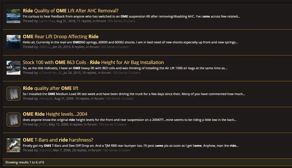

I have the OME 865 springs in the rear, a mild crank of the torsion bars up front, and Ironman Foam Cell Pro shocks. Huge improvement. The stiffness issues often reported seem to be mostly centered around the OME shocks. Reading through the search results posted above should flesh that out for you. Can't recommend the Ironman shocks highly enough, especially for the price.

Thanks for the input and thread references. Going to take it to Slee and see what they can come up with. I will have them complete install.
