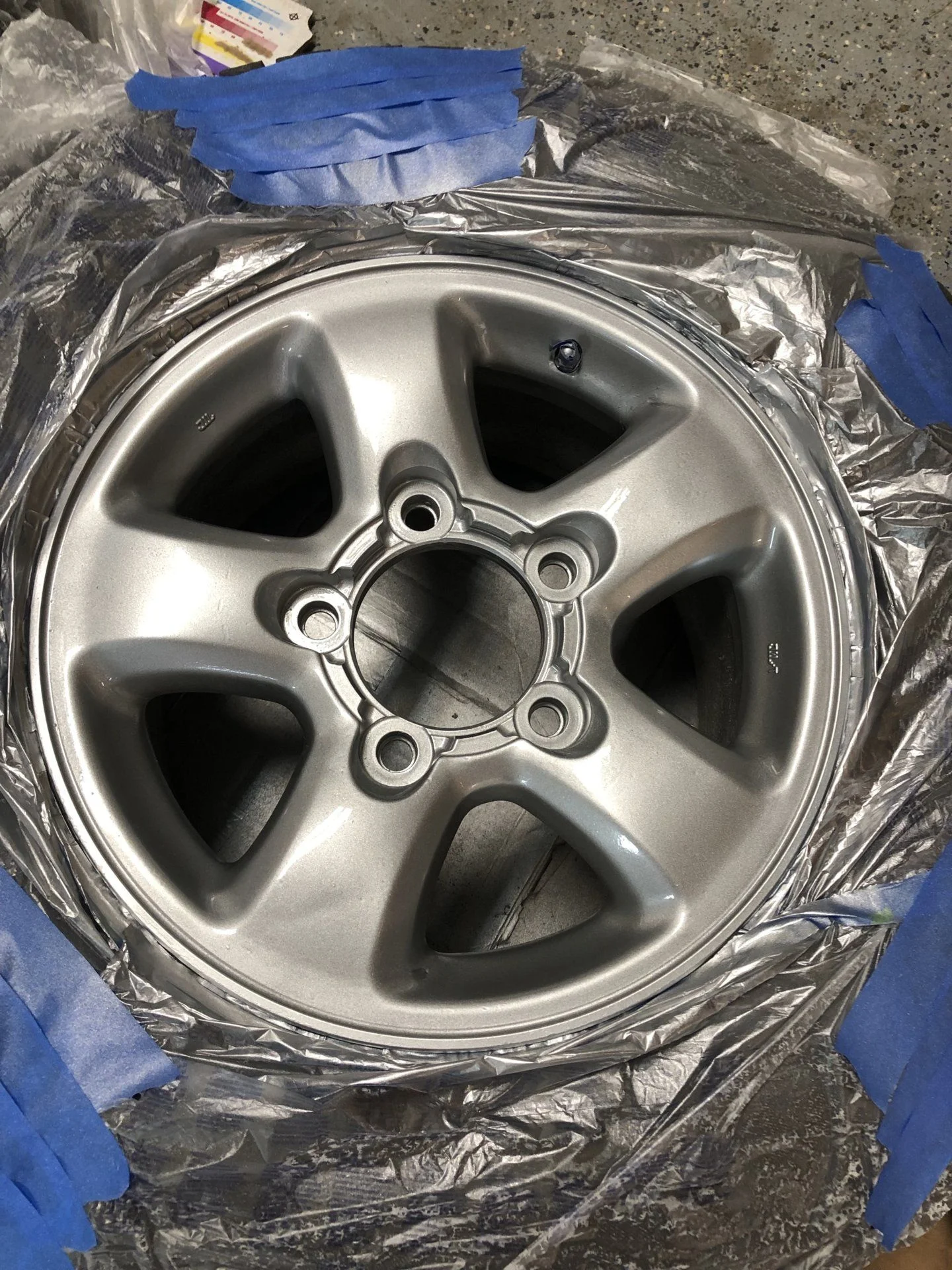

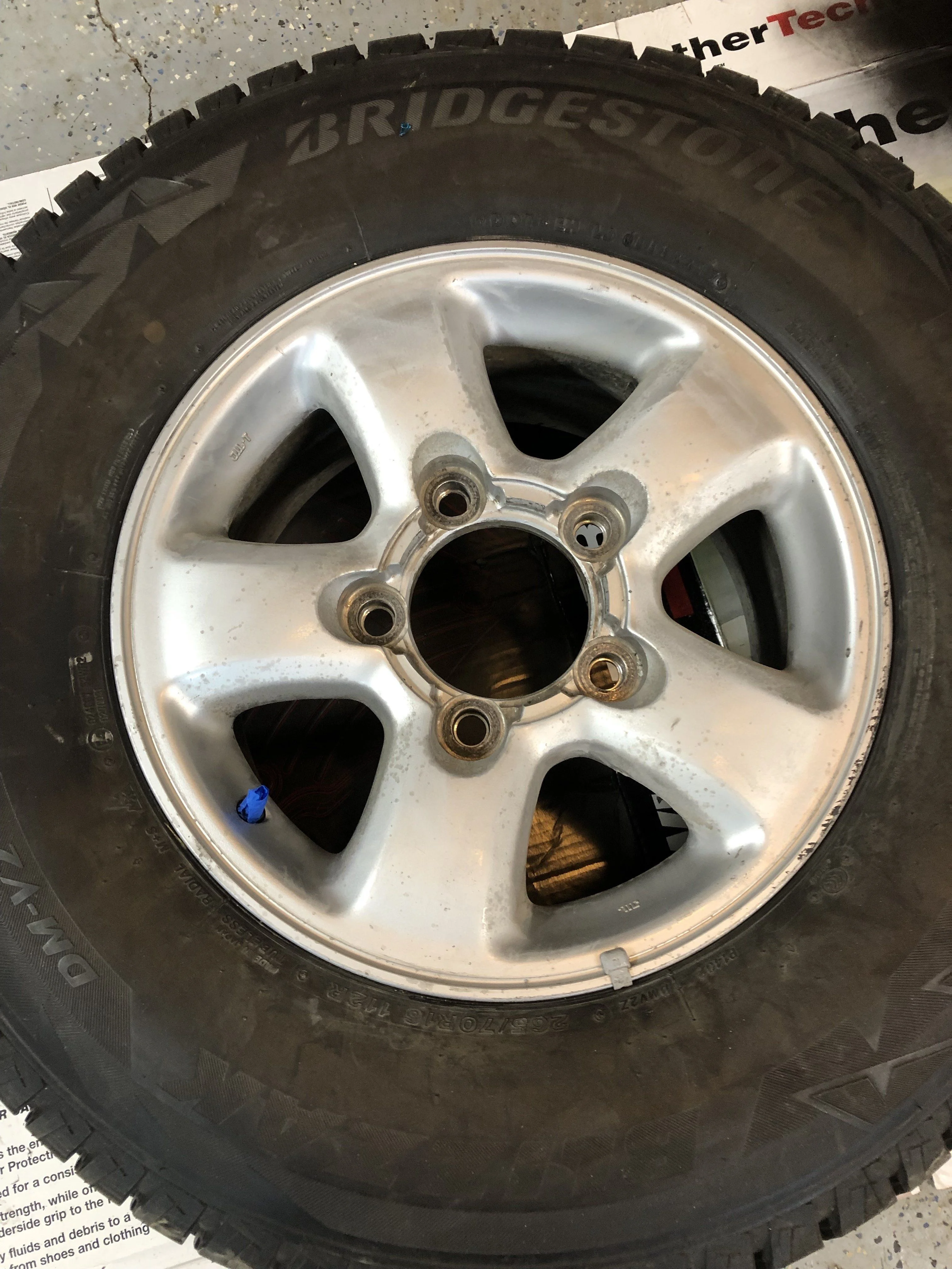

If you don't want to drop a bunch of cash on new wheels, think about fixing them up yourself. I just sanded and spray painted a set of stock 2000 Land Cruiser wheels myself for about $20 in total supplies. They look just about as good as they would have from a professional paint shop and it was a pretty simple job.
I've taken too many items to powdercoating places and ended up having them rust/peel in a year or so.... Now I just take on the smaller size projects myself.

I used this paint (Rust-Oleum Automotive High Performance Steel Wheel Spray Paint), but I bought it at Lowes: Rust-Oleum Automotive 11 oz. High Performance Steel Wheel Spray Paint (6-Pack)-248927 - The Home Depot
There is actually a good pic on that Home Depot site link showing some Toyota wheels someone else decided to paint. I hadn't seen that until searching for a link to share this morning. I will try to find my before/after photos to post.
I did not use any primer before painting the wheels, but I didn't have any bubbling/peeling issues. I just had rust bloom and bleed through occurring on my wheels. I did hand sand my wheels prior to applying the paint, first with a 200 grit sandpaper and then with a 1000 grit I believe. I'm sure you will have a longer coating life if you apply their primer before the spray paint. I think the accompanying primer was on the shelf right next to this product.

There are my before/after photos on one of the wheels.

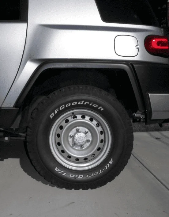

Prior to the Land Cruiser, I had an FJ Cruiser for about 4 years. I painted the OE black wheels with Duplicolor wheel paint - found a color almost identical to the Toyota Ti Silver. That paint held up extremely well. The only touch-ups were after kissing rocks on the trail.
