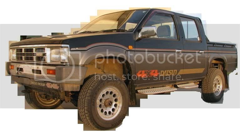

3. 1988 Nissan Pickup TD27 4x4
-Im not sure if it's turbo'd or not
-Local truck
-63,000 kms
-5spd
-Not a lot of info in the listing but I have sent a request for more to the owner

The Nissan also has its issues, but is more reliable than the Toyota 2LTx engines.

That old crew cab Nissan looks great! Would have loved to swap that body on my old Nissan pickup if I still had it. The Z24 gas engine with the TBI in my old truck was super reliable, and adequate for power for a little 4 banger.
Minnime, $5000-6000, is pretty low for a JDM diesel and not to expect their to be mechanical or rust issues. There have been some exceptional deals on some Canadian HJ60s the last year or so in that price range.
If you have an itch to do your own work and some basic tools, the Nissan would be dead simple to work on. All three have a gas engine North American counterpart which opens up getting most parts as being a breeze. The plus on the TD27 is that it was also an engine used by Nissan in forklifts and other industrial applications. So, you have a wide selection of sources for parts. Also, being an engine primarily designed for industrial use, it 'll be much more dependable than the engines in the other two. It'll be comparable to a 3B - strong but slow. It should take well to turboing (say around 9 lbs boost). This is something you would want if you are always running near or over 3,000'.

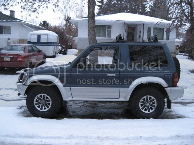

So, I made the trip up yesterday to check out the pajero. I must say it drove extremely smooth. Here are some additional details I uncovered:
-The previous owner imported and owned the truck for 9 months
-Owner is selling because he needs a four door for growing family
-The vehicle was transported from the docks to CVI Motors in Richmond where a full lube service was performed.
-New windshield (CVI)
-Driveshaft was removed and balanced (CVI)
-Steering alignment was performed
-Airbags were added to rear with easy access adjustment nipples (CVI)
-Replaced timing belt (CVI)
-Added harness connectors in the rear and front for a Warn winch
-Removed and replaced the stock exhaust with new 2.5" pipes (CVI)
-Oil pan and block heaters added (CVI)
-Aftermarket cruise control system installed (CVI)
-Driver side cv joint replaced with new (CVI)
-Ford escape roof rack installed (CVI)
-All filters replaced (CVI)
-New rear calipers, discs, and pads (current owner)
-Boost and voltmeter gauges installed (CVI)
-Pyrometer was installed during the vehicles time in Japan
-Both Canadian owners used Power Service ULSD Fuel Supplement in every tank.
-I thoroughly inspected fuel lines, fuel rail, injector pump and found them to be dry as a bone.
-He is very cautious with his egt's while driving
-He replaced all four tires and the spare when he purchased from previous owner. Approx. 60% remaining on four and the spare is still 100%
- The extent of his 4x4ing with this truck was crossing a 6-12" deep stream while out mountain biking
-He has driven the truck from Calgary to Whitefish twice. Multiple trips to Canmore, one trip to Idaho and multiple trips to the Lake Louise area.
-Brand new IPF headlights
-7" PIAA's installed (CVI)
-EVERYTHING works
-Current owner has never! driven in 4wd while on dry surfaces (Taking his word on this one)
-Glow plugs cycled before any starts 5 degrees celsius
-Always plugged in anything below -10 degrees celsius
-Always allowed a warm up period before driving in winter
- Does not smoke what so ever!
- Idles smooth an consistently
-Clutch feels strong
I will add more if anything else comes to mind

CVI is one of the better respected shops by the Delica and Pajero owners. Apparently the owner, like many of the supporting businesses here on MUD gives a lot back to the local Mitsubishi community. All the info you posted makes this one sound like a great buy. Is it a SWB. Nothing wrong with that if it meets your needs. But remember if it is a SWB, it will not be great for car-topping a 12' boat or pulling a trailer of any size or weight. Just imagine what is safe to do with a Jeep and then decide. Any yes I have seen Jeeps pulling big 20' fiberglass boats. While the Jeep was indeed pulling, it was the boat on the trailer doing the steering.
For car-topping, you can improve the stability by getting rims with a better offset - if it doesn't already have them.
Yes, it is an SWB. The truck is running stock rims with 33x10.5x15 BFG AT's
that pic had to be old... there is no way you still have snow in AB?
