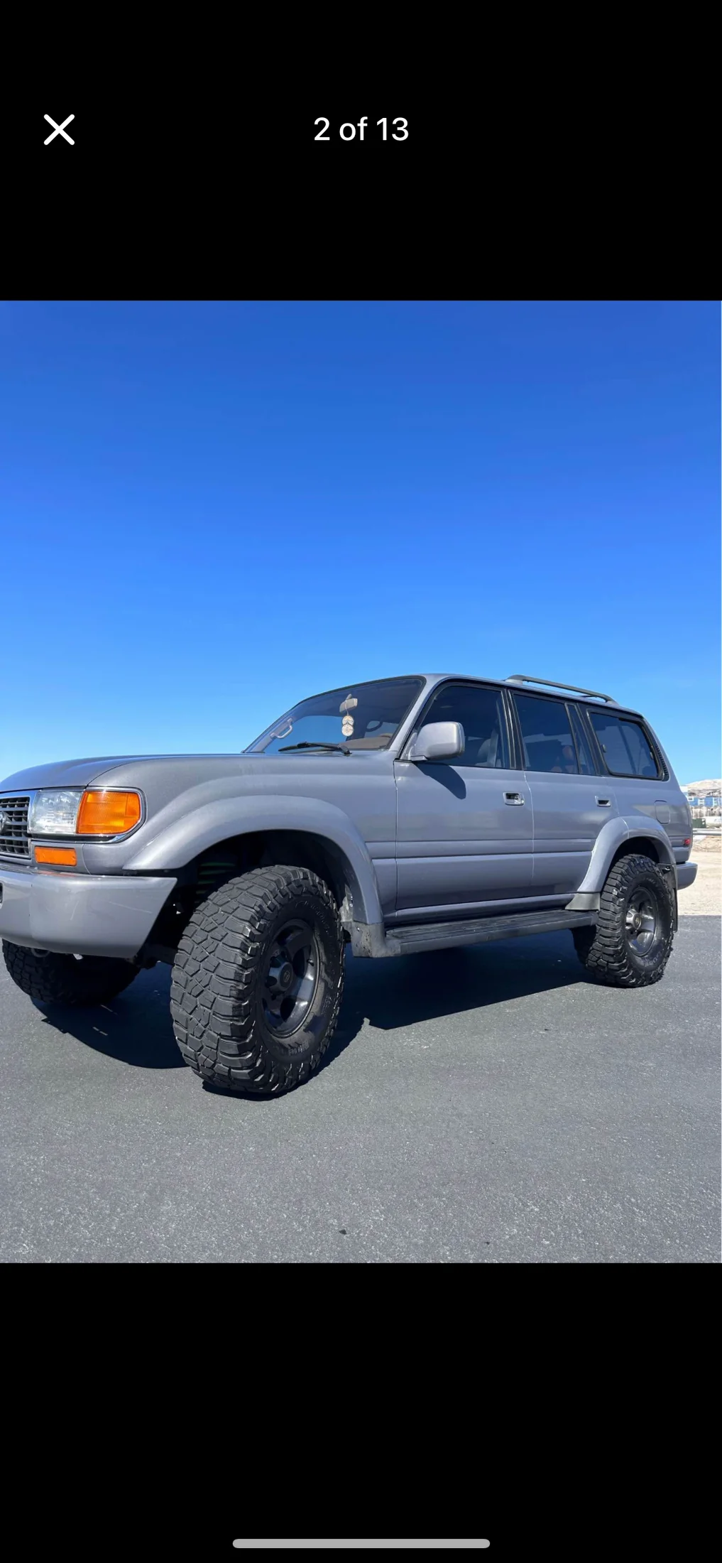

I have been lurking on ih8mud for several years now trying to find my first cruiser. I just found a 1996 ‘80 series in the color that I want and in my general local vicinity. My concern about it is that it has 37s on it (it also has a Ironman 4x4 suspension and lift). While I am sure that the 37s would be great for off-road, I am curious how this would ride when 95% if its life will be spent on paved roads? Would I regret having this size of tire as a daily driver? What do I need to be aware of?
Also, can someone tell me what the process would be to put smaller tires and wheels on. Could I use the same sized wheels or would I need to get smaller ones? And what would I need to do as far as re-gearing is concerned? Any idea what the cost of doing this would be? The rig is already fairly high priced, so just need to understand how much more I may have to drop if I need to downgrade tires and wheels.
In speaking with the owner, it only has a 2” lift on it.
Any help or advice would be much appreciated

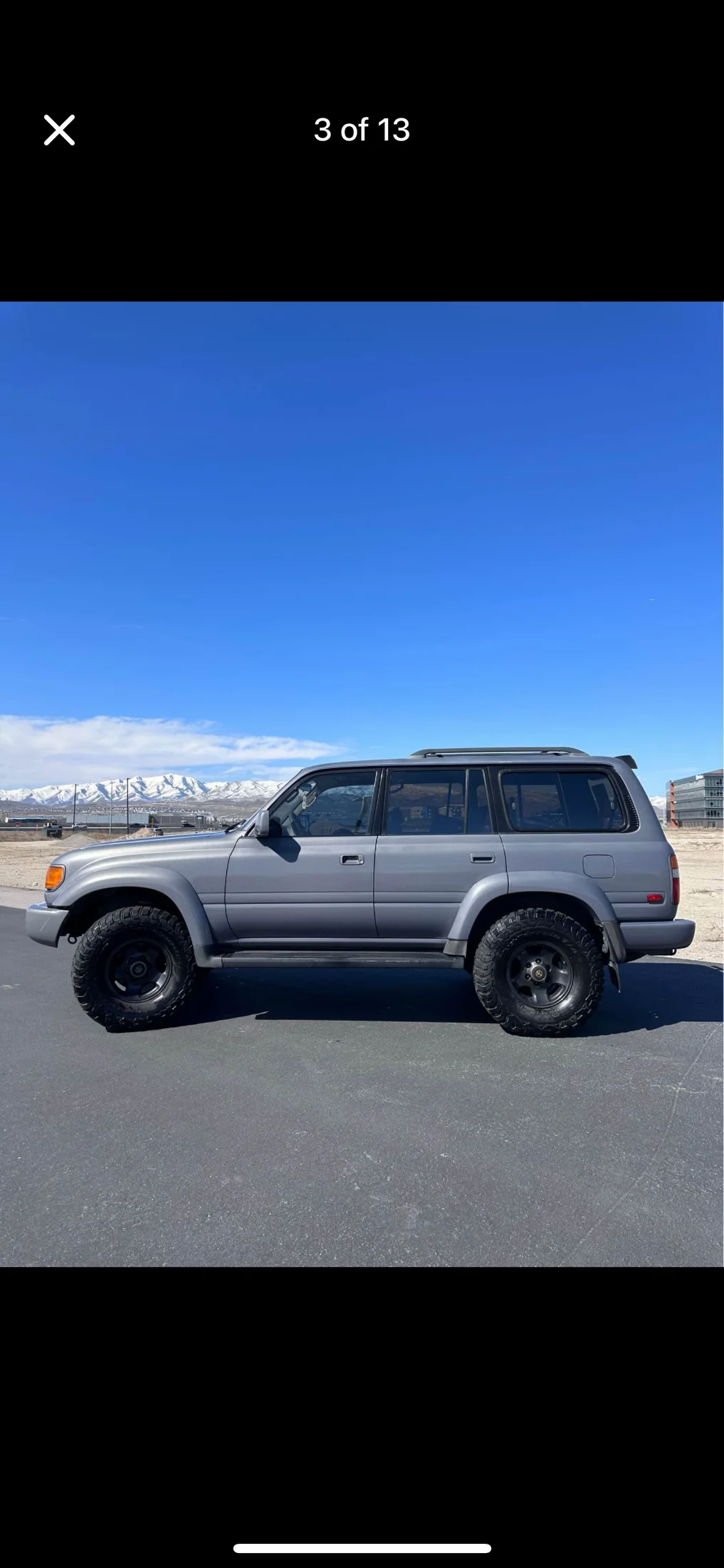

Not a ton of clearance there above the tires, so it may in fact only be a 2" lift. Measure from center of the wheel hub to the bottom surface of fender flares - a 2" lift should be somewhere in the 22.5-23" range. If you were going to off-road, doesn't look like you'll have much articulation because of the tire fitment, despite 37s providing more ground clearance - so you'll actually benefit offroad with a smaller tire, IMO.
Looks like you may be set up perfectly to go to a 33" (285/75/16) AT tire. Much better for normal driving, better MPG (but still bad), gain articulation when you do go offroad, and the size will still be able to do everything you need. That's a great reasonable setup for an all-around 80. You don't NEED 2" for 33s, but it'll still look fine.

Regarding the lift, determine if it's driving OK now. If it does and caster correction has been addressed I'd leave the lift on and go with 33" tires. Not sure if those are stock wheels. It appears they are and someone made the foolish move of painting them.

37s will rub on 2" lift-either at full lock or over bumps.

You can open your check book and get rid of the poverty Ironman lift (that lift is not meant for 37s) and get dobinson IMS or MRR (I'm bias to Dobs) and get Delta control 3L arms (to run 35+ tires). 105 sector shaft for bigger tires and to combat the lack of power-install a Turbo kit from C&C. Or just enjoy what you currently have. Looks like an ideal set up from the picture. GL-good looking fzj80

Those look like BFG KM3’s to me. The largest size for a 16” wheel is 315/75r16, which is 34.6” tall.
In any case, it is a nice looking Cruiser for sure.
They do look like KM3’s and don’t appear to be 37’s to me. BFG lists no 37” KM3 for a 16” wheel, there are very few left that do.
