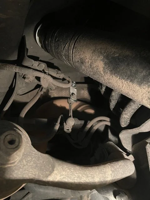

Found the little linkage deal, driver side rear axle, in front of the coil spring.

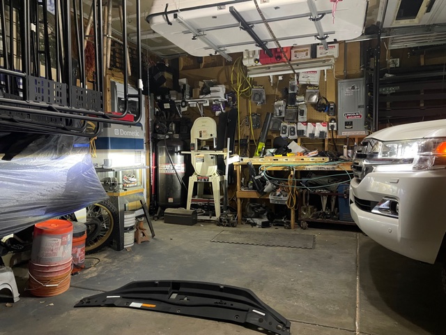

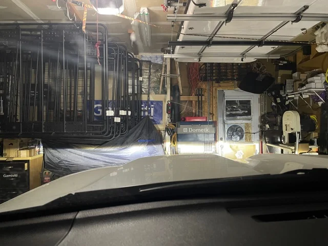

The before pic- note the masking tape on my motorcycle cover. The light cutoff is just over the top edge of it.

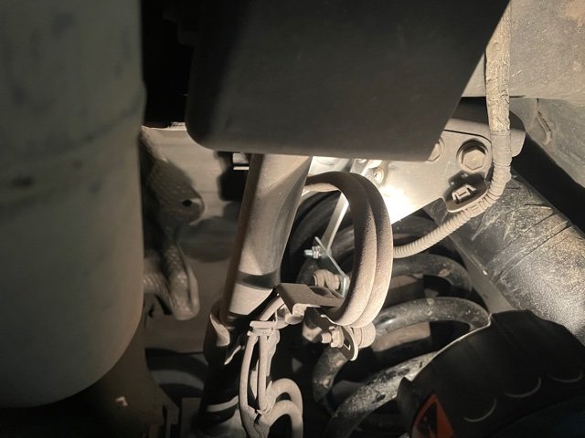

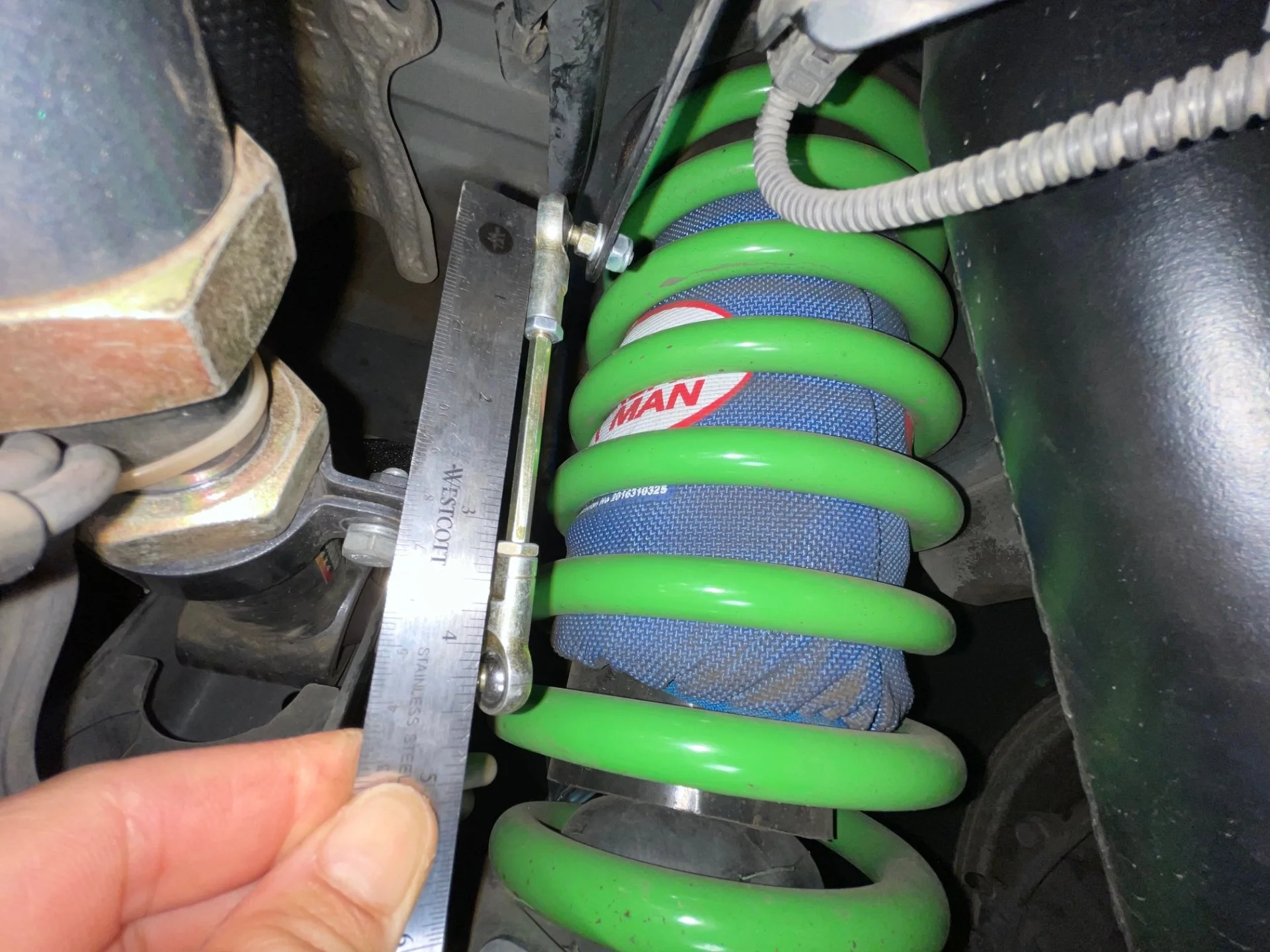

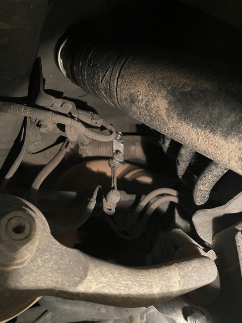

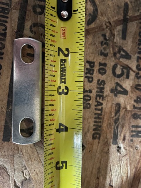

I then watched the TJM video from page 1 here, and it looks like I need about a 2" extension. Looked around the bench, and found a U-bolt I wasn't using, so I robbed the strap from it.

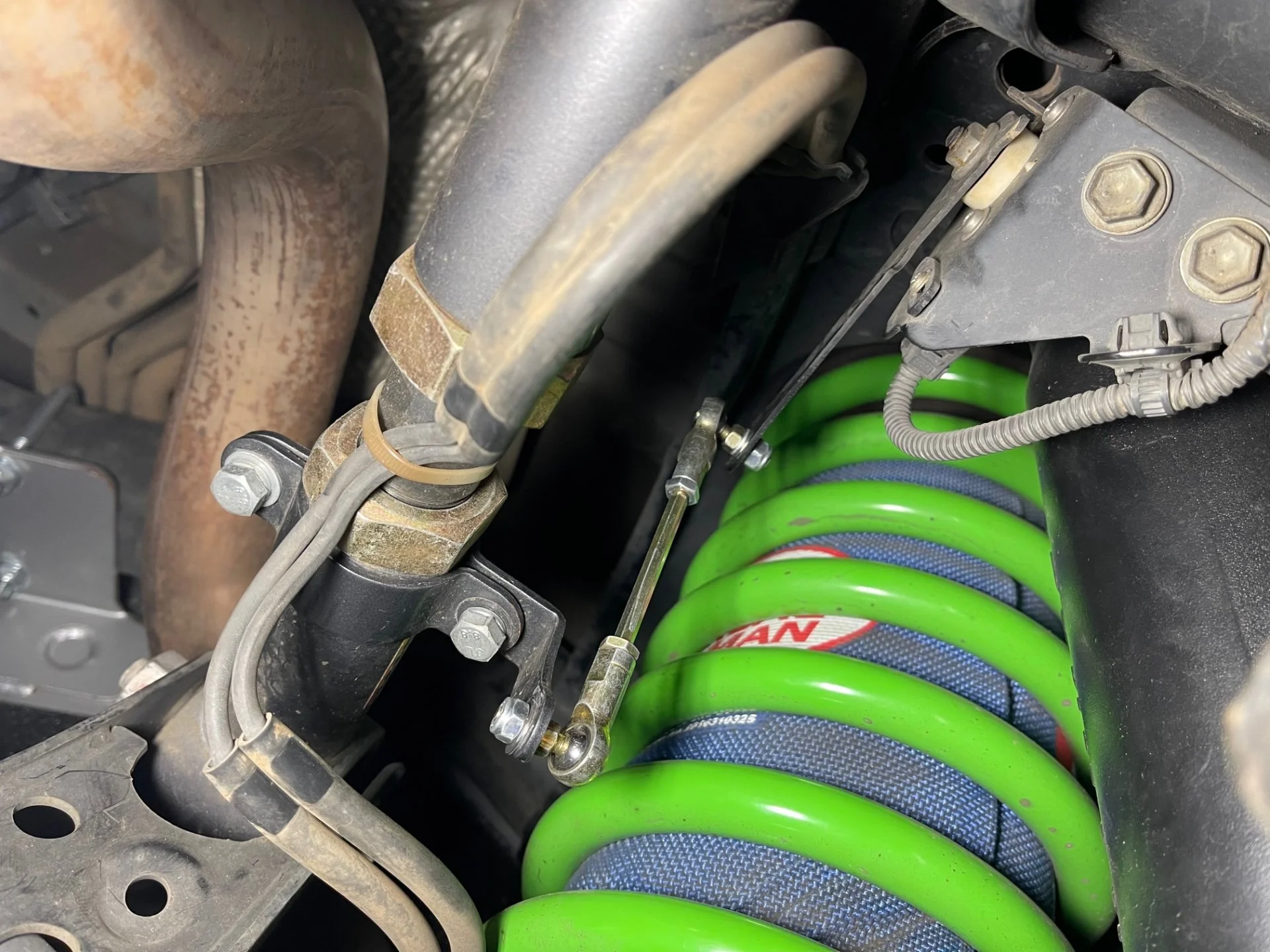

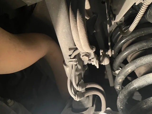

Got another nut/bolt from the parts drawer, then bolted it up, using that U-bolt strap as my extension. Couple pics...
The bolt that's now in the middle of the assembly will still allow this to twist, as I ran out of thread when tightening the nut. But the top one is really right, I don't think it's going to twist at all. I'll drive for a bit then peek under there to see if it moved at all.

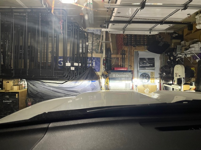

And here's the after pic. I dropped probably 3" compared to where it was before
guessing I'm about 12 feet away? I didn't measure, here's the side shot, and another view of the "after" cutoff:
So there you go, hopefully this helps the next person. A
