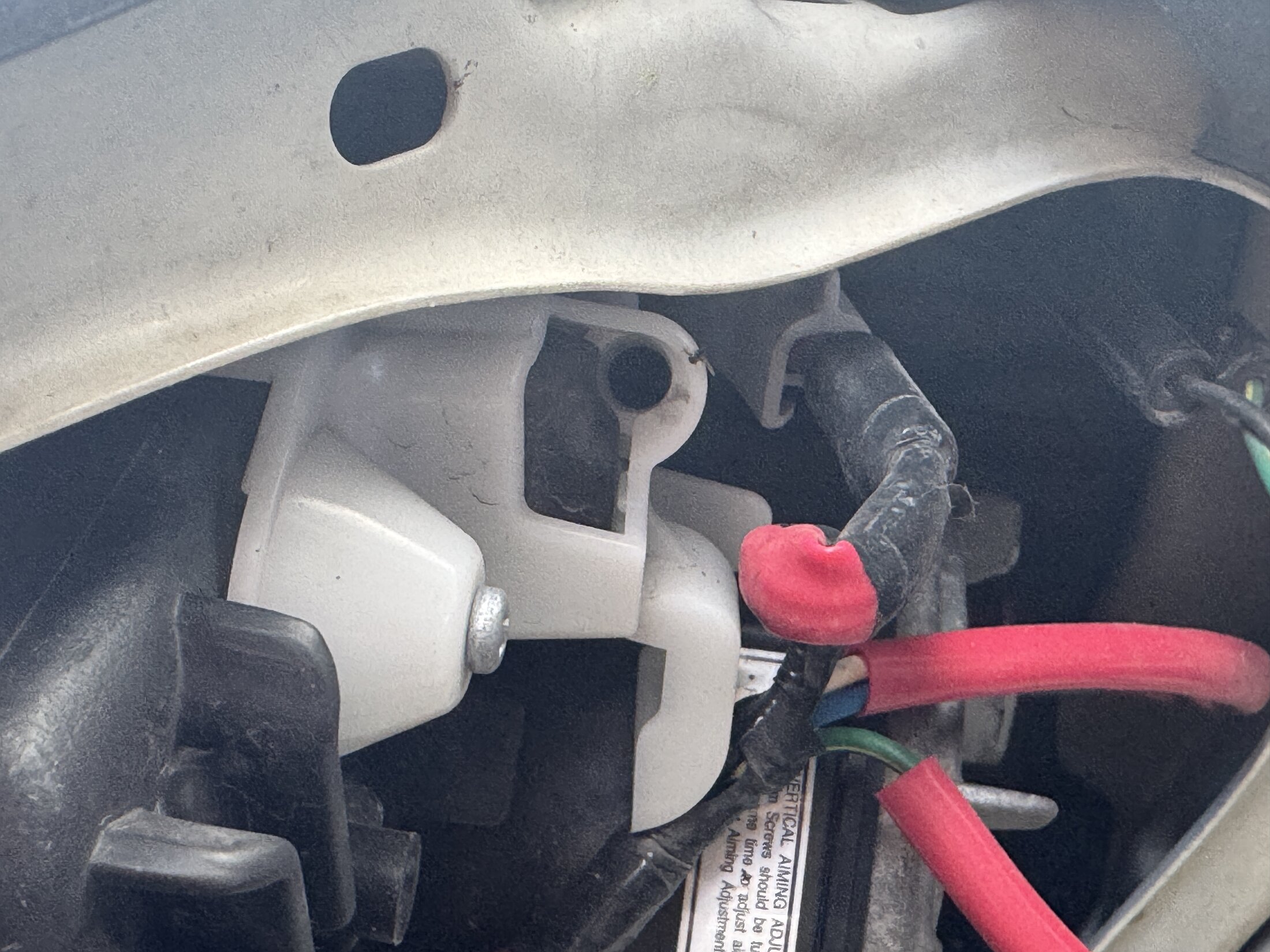

I'm having trouble finding instructions on how to manually raise the headlight position on the 13-15 200. My in-cabin wheel doesn't raise them high enough. Can you help show me where the manual screw adjustment is in the engine bay? tyty

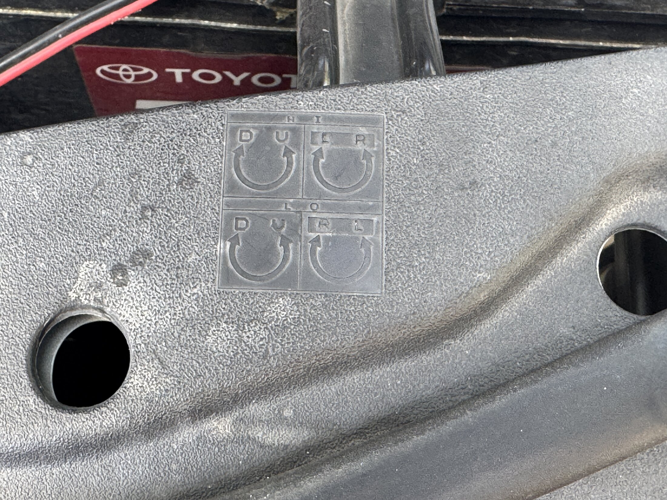

First pic shows the direction to turn

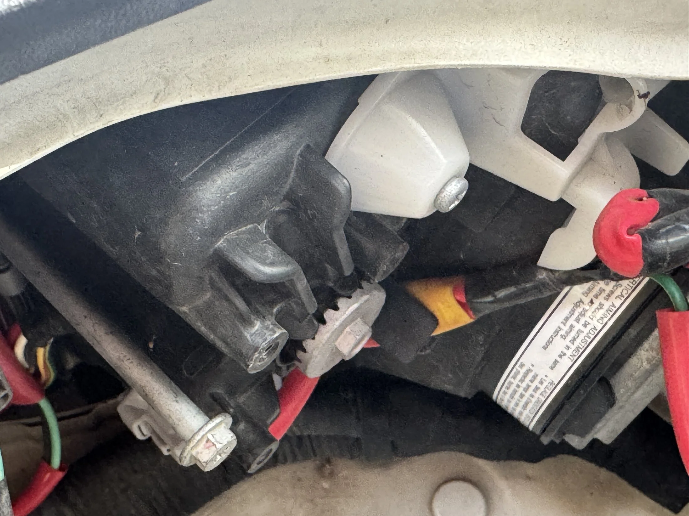

Second is the passenger side up/down slot where you insert a screwdriver, and the star wheel that a long philips one will turn. Note that 13-15 comes with a white plastic contraption on it that relays any adjustment to the low beam to the high beam also. I had to remove this to get the high and low correct on my new headlight buckets, so I adjust them separately. the long screw with the 8mm hex on the end is up/down for the high beam.
This picture shows the left/right screwdriver hole. The black hole in the white plastic. Again, long philips is needed here.
Thanks man! So, just to confirm, the holes in the white plastic are for the HID bulb adjustments? And, for the pass side, I turn right to raise; and for the driver's side I turn left to raise?
Look closely at the little diagrams on yours to tell which direction to turn.

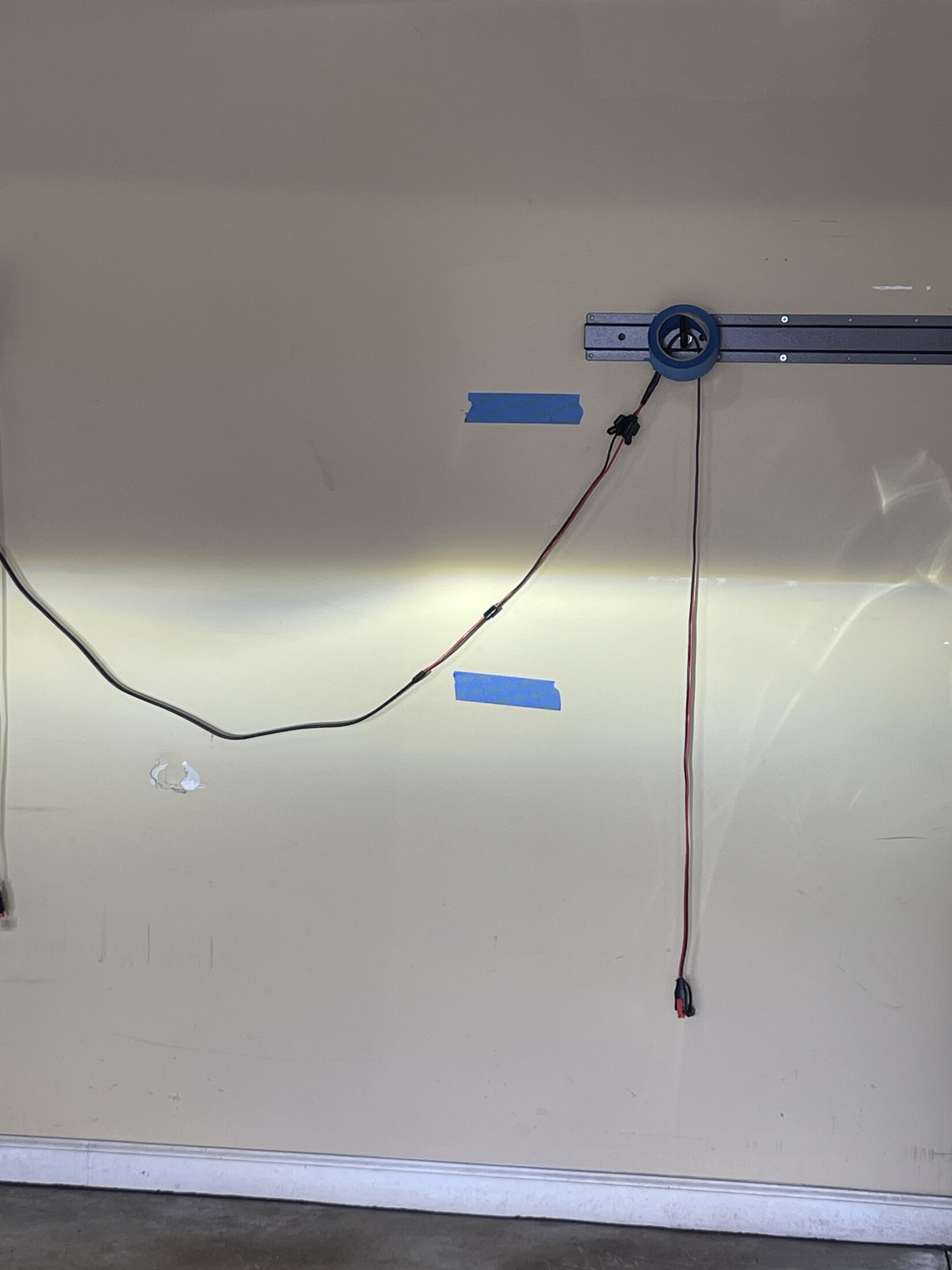

I’m installing the carb linkage fix and I’m unable to get the lights to lower enough. When I crawled underneath I did notice that the OEM linkage was not installed correctly, this had to be from the “adjustment” made by the shop that installed the lift a couple years ago.
Anyway, at this point I’m not sure if:
A: the adjusting sensor is damaged or just out of adjustment because of the improper “adjustment” spun the arm out of position.
B. if I need to manually adjust the lights.
C. Eff it and run it as is.
Following the TJM instructions, my measurements are as follows:
Before adjustment: 54 inches high (Top blue tape in picture)
After adjusting: 42 inches high. (Location of light in picture)
Max allowable hight per TJM 36 inches. (Bottom tape in picture)

Possibly stupid question, but how far from the wall are you supposed to be when you take these measurements?
According to the TJM instructions you should be 16.4 feet (5 meters) from the wall. Lights should be between 29-36 inches high (760-915mm) high.
