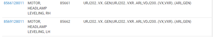

In response to the auto adjust "dance" discussed above and shown in the video... We may not have received the same auto adjusting setup in our US headlamp assembly. I found a used 2020 Sahara on an Aussie for sale website, put the VIN in partsouq and found these parts which I do not believe are equipped on our trucks stateside. You can see the versions of 200 series that they are fitted to.
We did not get the auto adjusting motor in our US headlamp assembly. I found a used 2020 Sahara on an Aussie for sale website, put the VIN in partsouq and found these parts which I do not believe are equipped on our trucks stateside. You can see the versions of 200 series that they are fitted to.View attachment 2857991
Thats good to know. We just got shafted all around on the US headlights. No DRL (which Im working on), No auto adjustment.
