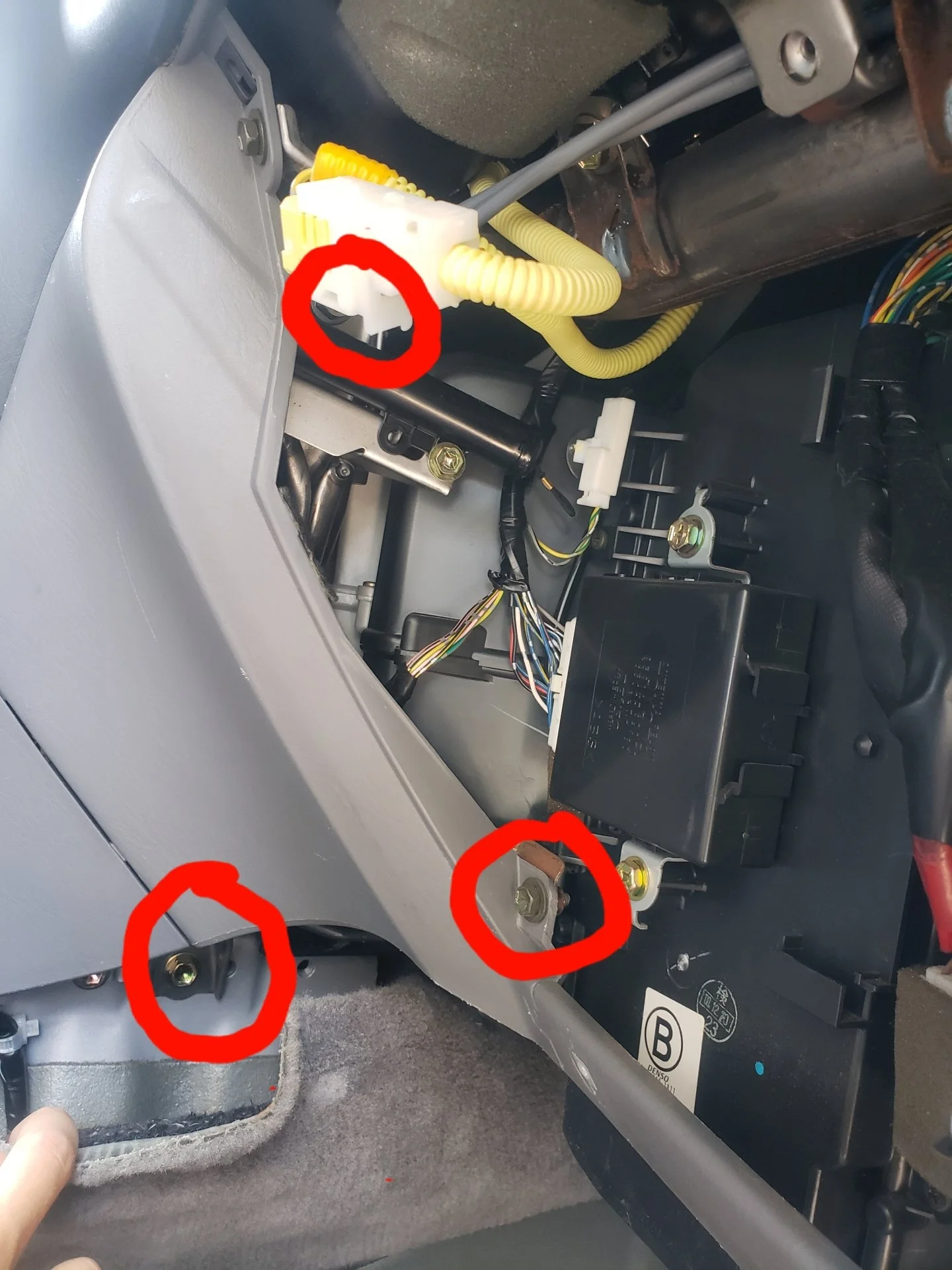

How did you get this out I remember trying to do this to replace the glove box dampener and I couldn't reach the other bolt or nut. It was so far in there i couldnt even see it.
Biga - check out this video around the 1:15 mark. It is a right hand drive model but ours are the exact same mirrored.
There is one obvious bolt at the lower left end of the glove box, one nut next to the dampener, and then tug the carpet back next to the center console to expose the third bolt/fastener. Once they are out, make sure you slide the top of the metal brace off of its stud (since it was a nut the other two were bolts) and the the metal brace slides out the glove box opening - should not have to force anything.
Two bolts and one nut (sorry, the nut at the top is partially obscured here by the yellow cable connector in this photo)
Thank you so much me and a couple other members were always looking for this info. I never knew about the bolt near the center console thank you so much. This should be its own thread.

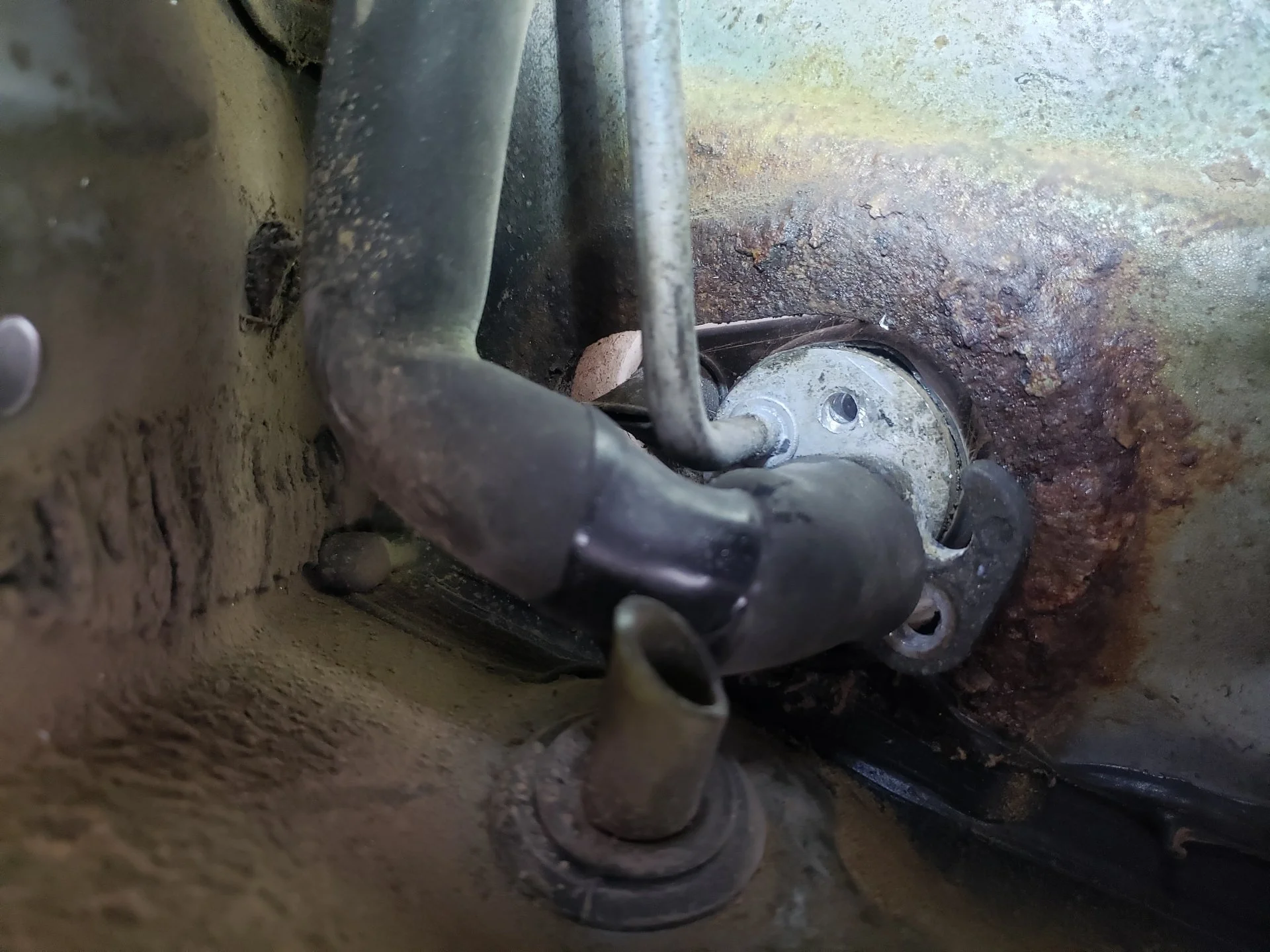

Does anyone have advice on how to prevent premature wear at the clamps going forward? I see one service center out there in the Midwest who says they put a small section of anti-seize then wrap it in tape to prevent the grime from wearing away the pipes at the attachment points. Any thoughts or experience out there on that one?
are you talking about the black plastic clamps that hold the High and Low ports in place near the firewall? I made sure I didn't wreck those when I took them off.
PITA figuring out how to get em off. Seemed to click back on and do the job. Hope I didn't miss something when I reassembled them.

Highkick05, thankfully those clips came off with the bobbypin / paperclip tool and clicked back on for me.
What I am wondering is long term how to reduce the wear of the grit in the rubber mounting sleeves in key points down the length of the rear line. Almost every one I opened up had traces of either pinhole leaks, or wear that was well on its way to creating pinhole leaks. Reading comments from others, that is why I decided to replace both of my high pressure lines running underneath the body, each of those points is suspect and learning from others, I could spend a long time chasing down individual leaks. I can only assume the grit that gathers in them acts as an abrasive and wears through the lines.
What can we do to reduce that wear? Or just accept it and replace the lines every 10-20 years?
One shop posted their fix online where they put a thin layer of anti-seize and then wrapped a short piece of electrical tape to add a 'wear layer' to the the line. Curious if anyone else has taken similar steps.
FYI - I ordered my rear high pressure lines (88726-60630 and 88726-60650) along with several of the support brackets that were in the worst shape today. The dealer had higher prices, but compared to the $100+ shipping online for these long pieces, I actually ended up going through the dealer for price and turnaround time. Cruiserparts, McGeorge & others do carry them as well.
