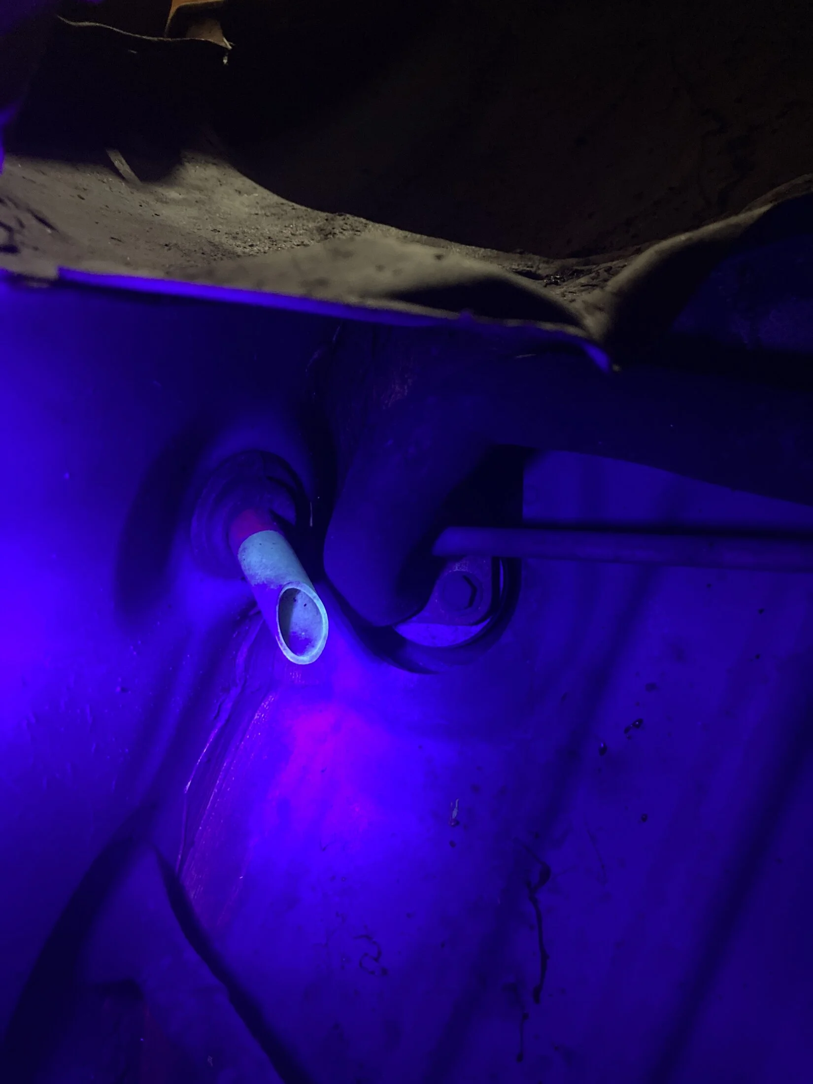

@MTrun yep, snapped the head right off that bolt. Will attempt to drill it out like you did with the 13/16 drill bit. If you have any other advice on that part, lemme know.
Don't despair! I doubt many of those aluminum on aluminum bolts exposed to the elements stand a change of coming out in one piece. If you look closely at the second picture in post #31, you will see that the bolt does not actually 'hold' the high pressure line in place -- it is the rotating diamond shaped piece that does that -- the bolt just keeps the diamond shaped piece from rotating. Meaning: this gives you a little wiggle room if there is a mistake, need to change bolt size or need to helicoil etc.
Take your time, go slow and keep the drill at a carefully held right angle. I chose to go with a small diameter pilot hold first making sure I was as centered as I could get. Pause, every so often, back out the drill and ensure you are tracking center, especially on the large drill bit. If you need to correct you can -- again it is not a high strength bolt under tension, if you lose a few threads you just need to maintain enough threads to securely engage. I was amazed how much corrosion was around the threads on my bolt, it actually gave a bit of a buffer between the male and female threads with the white chalky crap.
After you drill it out -- or at least some of it, you can rotate the diamond shaped plate that holds the end of the line in place, and then just pull down on the end of the line to remove it.

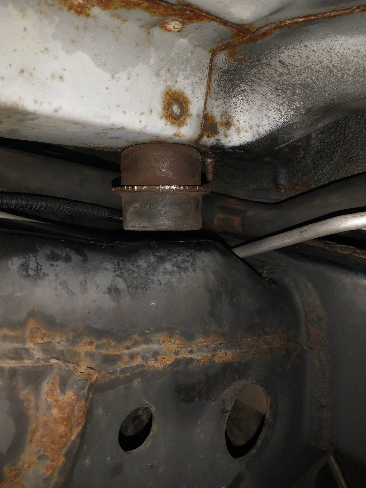

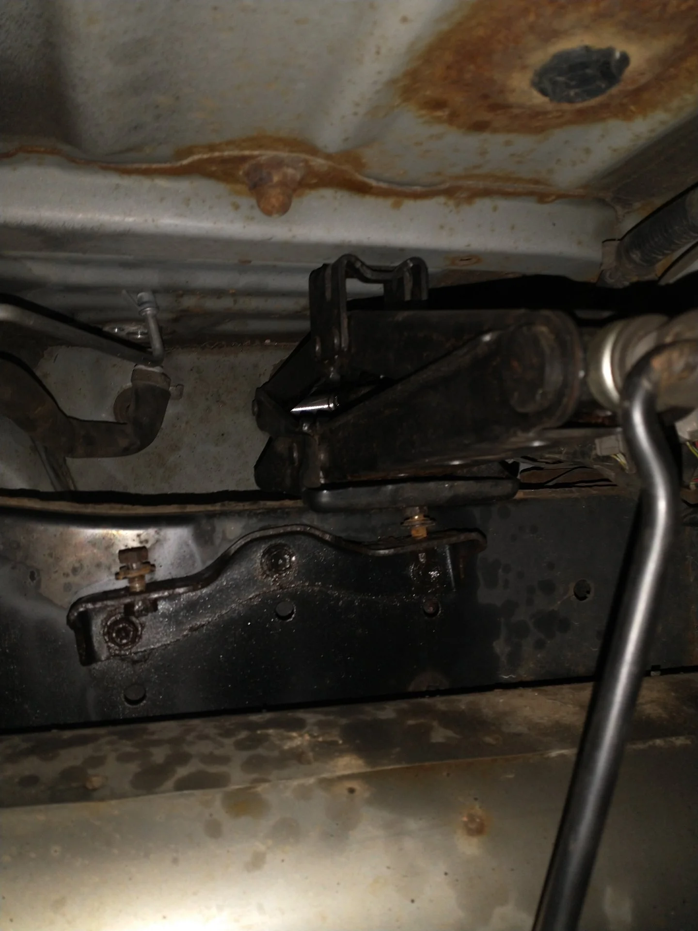

Quick update. After studying the undercarriage this is what I did (note this only applies to the small diameter high pressure tube in the rear most portion).
Step one: removed the wheel carrier (I have a swing out...so wasted weight!)
Step two: use a Toyota scissor jack (used the wife's sienna jack) and Jack up the body from the frame...just a little bit.
Step three: after feeding the front portion of tube as far as possible from the rear...slide the right angle portion under the body mount that you just increased the gap by jacking up the frame.
This took me 5 minutes... probably won't work on the larger diameter suction line...but works for the smaller diameter line. Have cold air for now...will check for leaks. Some pics attached.

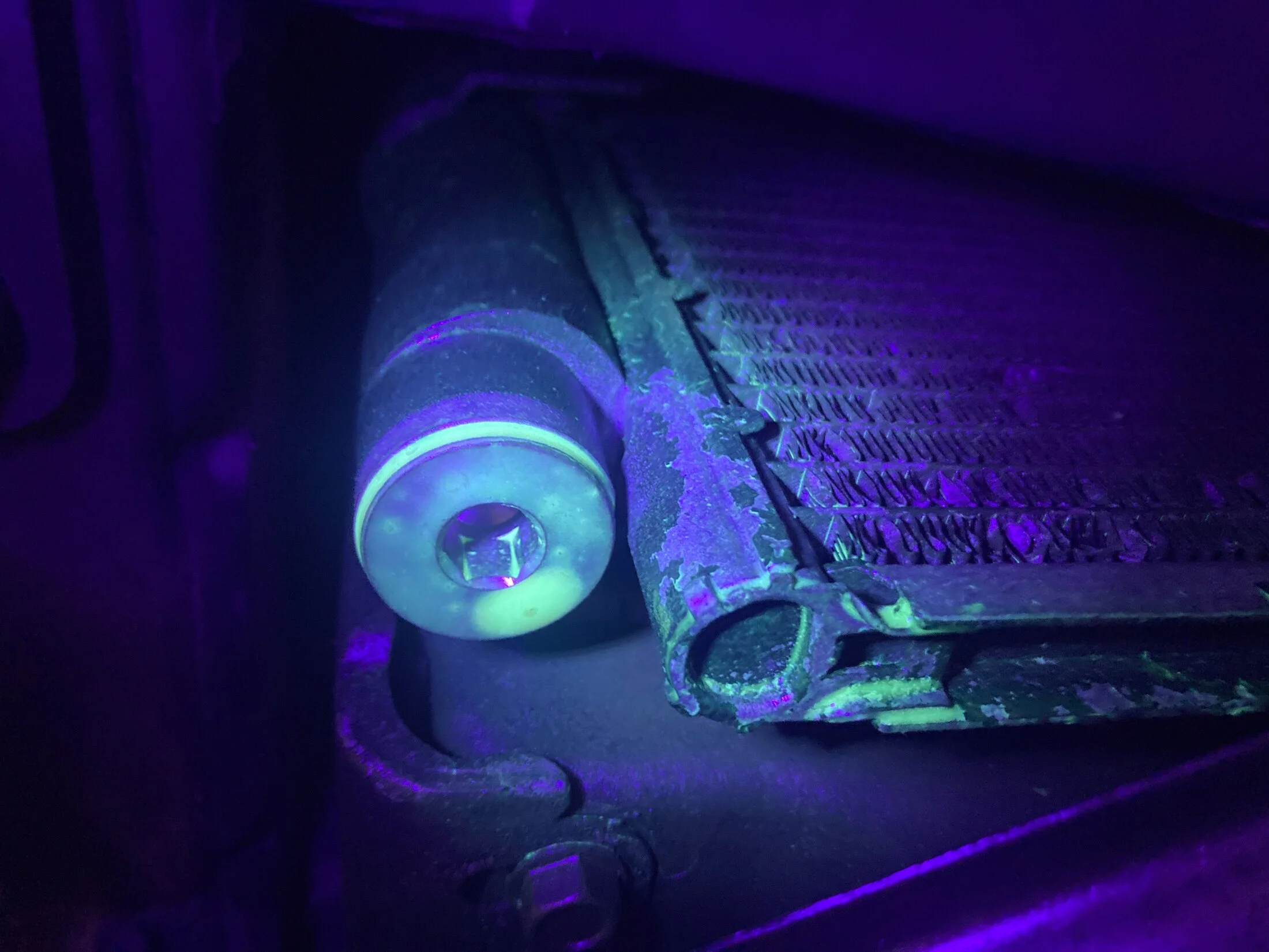

Finally narrowed down a couple locations my system is leaking. I think these are the only two spots:
Right at the outlet of the compressor, seems to be a leak at the joint of the hard line and soft line on the hard line side of the joint
The connection of the line that feeds into the condenser looks way worse, I'm going to try o-rings here first
After evacuating the system, will I need to add any oil back in if I am not replacing the compressor, condenser, evaporator, or anything but hard lines and o-rings?
Bonus pic of the front of the compressor that leads me to believe it's not a source of leak:

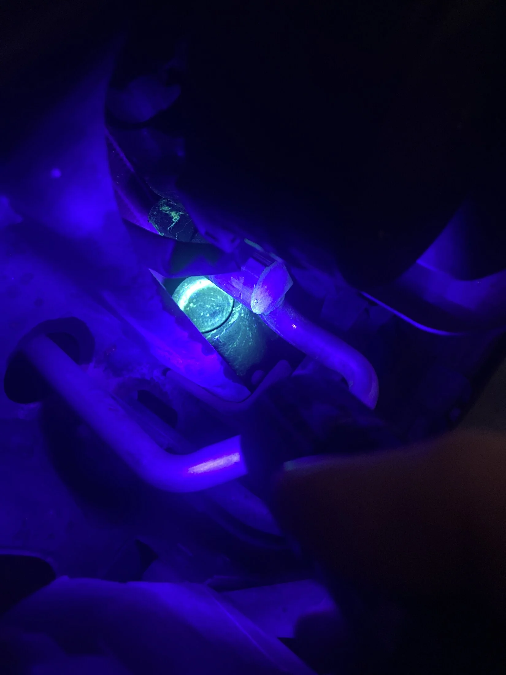

I broke out the UV flashlight and saw this:
