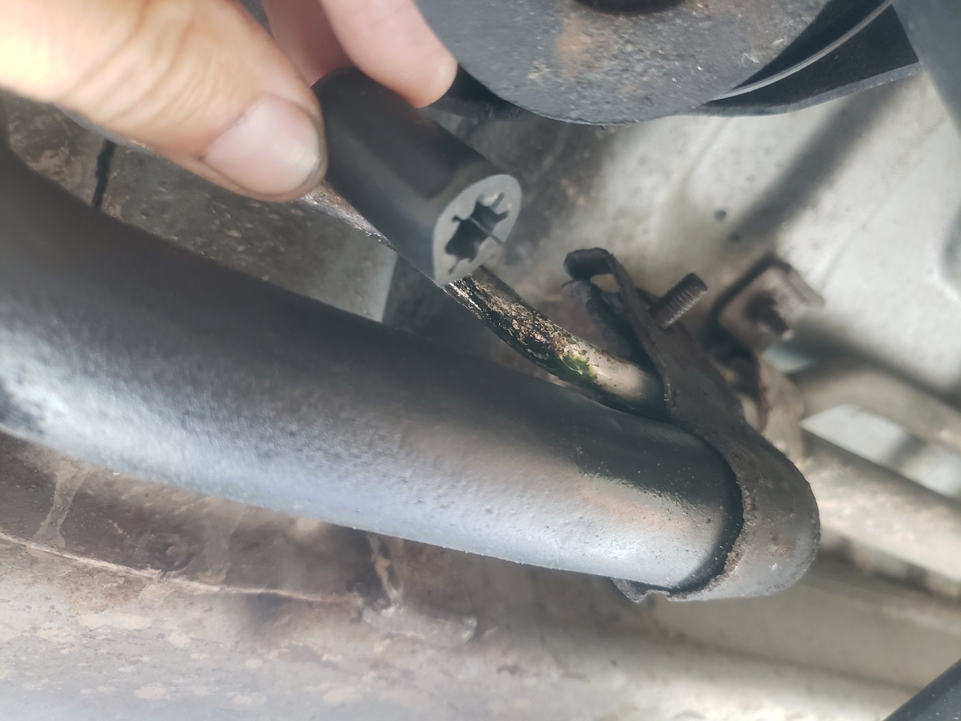

Highkick05, thankfully those clips came off with the bobbypin / paperclip tool and clicked back on for me.
What I am wondering is long term how to reduce the wear of the grit in the rubber mounting sleeves in key points down the length of the rear line. Almost every one I opened up had traces of either pinhole leaks, or wear that was well on its way to creating pinhole leaks. Reading comments from others, that is why I decided to replace both of my high pressure lines running underneath the body, each of those points is suspect and learning from others, I could spend a long time chasing down individual leaks. I can only assume the grit that gathers in them acts as an abrasive and wears through the lines.
What can we do to reduce that wear? Or just accept it and replace the lines every 10-20 years?
One shop posted their fix online where they put a thin layer of anti-seize and then wrapped a short piece of electrical tape to add a 'wear layer' to the the line. Curious if anyone else has taken similar steps.
FYI - I ordered my rear high pressure lines (88726-60630 and 88726-60650) along with several of the support brackets that were in the worst shape today. The dealer had higher prices, but compared to the $100+ shipping online for these long pieces, I actually ended up going through the dealer for price and turnaround time. Cruiserparts, McGeorge & others do carry them as well.
Interesting , I had a feeling you were talking about something back there. I didn't have rear A/C in mine. They must be pretty hard plastic then by the looks.
Not hard to imagine they would start wearing into the pipe. What do they use under the bonnet? Something better? those lines seem pretty faultless.
All I can think of is perhaps some fine hole foam layered inside the clamp. Or yeah leave them off and wrap it several times around with some really good quality tape, after a good clean of the underlying surface first. leaving the bracket on obviously. You think the bracket alone would hold it there.
