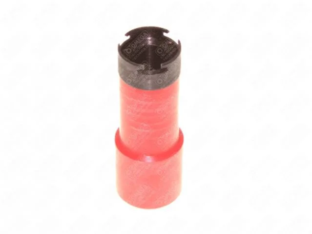

You might want to consider getting these also. They make the job easier and less chance of ruining the new seal. The first pic is a seal installer/remover, the second is a shaft seal protector.
Good Luck!
Rex

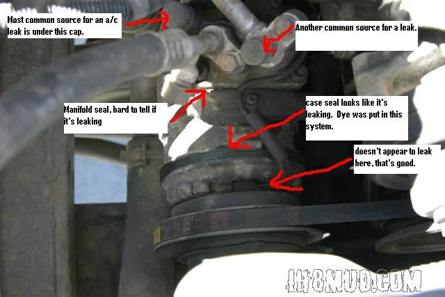

? Is the pic of my compressor the type of signs of the seals failing? Your can see the green moist discolor, all 3 of the joints look like that (front you can see in the pic, middle just about 2' up from there, and one towards the back).
I've owned the truck for 4yrs, last summer tho I had to refill.
Front and rear case seal and the manifold seal is all I can gather from the picture and your post. I forgot to point another arrow at the 2nd high side schrader valve. Since dye was introduced into your system, it will be a greenish black oily residue leading you to all your leaks, except for under the caps, they will be oily yellow/green.
Thank you for the clarification :D
