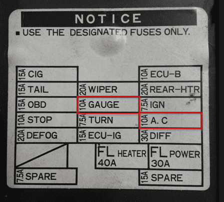

A similar thing happened to me the other day. I was driving home in the heat with a packed cruiser including kids when the a/c and dash gauges suddenly went out. I pulled over to check under the hood and didn't see anything obvious. I started it back up and the engine bay started smoking. I checked and the belt was melting at the a/c compressor clutch. I figured it died. I cut the belt off and drove home. Also I noticed the windows don't work.
I'm assuming I need to replace the two fuses in the cabin here as well as the a/c compressor or clutch (oh, and the belt I cut):
Question: With the compressor pigtail disconnected, am I ok to replace the fuses and drive it around until I replace the remaining parts?
Yep, totally related. Had the same thing happen last year on a 95+ day. It got me home, glad it wasn't a longer drive due to the heat. The AC clutch is tied into the dash gauge circuit. Decided that due to age and favorable pricing to just have the whole AC compressor clutch and all replaced.
Most likely your compressor locked up smoked the clutch which probably got cherry hot and melted the magnetic pack until it shorted and took out your fusible link and probably the gauge fuse. Or it was overcharged and smoked the clutch. When the clutch starts slipping your done if you don't catch it in time.
