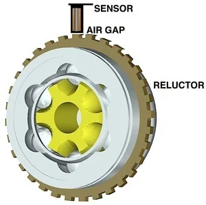

I had a similar issue years ago. My left front sensor was intermittently throwing a code.
I tried to replace the sensor and broke it trying to remove it, took the wheel off to do a full repack, replace seals and surprise. The seal behind the knuckle let mud in and the surface where the sensor reads was caked in mud.
I would check that first at it threw codes exactly as you describe with yours, low speeds, turning and intermittent.
The gap between teeth's where full off mud
