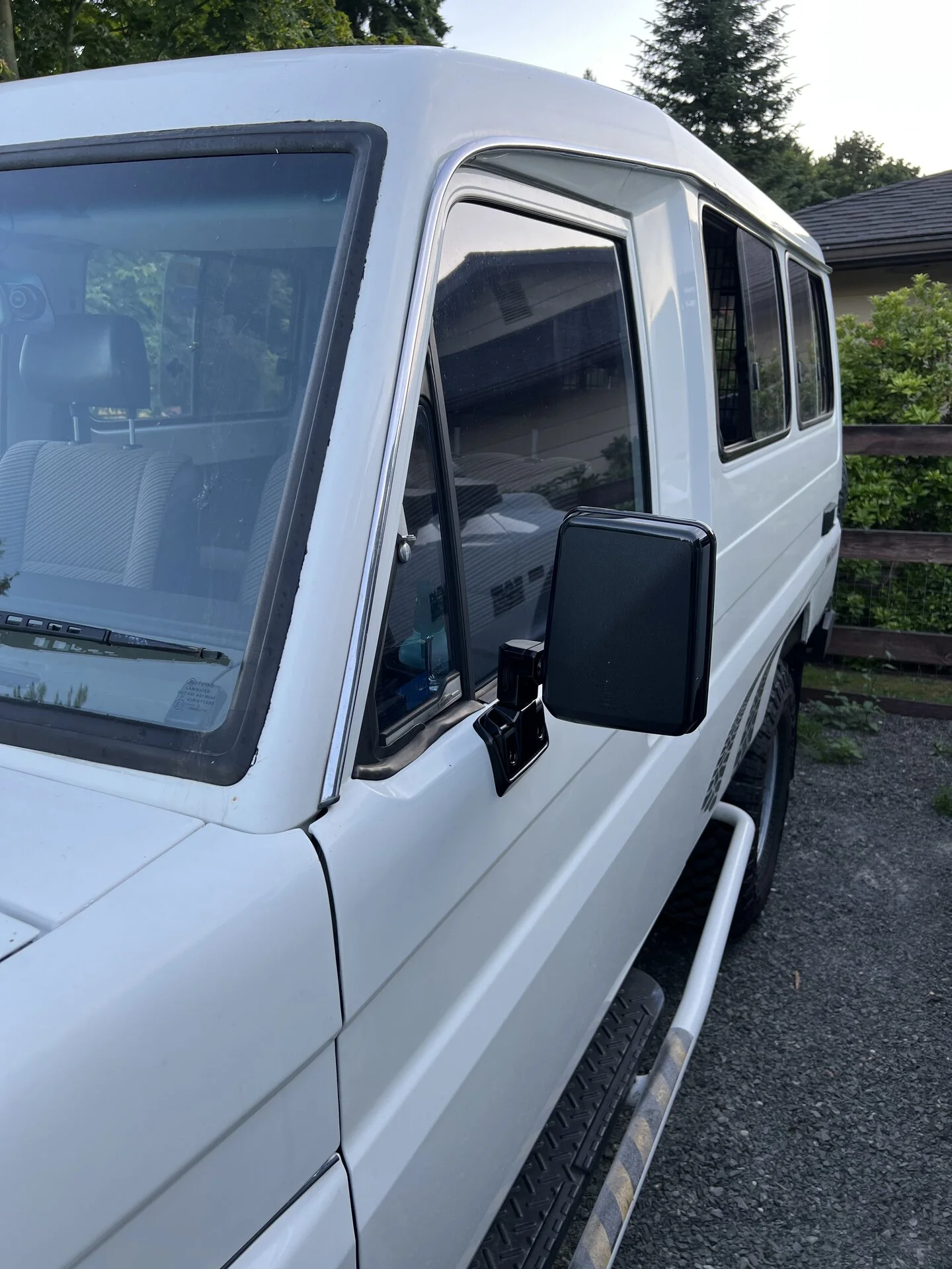

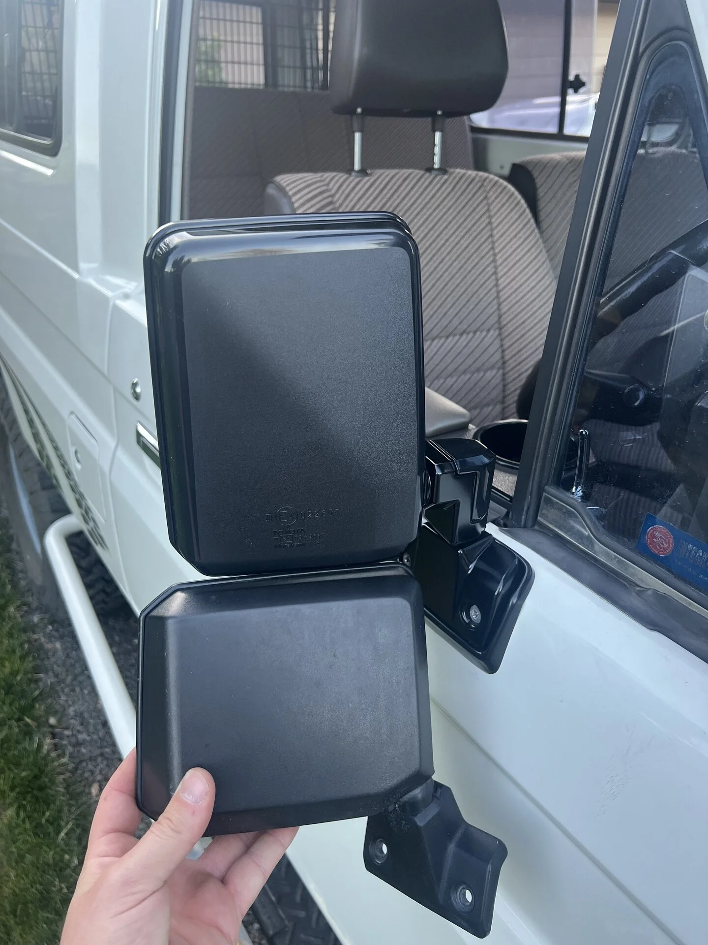

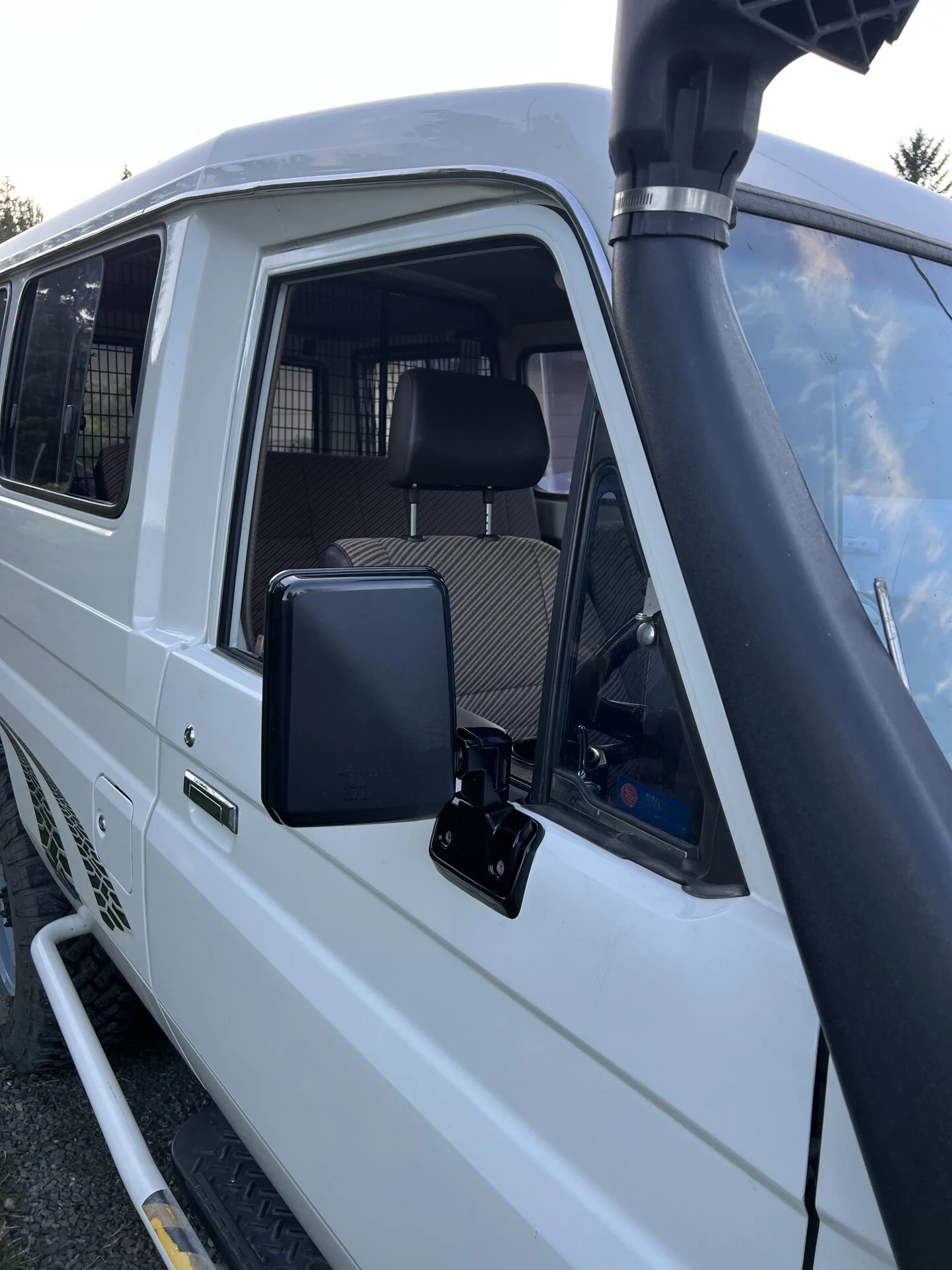

OEM mirrors added. They are taller and certainly have a wider field of view than the aftermarket ones taken off.

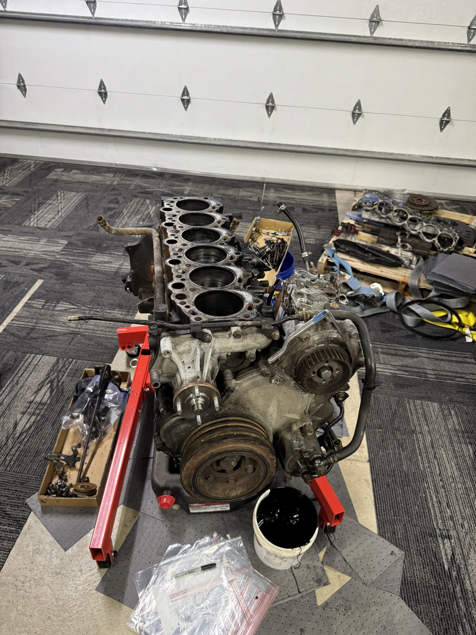

Bringing some life to this thread! The Troopy has been sitting for the better part of 8 months due to low compression and being hard to start, so I started getting a plan together for a rebuild. Step 1 of getting the motor out is done, and we’ll start tearing it down this weekend to see what we find before it goes to the machine shop.

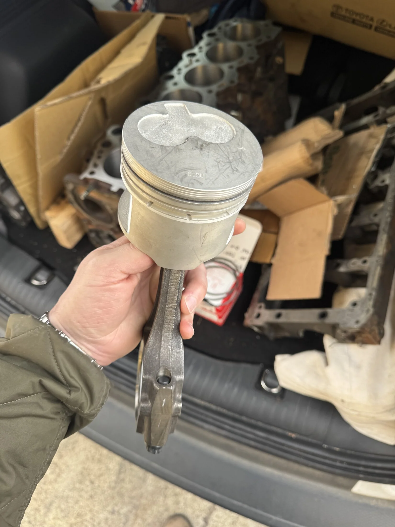

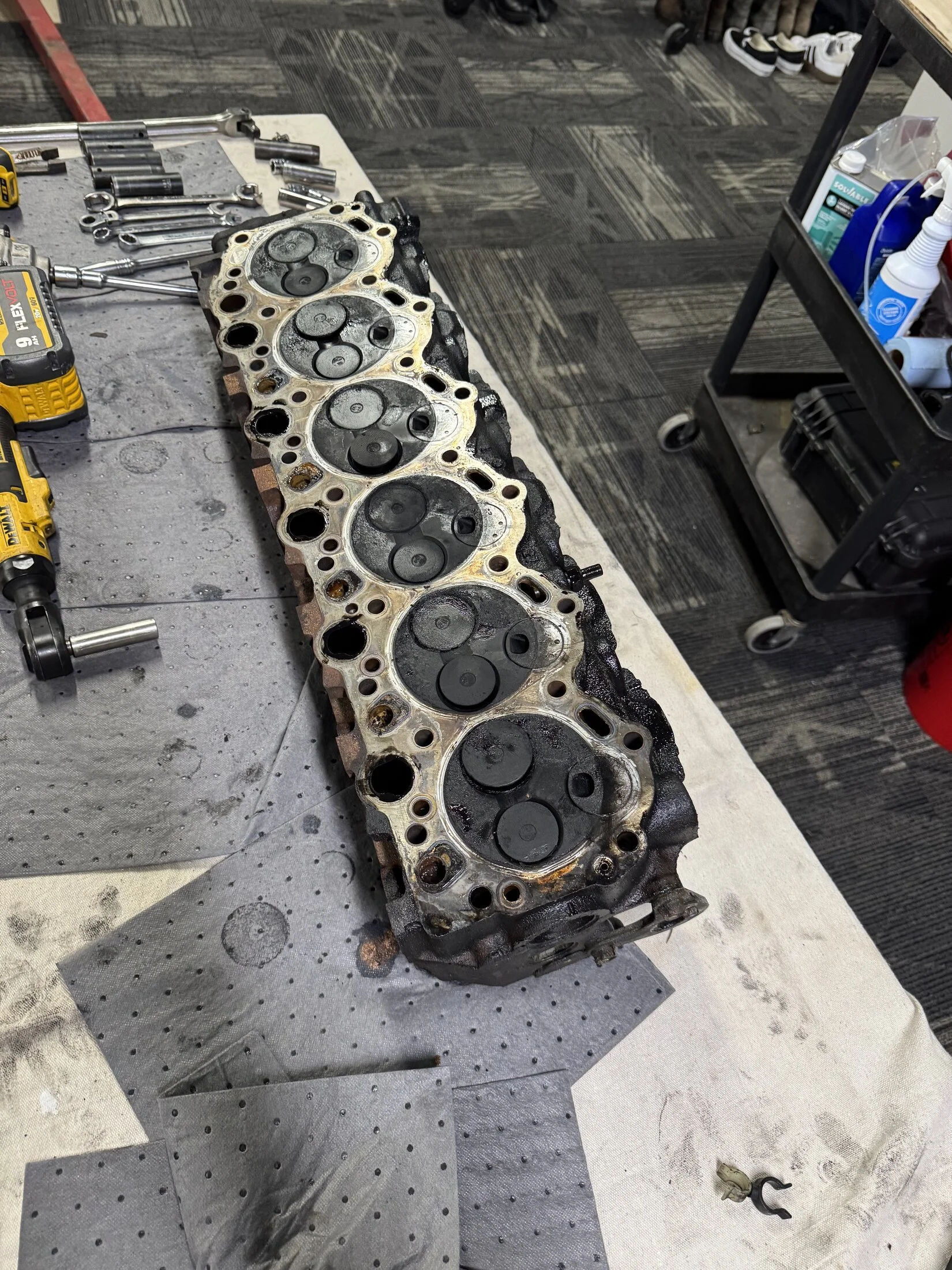

Got the block completely stripped and the head removed. Bottom end bearings and crank looked great. Each piston had multiple cracks near the ring seats. Each pre chamber had cracks as well. No visible cracks in the head but we’ll see what the machine shop says!

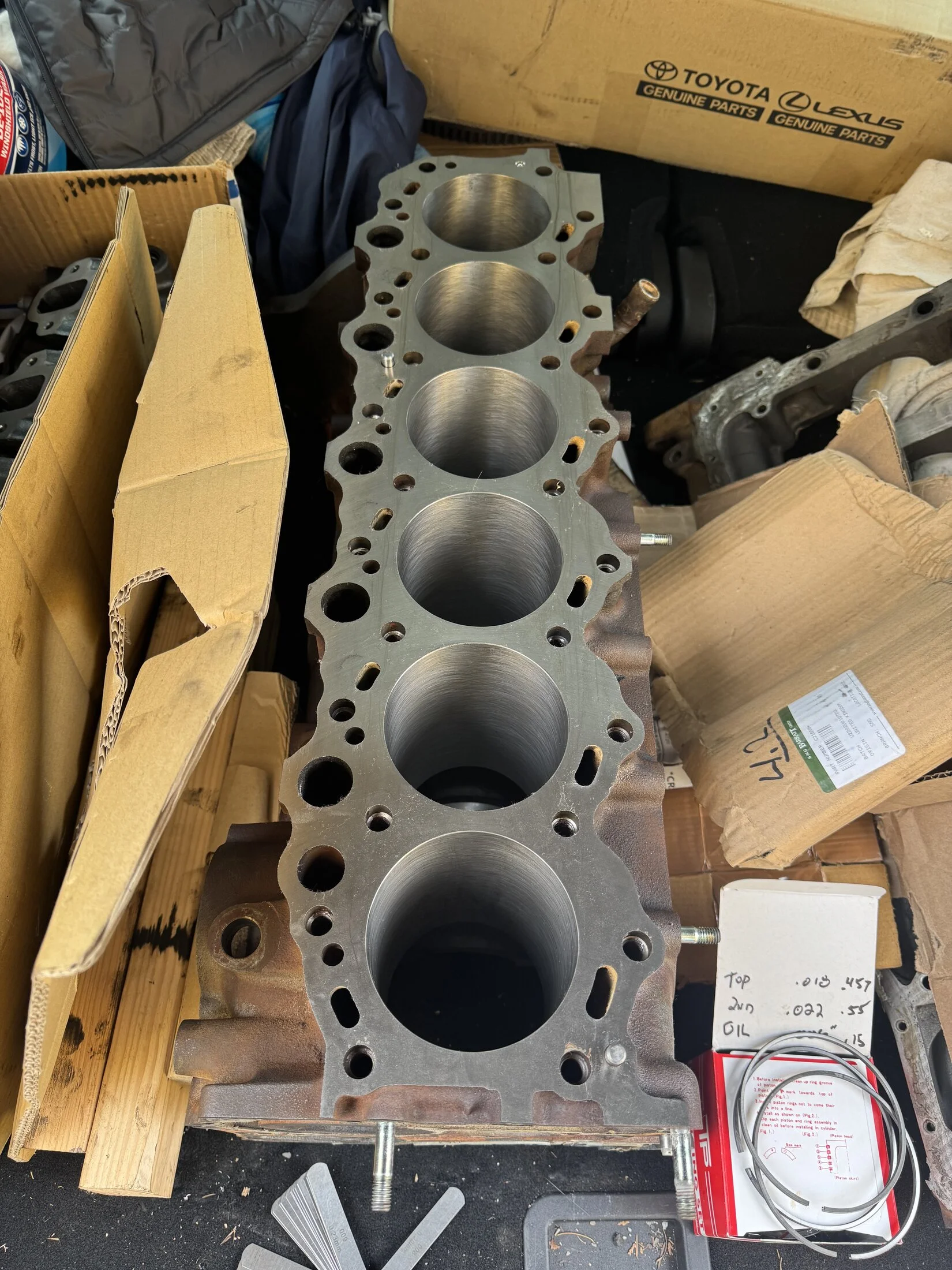

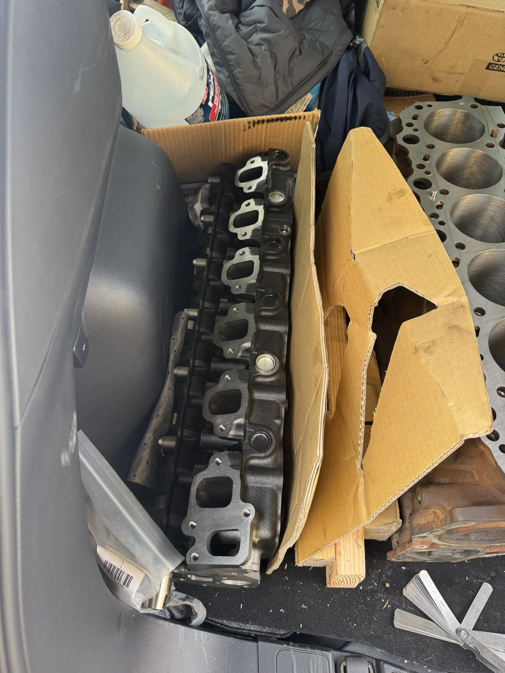

Dropped all the parts off to the machine shop Monday, and by the end of the day we decided to go .5mm over on the pistons and rings. Ordered a mess of parts from Engines Australia and they’re scheduled to be delivered tomorrow. Quick turnaround!
Everything picked up from the machine shop. Need to do a deep cleaning and paint the block and head, then will start reassembly!
Maybe too late but personally I wouldn’t use engines Australia gaskets again. I would only use Toyota gaskets.
I rebuilt my 13bt using their kit and just about every gasket leaked/failed. I used OEM mls head gasket.

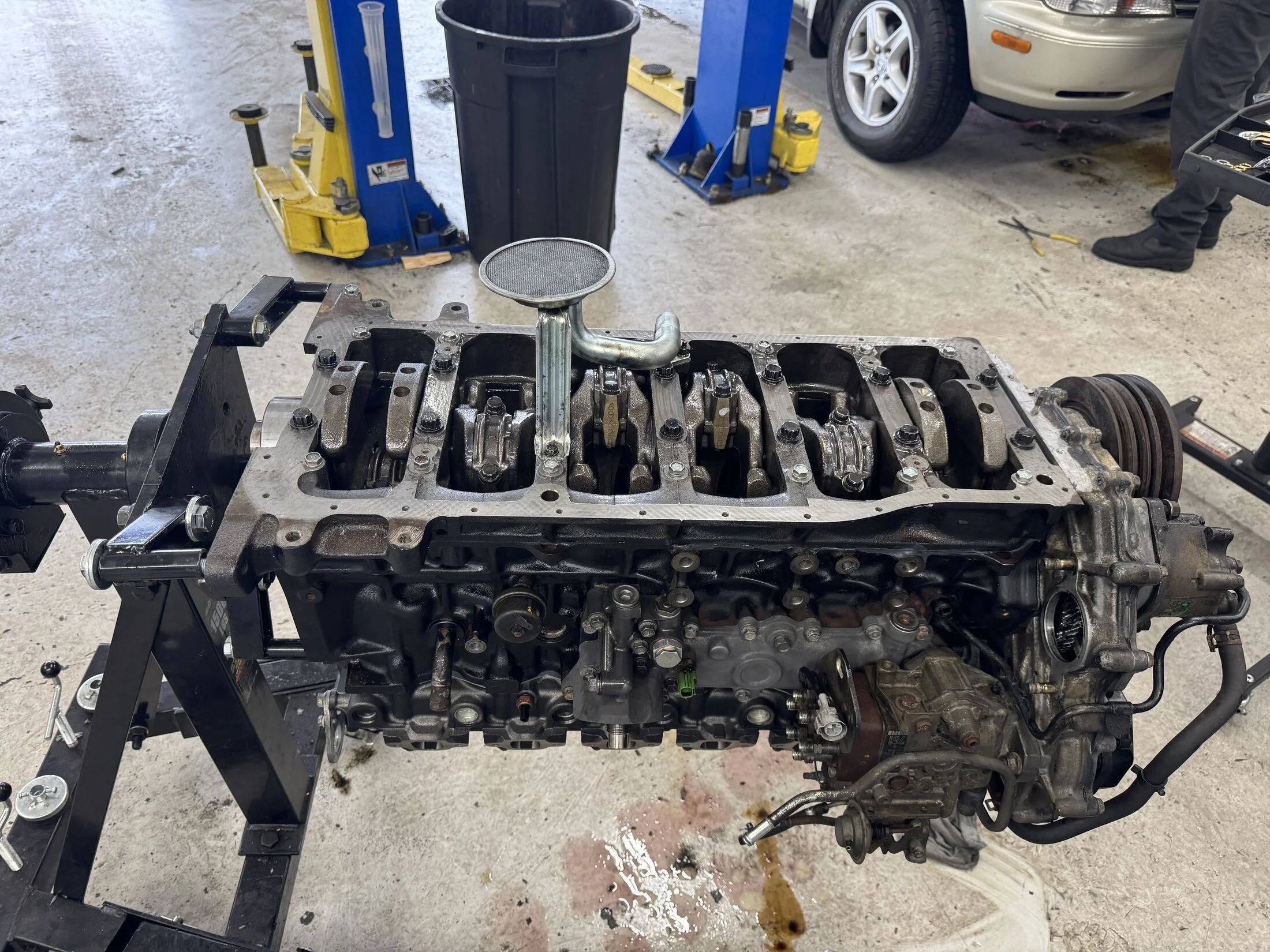

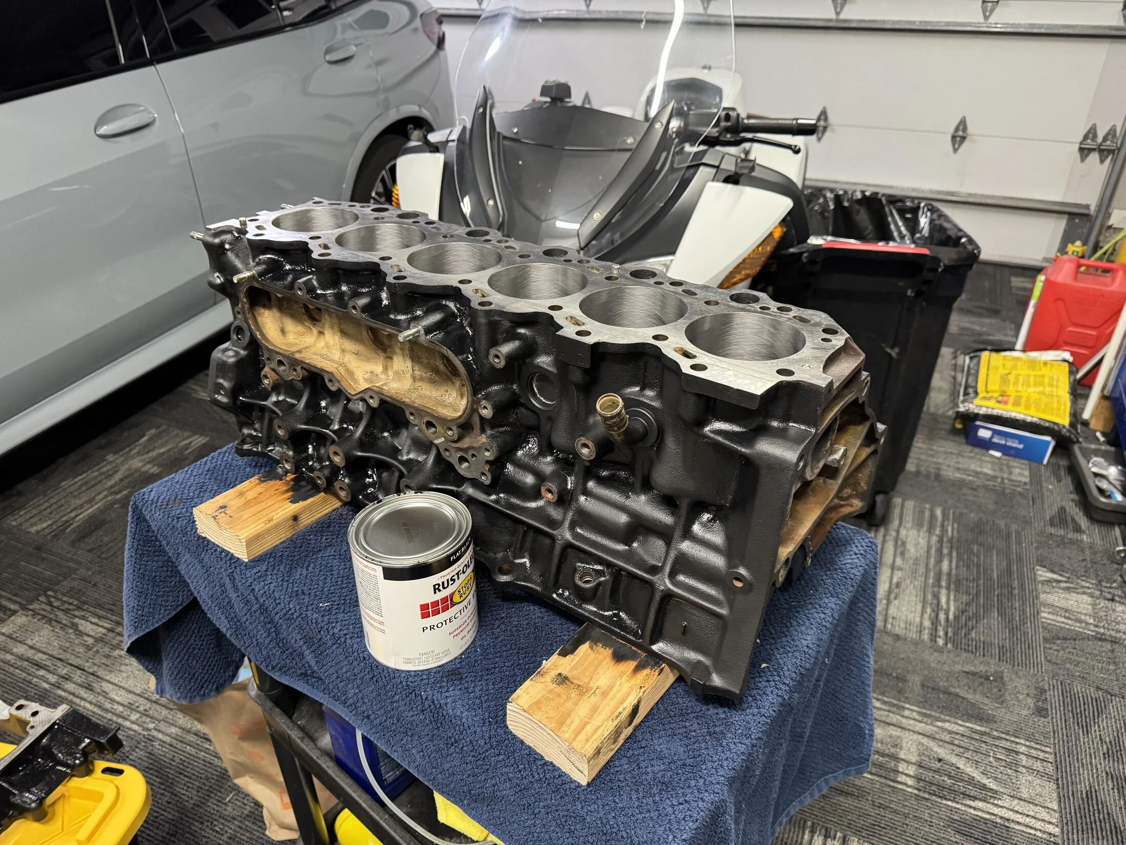

Block and bearing cap primed and painted. Need to do a deep clean of the block next.

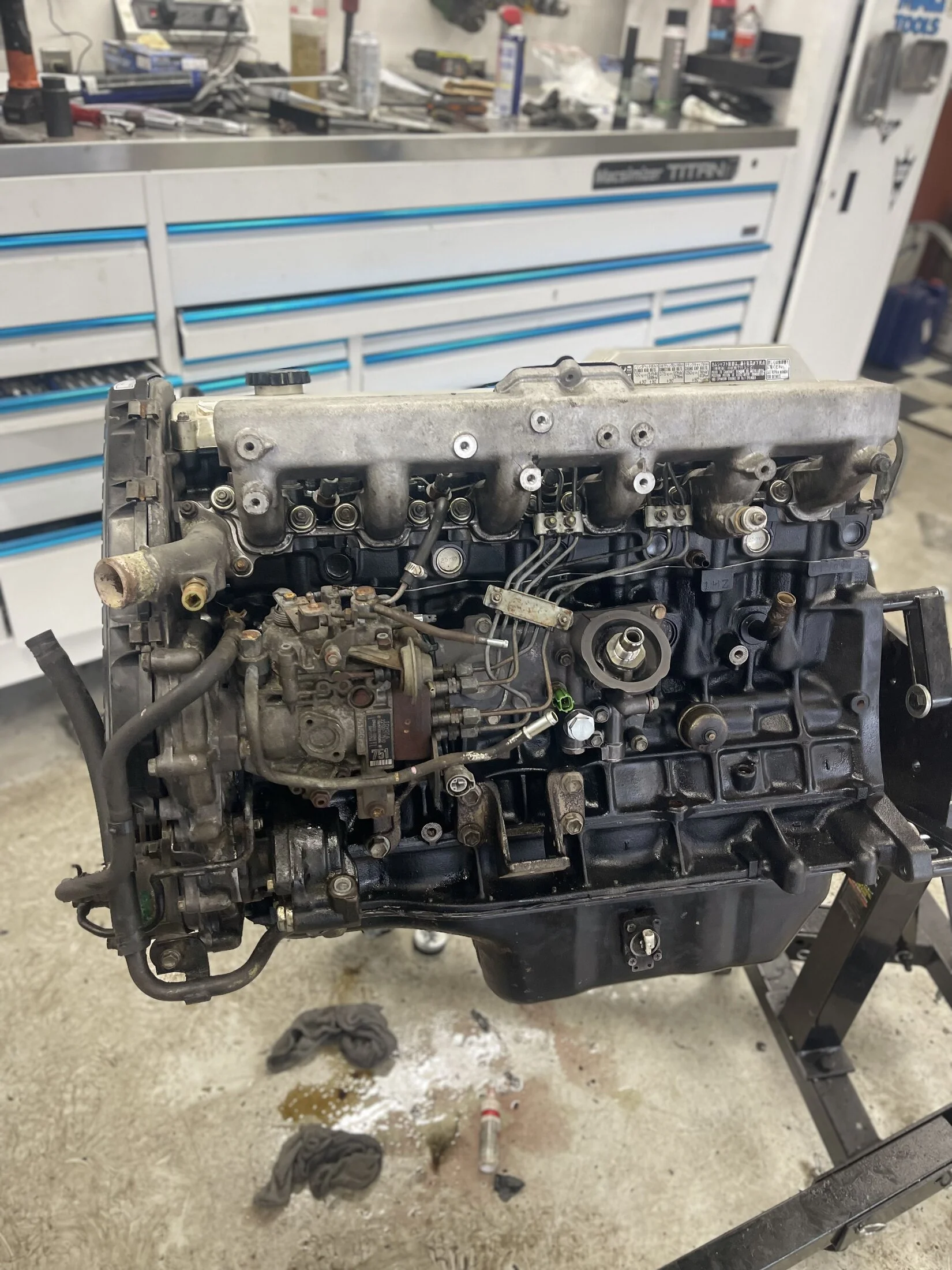

Motor is assembled and ready to go back in. A couple parts I wish I would have ordered ahead of time for aesthetics but nothing too difficult to swap down the road. Will be addressing getting the injection pump rebuilt when I decide whether or not we’re going the turbo route. This thing might have enough horsepower with full compression, we’ll see.

Replace that 13407-17010.

😂😂 yeah thinking the same thing. Compression was under 300 across the board so curious to see what she’s like now.
I’m only 1/2 or 3/4 serious. I would start without a turbo to get a baseline and break in going and dialed in.
Then decide if you want to go the turbo route and all its pros/cons.
I can’t imagine my BJ74 without a turbo…
Intercool if you turbo. Would not recommend otherwise.
