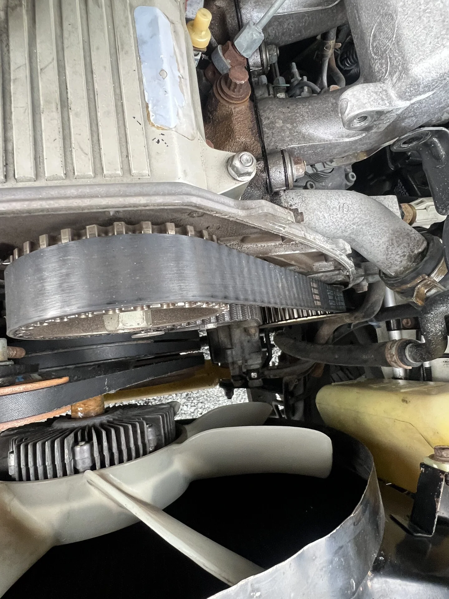

Appreciate it, it’s high on the list! Mine has a timing belt light. Does that come on when a sensor indicates it is worn or is it simply mileage based?Hey Jaco, very nice Troopy. I noted that there was no sticker on the engine showing when the timing belt was changed. The 1HZ is an interference engine. Can I suggest that absent iron-clad info on when the timing belt was changed that you pause and do that. Terrain Tamer makes a very nice all-in kit that includes a fresh metal impeller water pump, oil pump, timing belt and idler.
I've got a 1HZ 105 with the same mileage on it that obviously sat in the desert for years and various rubber bits are disintegrating. I have laid it up until I can get the critical timing belt replacement done. Same situation, no tag and no information on the last timing belt change.

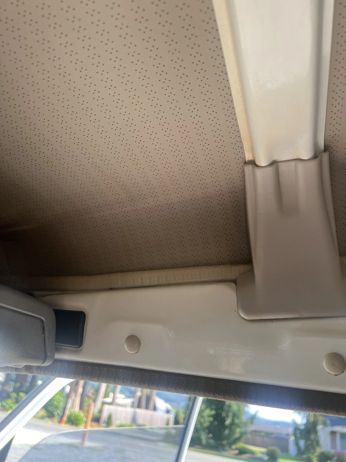

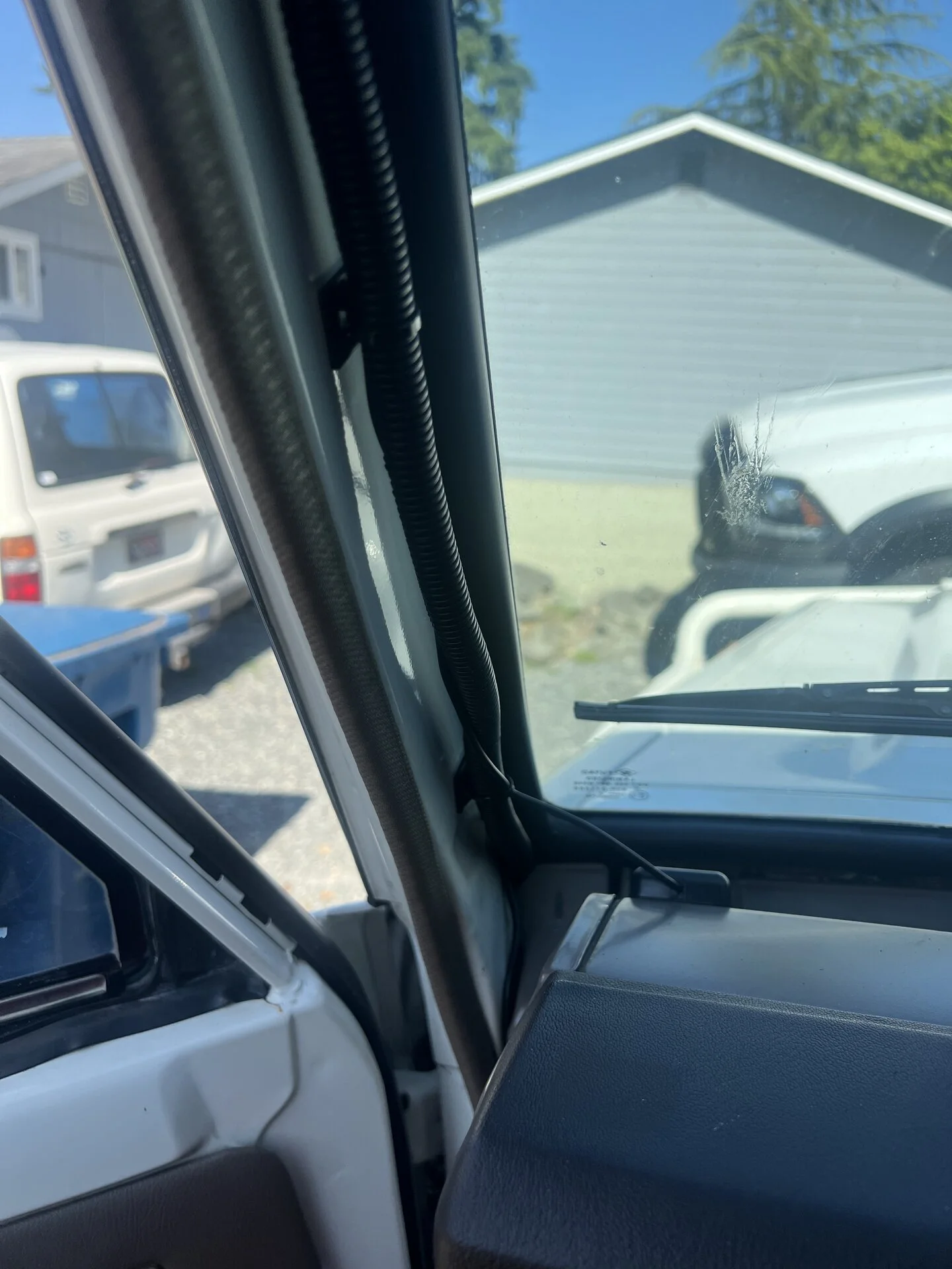

Sure! I was lucky to get mine with the overhead shelf as that helps tidy it up a lot. Backup camera wire goes from the mirror and up into the storage shelf, then I tucked the wire into the channel along the ceiling then simply out the back door opening (blue painters tape in the pic has since been replaced with black duct tape haha). The GPS wire and power cable are ran with loom on the left side of the windshield. GPS sensor is stuck on the dash, and power cable is ram under the dash and to the cigarette plug for now until I hard wire it.Your troopy goes fast enough you need to worry about your speed?!
Can you share how you routed/wired this up? I've got a similar mod to install on mine.
There is nothing active about that little light. Assuming that it's working which you need to be a little bit suspicious of, it's trivial to reset. And a seller might very well have just reset the light without doing the work.Appreciate it, it’s high on the list! Mine has a timing belt light. Does that come on when a sensor indicates it is worn or is it simply mileage based?
