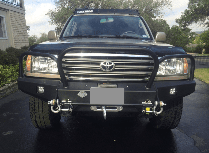

We decided to add a front bumper and winch, so we had Mike at Bump it Offroad adapt his terrific new 100 Series bumper for that purpose. Here's a pic. The horizontal bar just above the winch hook is from my original tow bar setup. Mike attached that mounting hardware to the face of the bumper, and he added the wiring harness connection to the left of the license plate. Looks great and tows perfectly.

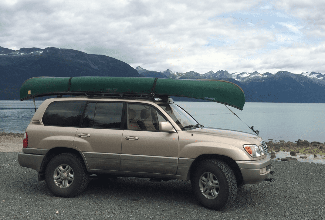

Here's a towing update. We've towed the LX from San Antonio to Alaska behind the RV over the past several weeks without a single problem. No doubt, these things can be towed with all four tires on the ground. Here's a pic from Haines, AK yesterday.
