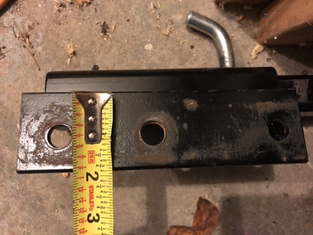

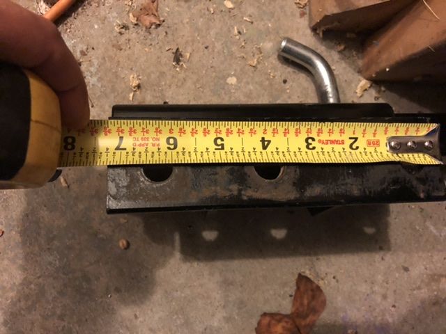

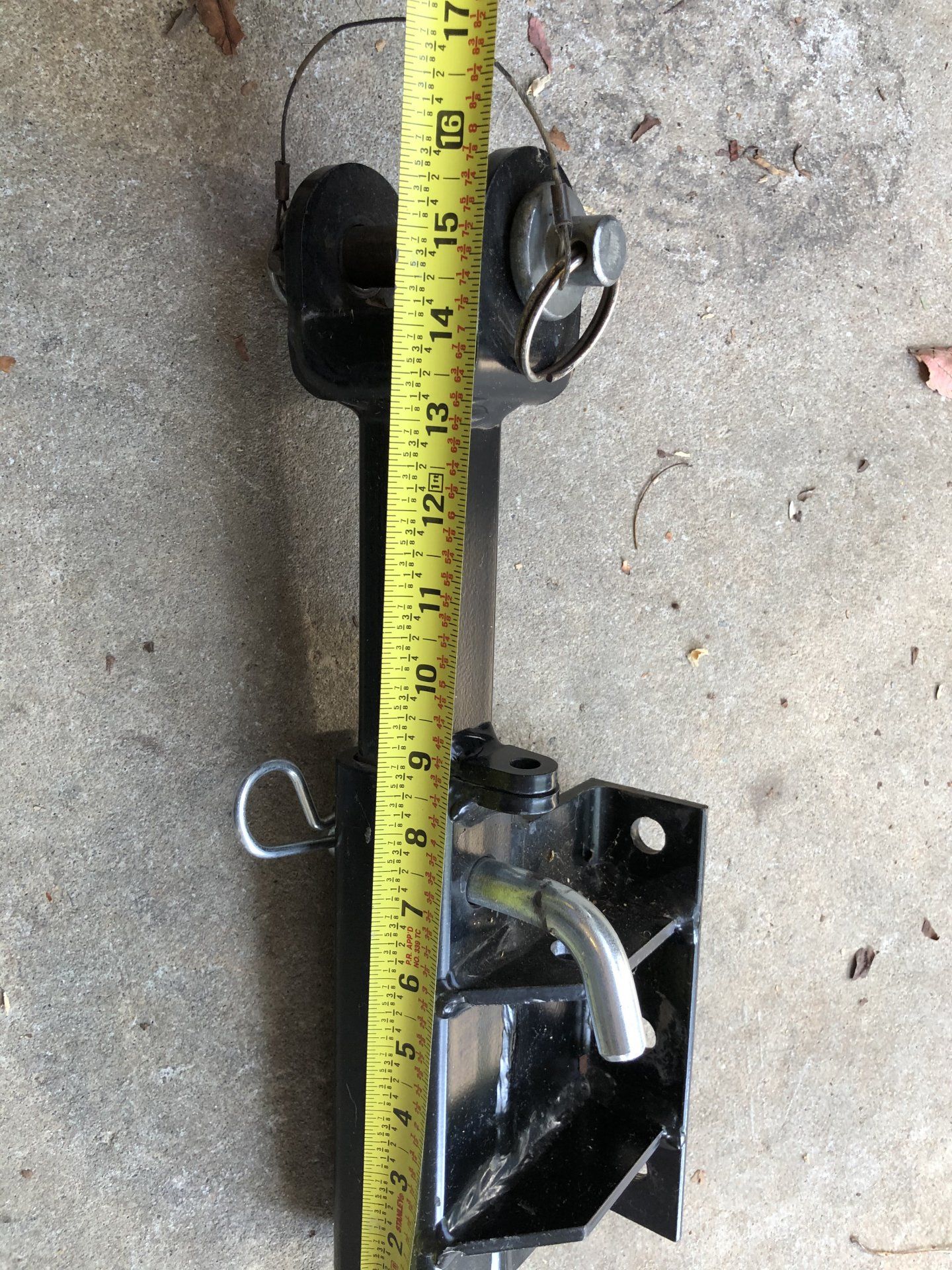

Yes I still have them. Happy to take measurement, are you looking for bolt hole spacing?
here are some measurements let me know if want anything else

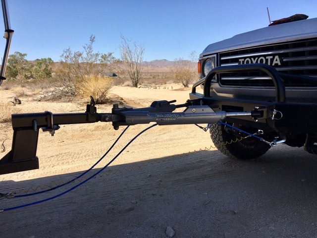

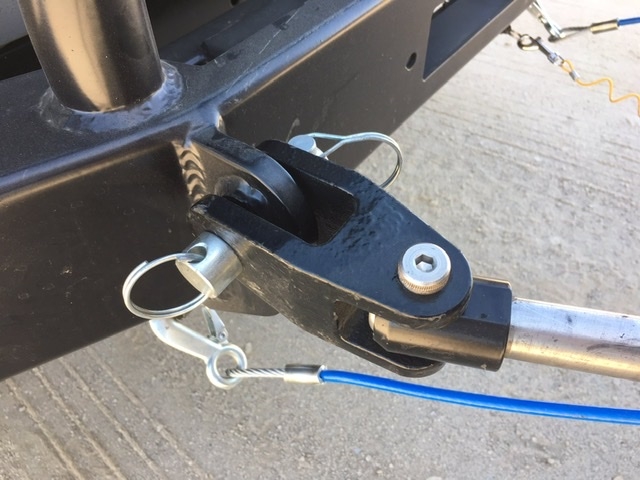

I flat towed a 60 series as well for a while with a 4 plus bumper and attached my tow bar to the mounting points.
worked great
here are some pics

What towbar and clevis did you use? Is that a surge?
Roadmaster Sterling towbar.
Believe I bought the attachment points (clevis) on e trailer. I still have the clevis’ if you are interested in them
