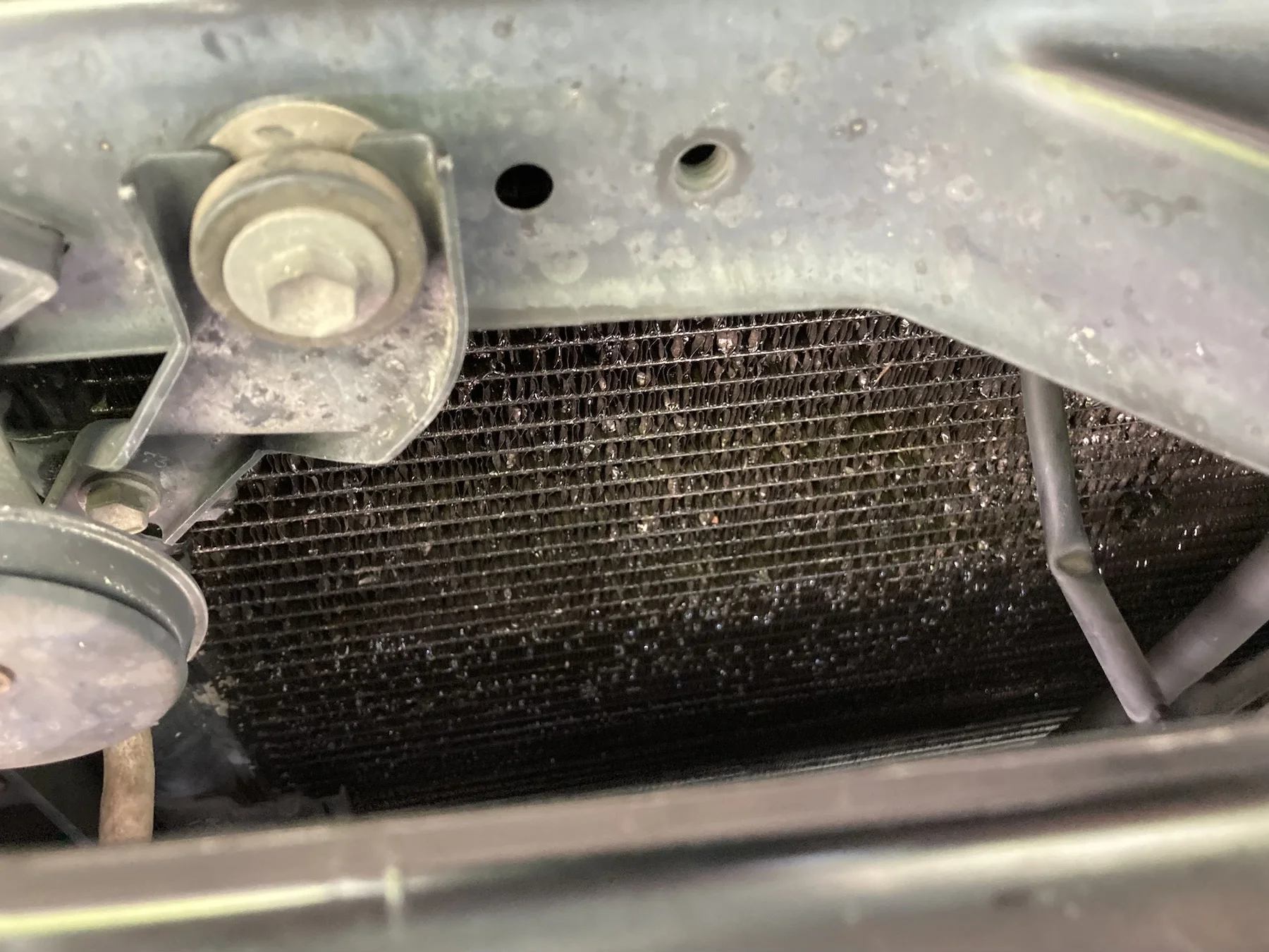

just ran a hose on the condenser with everything hooked up.
the high pressure reading went down down down into normal.
zeroing in.
and although this is a '98, it appears I'm missing something here in front of the gnarly ass condenser...
so if anybody wants to weigh in- I'm guessing new condenser & add fan back in?
