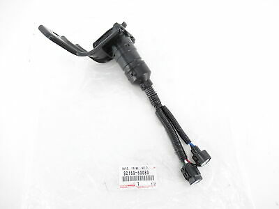

You can buy the part from Toyota and install it yourself.
The location is not obvious as it is under the bumper on the passenger side, not close to the hitch cover.

Imagine my surprise when my new to me 2017 LC didn't have a 7-pin. Actually found out it's on purpose because these vehicles are built for global markets, and not everyone uses a 7-pin.
The wiring is there, it's just the pigtail missing. $150 later on ebay....but at least the install was super simple, 2 screws, 2 plugs, and off we go.
