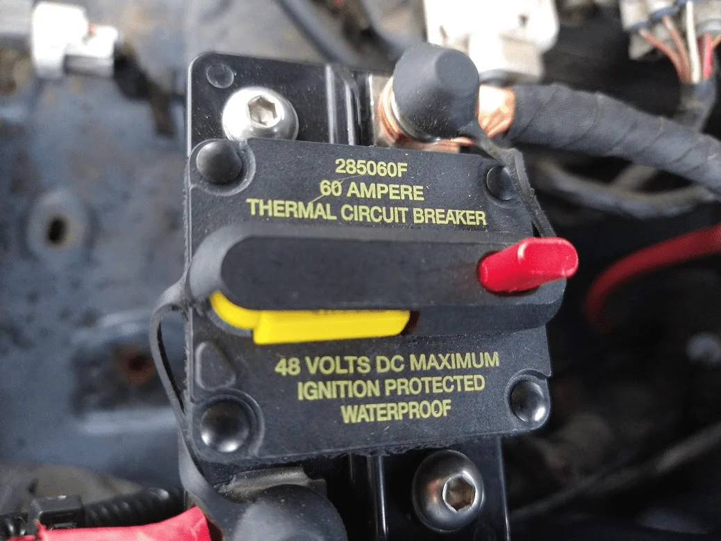

  • Blue Sea 60 amp circuit breaker in the engine compartment. In retrospect, I probably should have gone with no more than 40 amp as I never intend to run 60 amps through this.

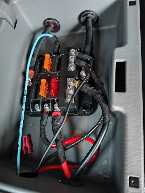

  • A no-name 6-gang fuse block with illuminated fuse indicator. When powered, if the fuse is good, the red light for that circuit is on. No fuse or blown fuse, no indicator. I do not like this fuse block simply because of the shape and the mess it makes of wiring, so I'm looking for a rectangular one now.

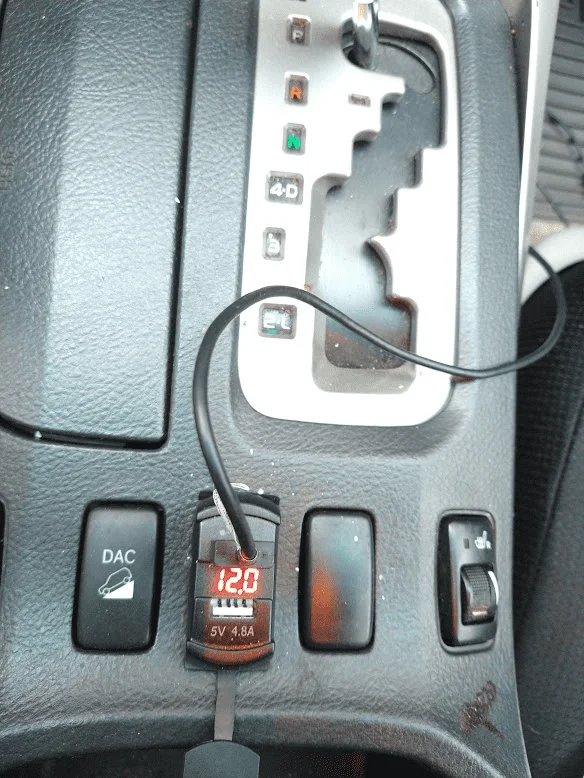

  • And while not related to this, I installed a dual USB QC outlet in a center console blank, reusing the cigarette lighter wiring (so ignition-on only). It has a battery level readout, which has proven to be rather accurate.
I wish to hell I could get the latte stain from the PO off the trim, but here's the center console outlet:
I found a little bracket in my pile o' s***, which fit some existing holes in the engine bay perfectly. Just had to drill 2 holes in the bracket to mount the breaker:

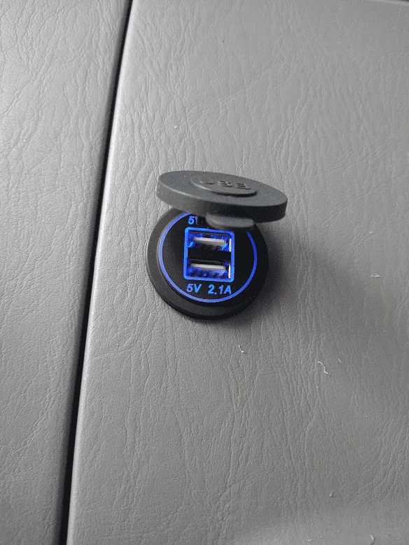

Cut a 1.25" hole in the driver's side rear cargo panel for a dual-USB outlet:

Being a s***ty picture-takerer, this is the little storage area above the driver rear wheel well where I put the fuse block. Not pretty, getting changed:
Nice work Joe. Run a 1/4 spacer between the interior trim and the fuse panel and route your wires underneath. That could easily help clean things up a bit if you can't find a replacement you like.
That's a great idea! and of course I'd not thought of it. Gonna try it before I buy another fuse box, thanks Ramon!
