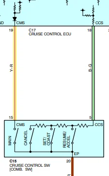

Found the cruise control switch in the electrical wiring diagram and it just shows these three wires going straight to the ECU with the same color throughout so identifying them in the steering column should hopefully be easy and I can just pin in a new connector. The tricky part will probably be making up a bracket.
(Note: I found this in the LX450 EWD found here. I cross referenced with a Landcruiser EWD to be sure the wires were the same. (that pdf wasn't as nice and looked like a scan or something) )

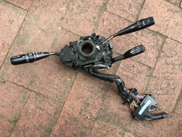

You should find a lot of useful info in my thread here where I retrofitted cruise control to a HZJ80:
I know for sure from my adventures doing this that what you want to do here is certainly possible. You also don't have to worry about fabricating a bracket, the factory cruise control switch that fits to the steering column screws directly onto the combination switch. The holes will already be there for it to attach on your rig, you just need the physical switch itself, and to wire it into your harness, which I talk about a bit in my thread. Be careful with wiring, because there are differences. Your rig has a combined signal line for three of the buttons on the stalk, but earlier year models have three separate lines for those wires, with different mappings on the main harness off the combination switch too. You need to know the year model you're getting the parts from and cross check them against your year model. I'd suggest referring to the following thread to get full accurate wiring diagrams for each individual US year model:

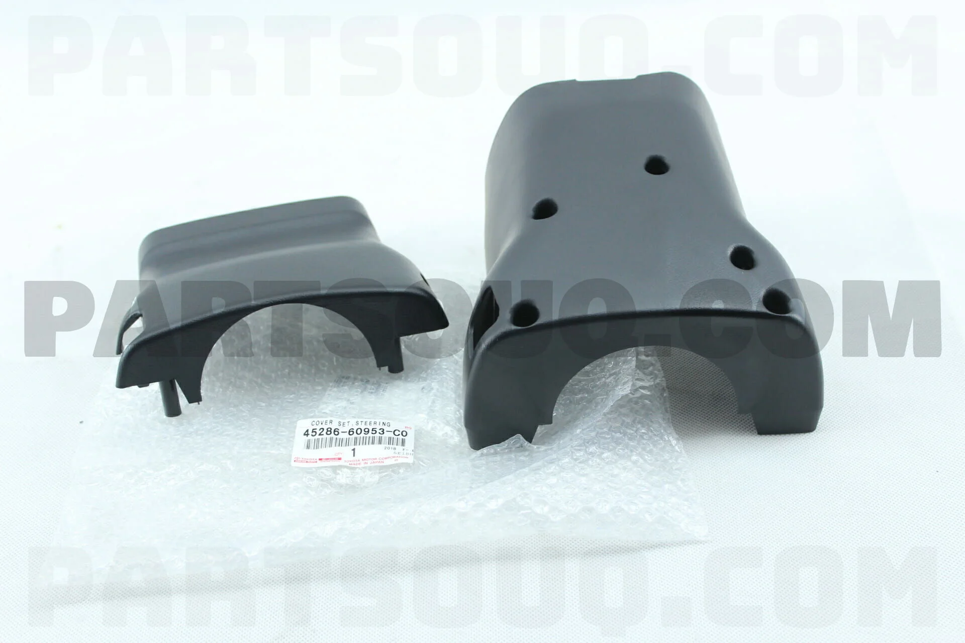

There is a good alternative to hacking a hole in your current late model cover though. Outside the US, there were late LHD models with cruise control, where airbags were optional. The cruise control ONLY moved to the wheel with the four spoke wheel design, which was ONLY used where airbags were fitted. What you need is this:
Still available brand new from Toyota, with the good plastic. For that matter, a good option for people with earlier US models too with cruise control fitted to the column. Note I don't expect this to be around long, so it's worth getting while it's available. The RHD version went NLA years ago.

That column cover would be perfect for me, I've seen that one before but that is an excellent price.
