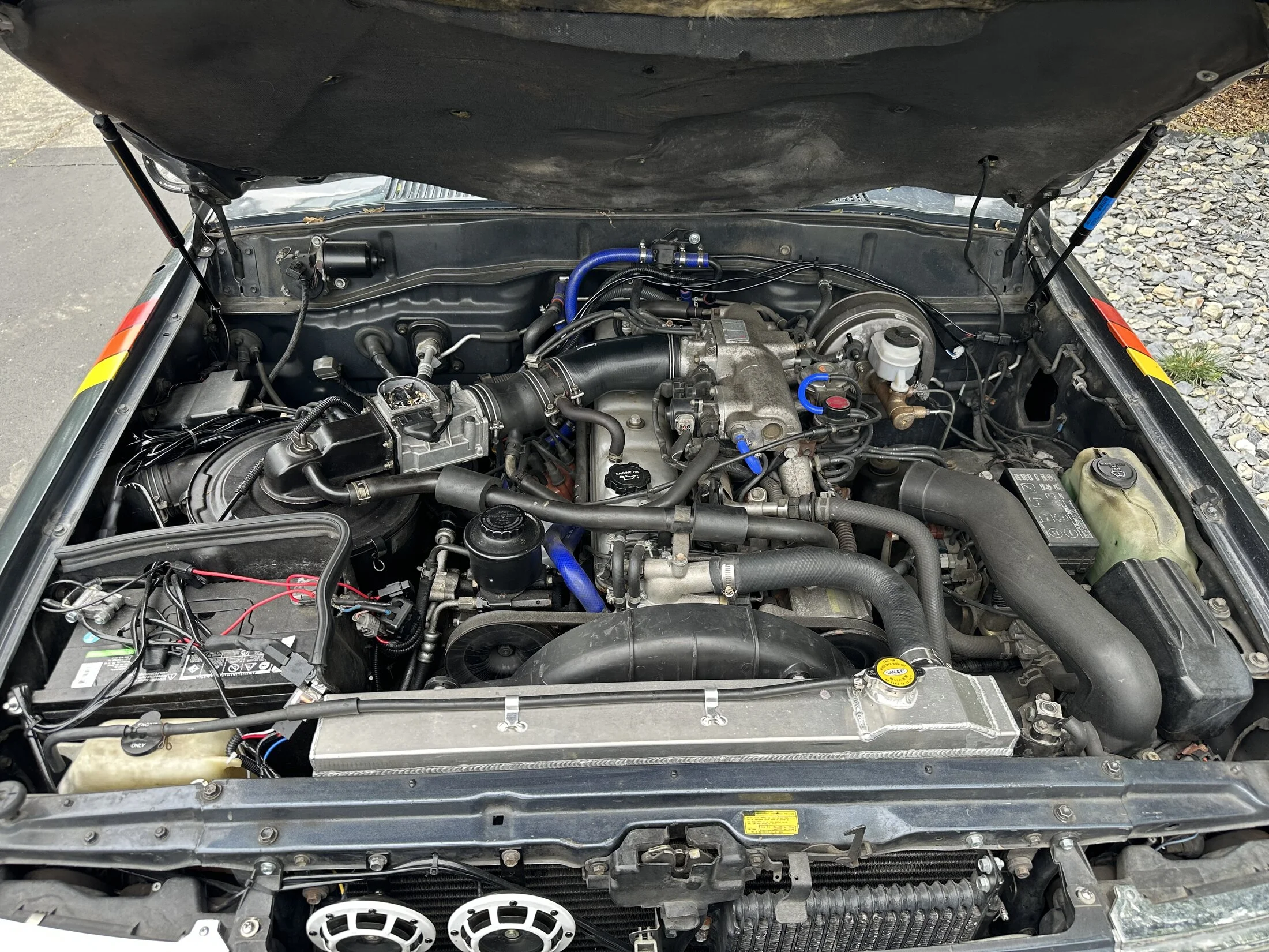

The other day my cruiser started up as usual but then bogged down to a very rough jerky idle then died. I started it back up and my buddy was pointing at my MAF sensor saying “this thing is clicking!” I removed the silicone and took off the black cap to see that the spring that opens and closes the door was consistently and rapidly opening and closing. I disconnected the harness and fired it up with the same result. It will run for about 3 seconds before totally dying with no start unless it sits for a while. Anyone have any idea what it could be? If you have any ideas or see anything I should check, please circle it in the photo so I can take a look at it.

It also looks like there are dreadlocks of aftermarket wiring going on around the battery compartment and the additional positive terminal that appears to be hanging on for dear life next to the aluminum radiator is giving me chills.
I would be sorting that crap out right away.
