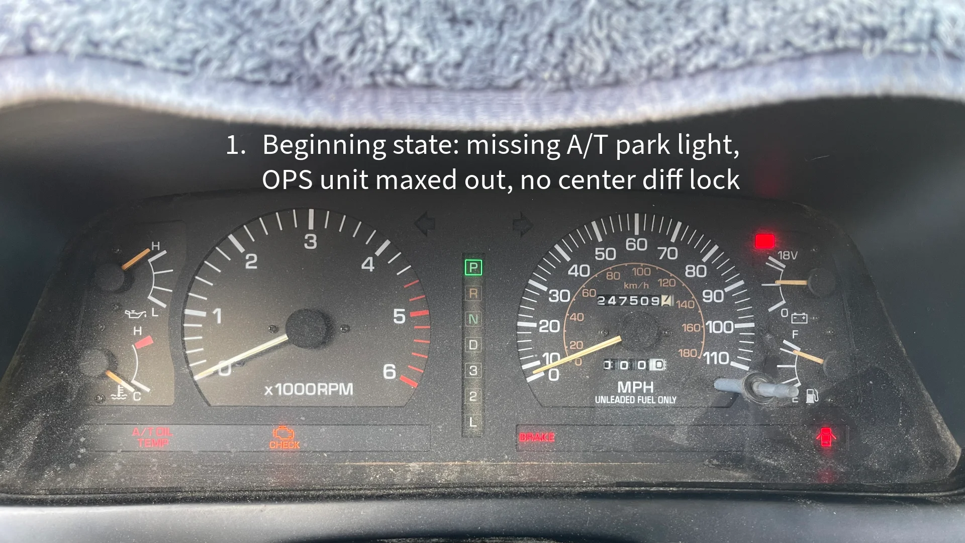

Finally had time to tear into this LC some more and definitely have promising updates as far as finding issues!
So after inspection of the ECU and connectors everything seems in good working fashion, even took my boroscope and inspected the harness where it enters the firewall and all looks very good with no signs of damage or unexpected wear. I had only ever seen one other person with an ECU issue so I thought it may have been a little extraordinary.
I completely agree with your skepticism on the ignition coil and igniter not being new OEM, I actually bought two other igniters and ignition coils that are used Denso OEM parts but to reassure they weren’t bad I had bought remanned OEM units just so I could check that off the list of what’s good (atleast for now)

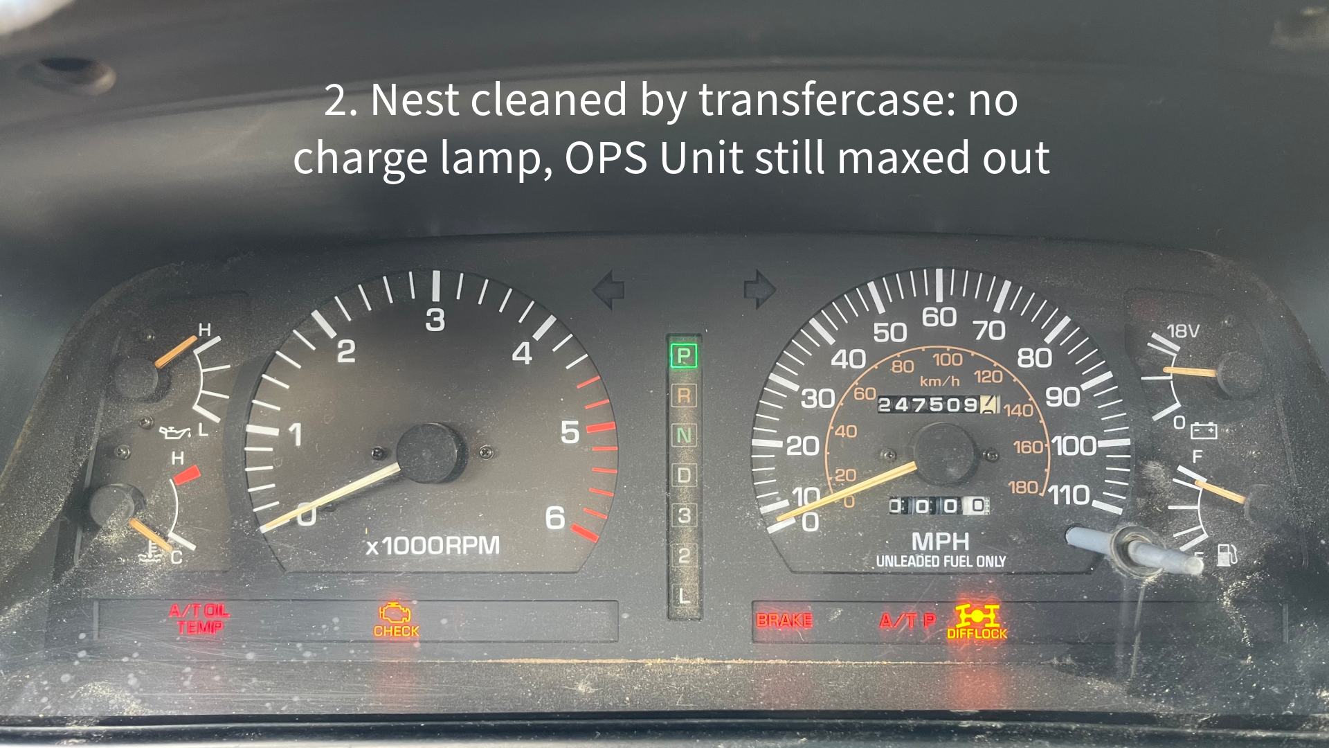

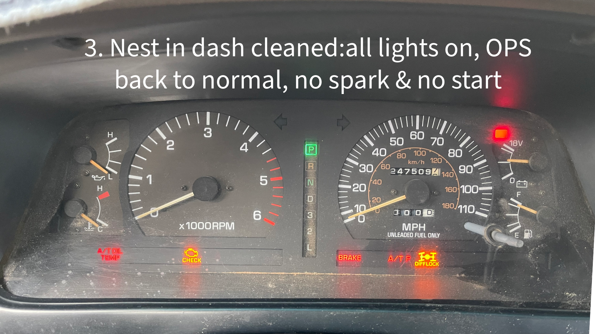

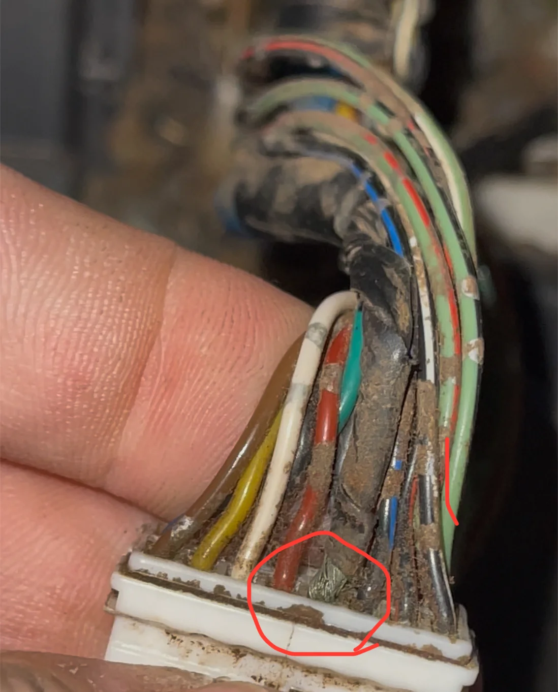

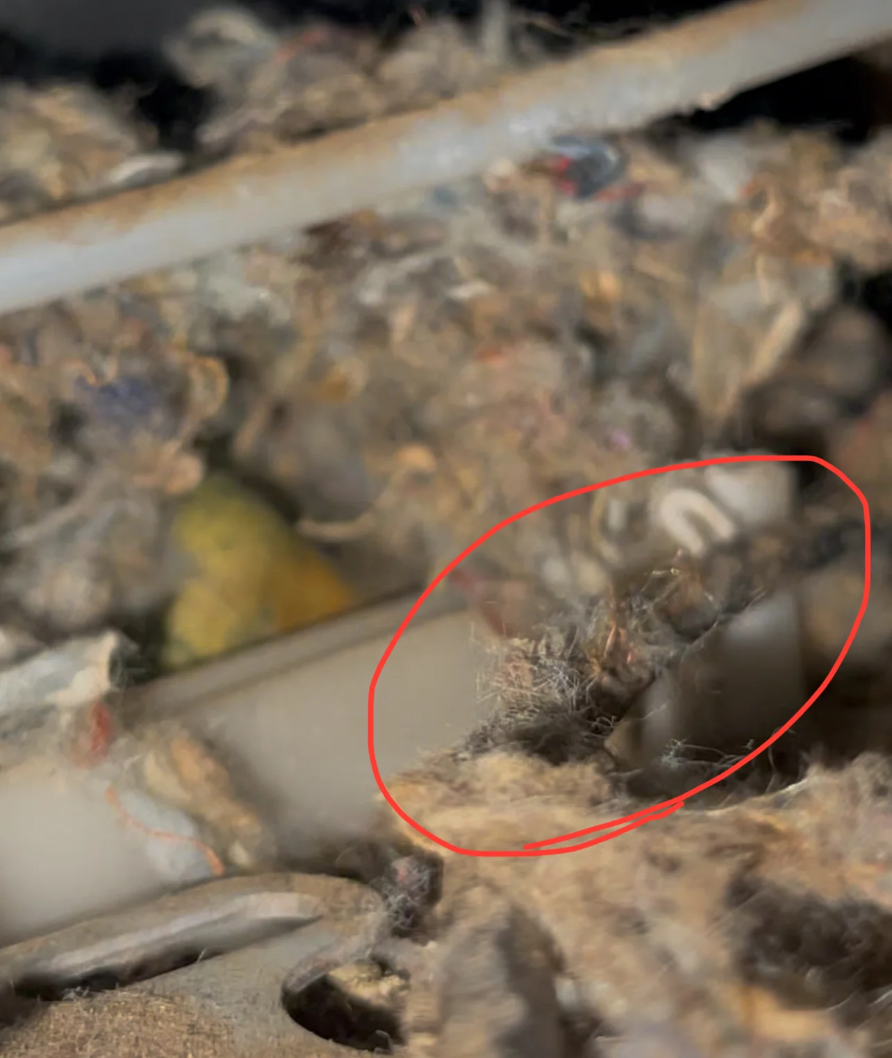

After that I decided to do a full undercarriage inspection of wiring and I believe I may have found my issue. Once I got to the transfer case I noticed a lot of debris tucked up between the transfer case and trans tunnel and low and behold a damn rats nest..
After cleaning out all the crap and debris I noticed the nest was lying right next to a wiring harness that runs atop the transfer case so I took my boroscope and inspected the harness. Strangely enough the loom is in tact but I have a feeling those little bastards definitely have chewed into it because once I cleaned everything I decided to turn the key and see what the cluster looked like. Everything was as normal until I started moving transfer case shifter…
After shifting the transfer case gear selector I noticed my center diff lock light came on, my A/T park light came on, and my charge lamp came back on but after a few cycles of the key and just moving the shifter back and forth the charge lamp is now off again but this is where things get interesting. I thought to myself maybe I’ll just take another look into the dash except behind the radio this time and I found yet another nest and exposed wiring from the radio harness and antenna. All I did was wiggle the harness and my charge lamp came back on so I’m going to more than likely pull the dash and dig deeper to find all the damaged wiring.
Attached are some photos, the different lights and exposed wiring in the dash (looks like antenna and stereo harness)
Going to dive into the FSM and see what exact harness that is and what’s going to entail on intial replacement! Feeling confident this may be my ultimate issues but I’ll keep moving forward
If anyone knows what this replacement harness is or where I could find a used section to ultimately replace that I would greatly appreciate that as there isn’t much for used parts near me.

Couple of thoughts before coffee.
Nothing on the transfer case will effect ignition.
The AT/P lamp should only illuminate when the transmission is in PARK and the transfer case is in neutral. No effect on ignition.
The CDL lamp should only illuminate when the CDL is locked. The CDL should lock by pushing the dash switch or shifting the transfer case into low range. No effect on ignition.
The oil pressure sender/gauge is simply a variable resistance to ground. No effect on ignition.
The intermittent CHARGE warning lamp could be as simple as a loose fuse connection in the fusebox by the driver's left knee (the ECU needs to see the signal from the 7.5 amp IGN fuse and this fuse powers the CHARGE lamp) or in the relay box on the left fender or a loose connection on the alternator. Or possibly more rodent damage.

after a second look the transmission harness it seems to be good and no shorts through the harness, the outer loom is pretty beat up but no glaring issues with the harness itslef. I’ve yet to check continuity but figured if I cannot find answers I’ll return to it later. The lights not being on prior to first power on was particularly odd but with all lights working as they should I’m going to shift my focus to the glaring issues within the dash.
CDL light is on primarily because I don’t have the physical switch, ordered one so it should be here soon! (P.O. Tried to part out the vehicle so some components were missing) if the CDL is engaged would that prevent start for any reason??
What’s odd about the Oil pressure gauge is I have not even messed with that particular unit whatsoever (physical unit or guage) The only wiring I have messed with that has initiated the intermittent lights is the harness in the dash that connects the radio and the antenna. No particular handling of the wiring kind of just moving it around. Although I understand it’s not tied into ignition could a short or bad ground comprise electrical current to allow these systems to function correctly?
I did replace the fuse for the ignition on the fuse block ( wasn’t blown, I just replaced for the sake of crossing potential issues off my list) and even tested continuity to FSM specs on the ignition switch and that all checked out fine but for the sake of troubleshooting I will double check the physical connection on the back of the fuse block in the cab and on the fuse block in the engine bay to assure the relay & fuse is getting proper power. I’ll follow up after these!

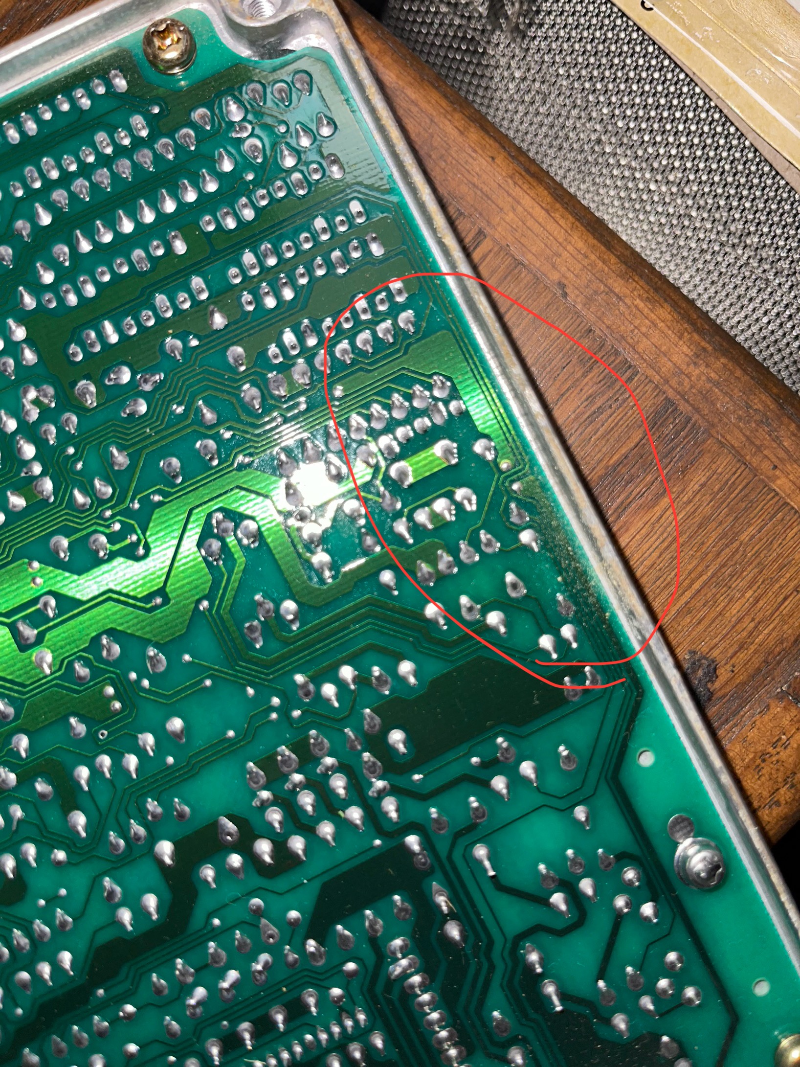

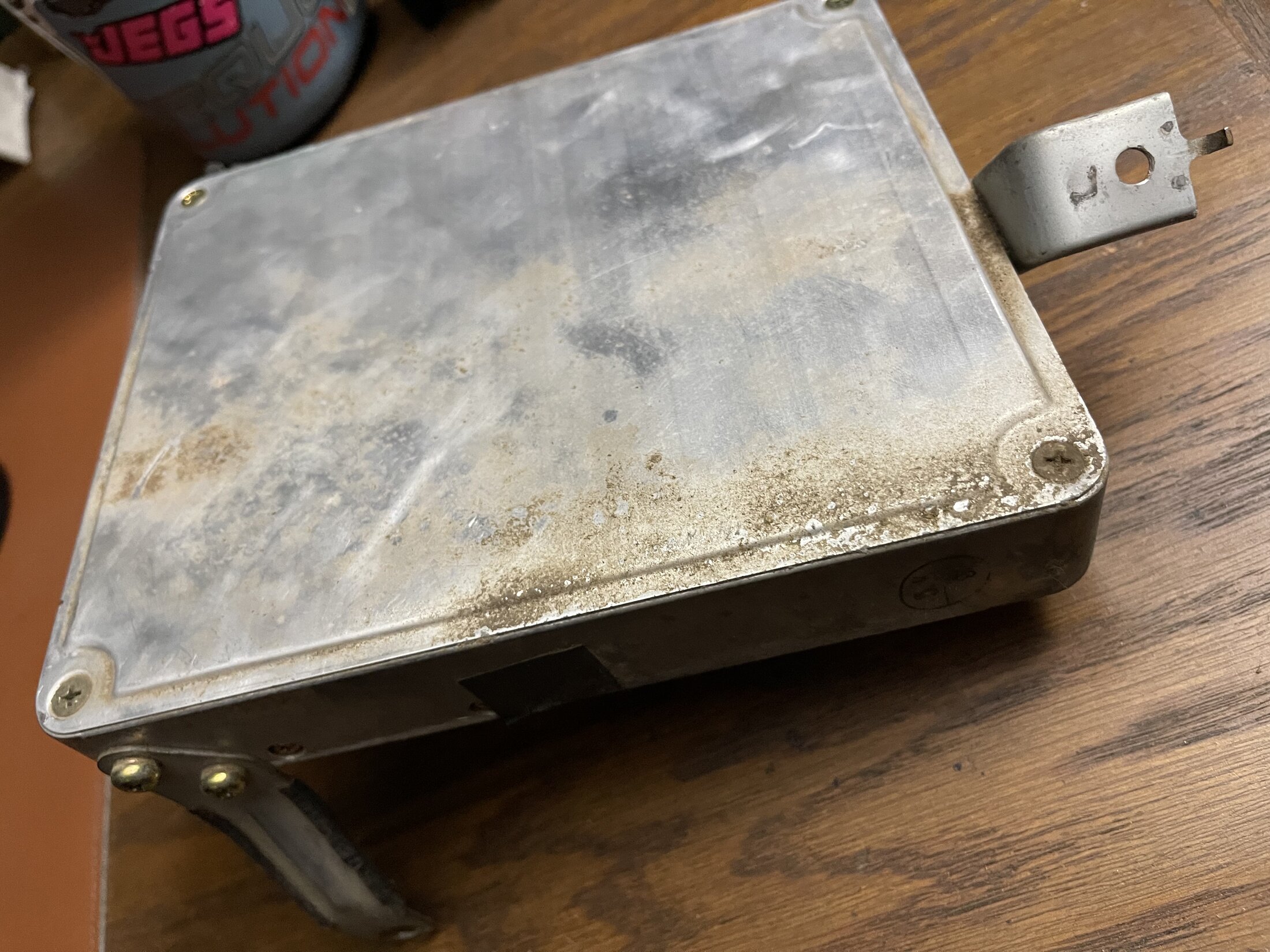

Bit of a side note but when pulling the ECU down I noticed it had been covered in something at some point (old stains just not sure if water or something else) given with everything reading correctly I figured I’d at least share to see what your thoughts are, even opening the case it looks okay maybe one small portion of the board had gotten something but the other side looks flawless. At this point I’m not opposed to pulling the dash off but if I can avoid it I would like to

So thought I’d come back to this thread to as I found my issue that ultimately wasn’t anything I was expecting
So thanks to the help of Jon I went through everything possible in terms of troubleshooting for my no spark issue and ended up discovering my issue at the point of ECU doing continuity testing of the wiring. After testing continuity I was completely stumped, all points of ignition were solid so i decided something had to be up and keep digging.
After searching through MUD I actually found a thread from a member who had the exact same symptoms and issues and even had replaced a lot of the components that were changed in mine. His thread simply ended on him discovering that the connection to the ECU was faulty causing the truck to randomly die so I figured what the hell I’ll see if I have a similar issue. When I removed the ECU I cleaned the connectors and reconnected and the truck started for about a minute then sputtered out and died so I had my buddy lightly apply pressure to back of the connectors and low and behold it stayed on and kept running!
I thought to myself how strange it was that I have the the same exact issue as this member, so reluctantly I tried to reach out but had no reply. So I checked out there posts and it turns out we are in the same exact town and he ended up getting rid of his LC 2 months before i ultimately purchased.
Unfortunately the PO has chosen to not reply which sucks and for respect I will not tag but if you look up the same non-spark issue you can ultimately piece it together.
The truck starts and drives when the ECU is not in the factory location (resting on the bottom edge of the dash where the glovebox connects, NOT hanging) when I connect and put back in the factory location it won’t start. I am still not 100% what the underlying issue is but I am going to test each connectors pins as I believe maybe it’s not getting full contact to the ECU’s or is still a chance the ECU is no good or damaged.
