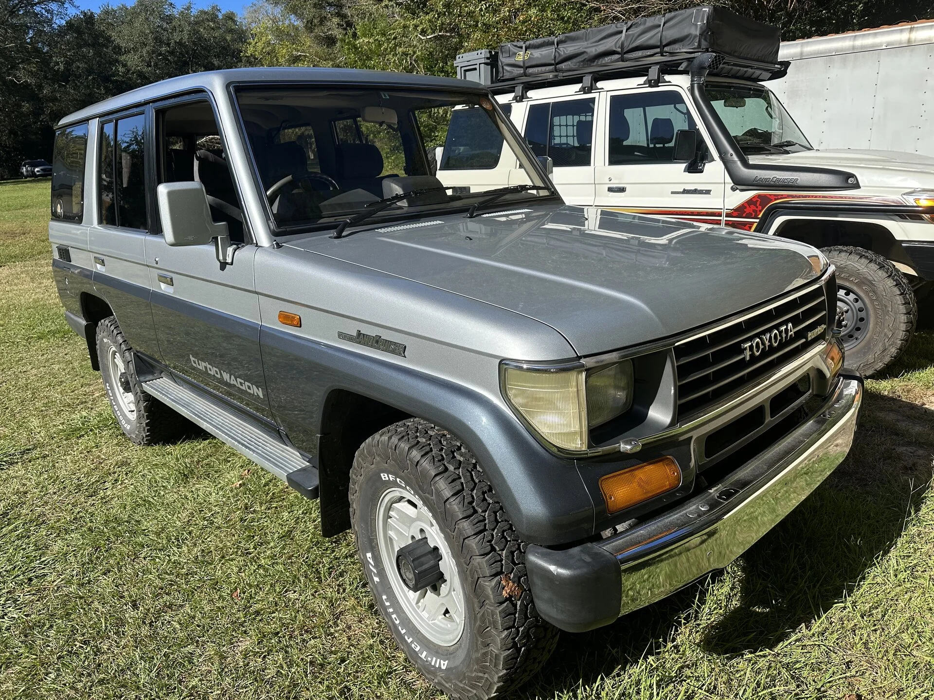

I'm getting this 79K mile '90 LJ78 turbo diesel delivered today. There is a station in town with B30 diesel. Would using that cause any problems? This might depend on a precombustion chamber. Does this engine have that?
