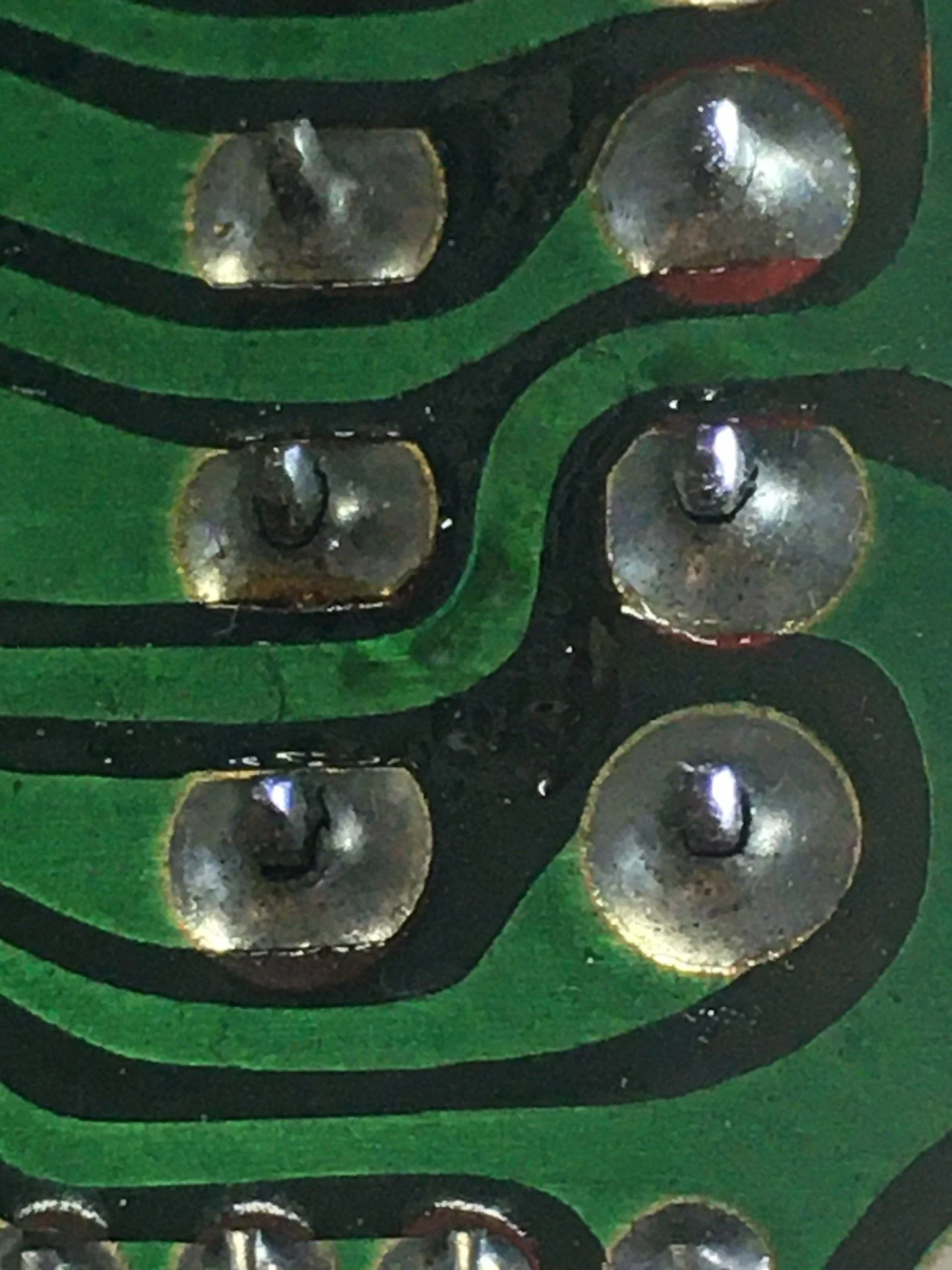

The truck I am working on sounded rough when it was fired up and moved off the trailer when it was brought it. I was not excited about doing body work and having to get the engine running well. I had read somewhere on here about the pins in the ECM getting fatigued with the weight and vibration of the connector cable over time. So, I pulled the cover off the ECM since it was already out and looked at it through my shop microscope (not necessary but handy) and found issues with ~80% of the pins. Cleaned up and soldered and the truck purrs like a kitten now.
