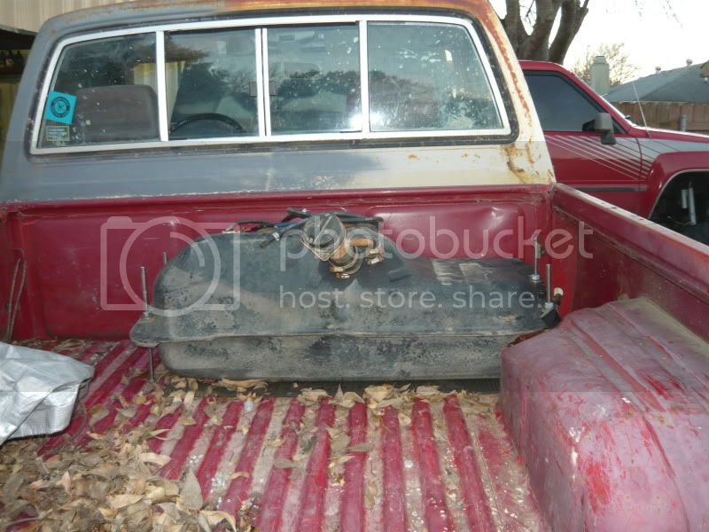

Bolted the fuel tank in the bed with some all thread rod and painted up the center consule. Welded in the used shock hoops and tested fitted the shocks.
Yep it stops and runs better with fresh gas instead of the rust/ mud mixture.
