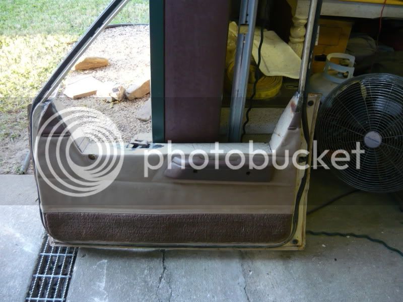

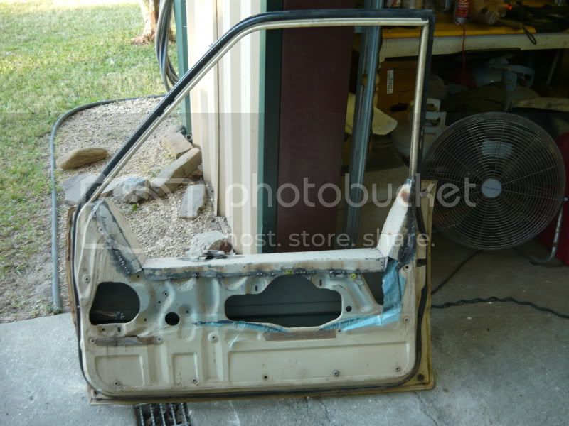

Tacked the half door together with my Harbor Freight 110v/ 90amp welder, cut the backing of the door panel down, folded the material over the cut out edge and restabled the fabric to the back. First ever sheet metal welding so there is a few holes, but this is my practice set/ learning curve. Thats why I started on the passenger side as well.

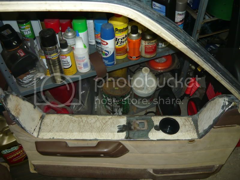

Worked on the half doors some more by cutting the holes for the West Marine cup holders. Also cut down the other door panel for the driver door.

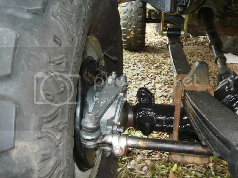

Pulled the front axle out, took it apart to find it was full of some pudding looking grease hub to hub. Removed the sway bar and torsion bar mounts before welding in some steering stop nuts with cover tabs. After grinding it all smooth added some paint, now I have to clean the knuckles up, repack the bearings, and put it back together.
