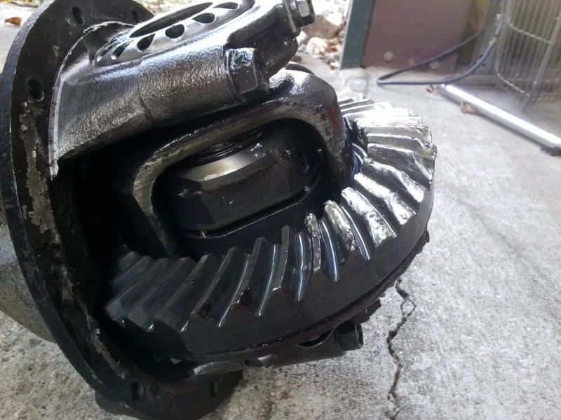

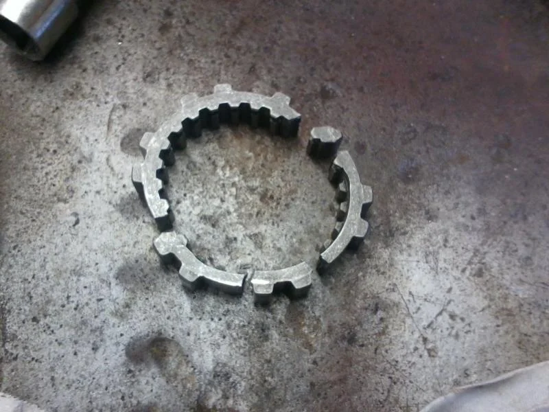

Finally got the broken 85 PU front axle apart and found a broken Longfield hub gear, chewed up ring and pinion.:bang:
that `s a lot of carnage
not sure what caused BL`s hub gear
the rnp looks like it was a bit loose on bearing peload check it on tear- down can`t really C tooth contact pattern but could be a tad shallow as well
If it was set up wrong all the teeth would show some wear. It was only a small group that were chewed up not chipped or broke off. Looks like it smashed a chunk of metal through it. IDK.
Correction its a stock hub clutch gear that broke not a Longfield part. Also looks like the ring gear was stopped and the pinion continued to turn grinding up that one section of the ring gear and pinion.
Hmm. Maybe you had something in there rattling around that locked something up?
