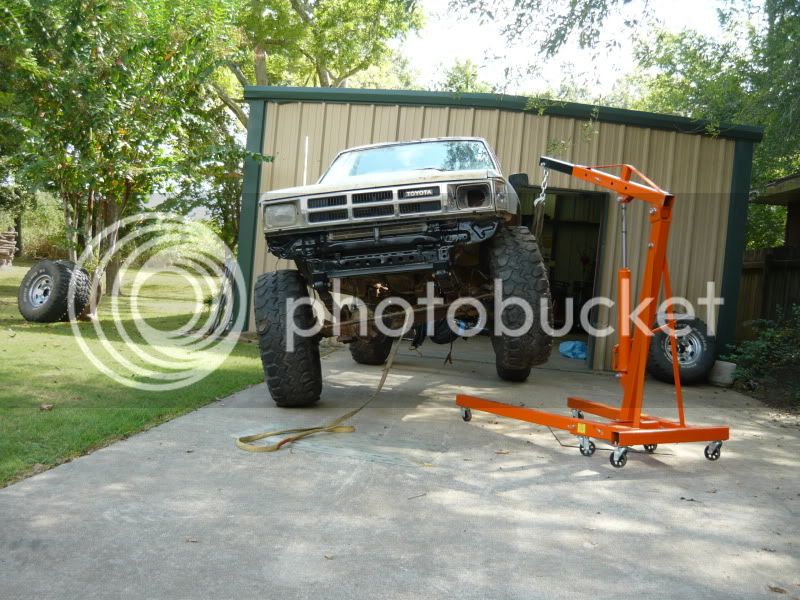

Got a yard pass today, so I mocked up the wheel spacers along with wheels and tires then flexed it out to check for any clearance issues. All seemed to work well, but nothing substitutes the real world. Installed the used steering draglink after cutting it down 2.5" for the axle moved forward with the RUF, still plan to do the ball flip when I rebuild the axle. Here is a few driveway shots.

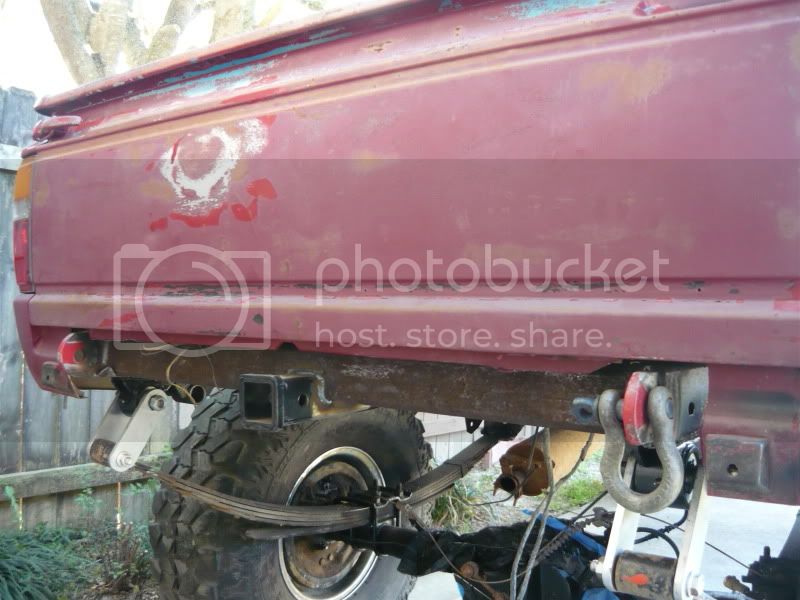

With the nice weather I have been outside all day working on the Yota its now 4 different colors. Got the 2wd bed from P.A.P. wish I had it before the rear spring install, but some fender triming took care of the tire clearence. Installed a rear cross brace with a 2" reciever and some shackle mounts. Then decided to start fabbing some half doors out of the orginal doors, started on the passanger side and swapped on a spare whole door. Removed the section not wanted, cut the door capping out of the an old holy hood, and installed the door handle. Ran out of time to start tacking it together but it its looking good so far.
