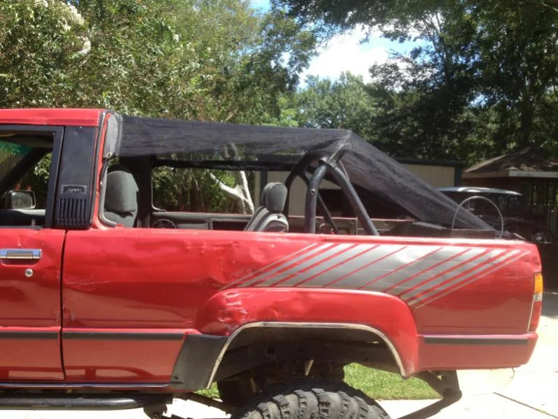

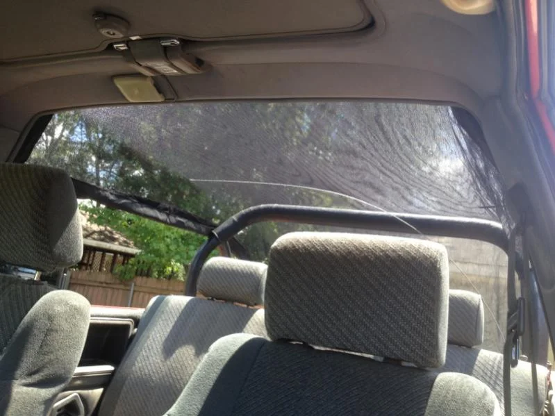

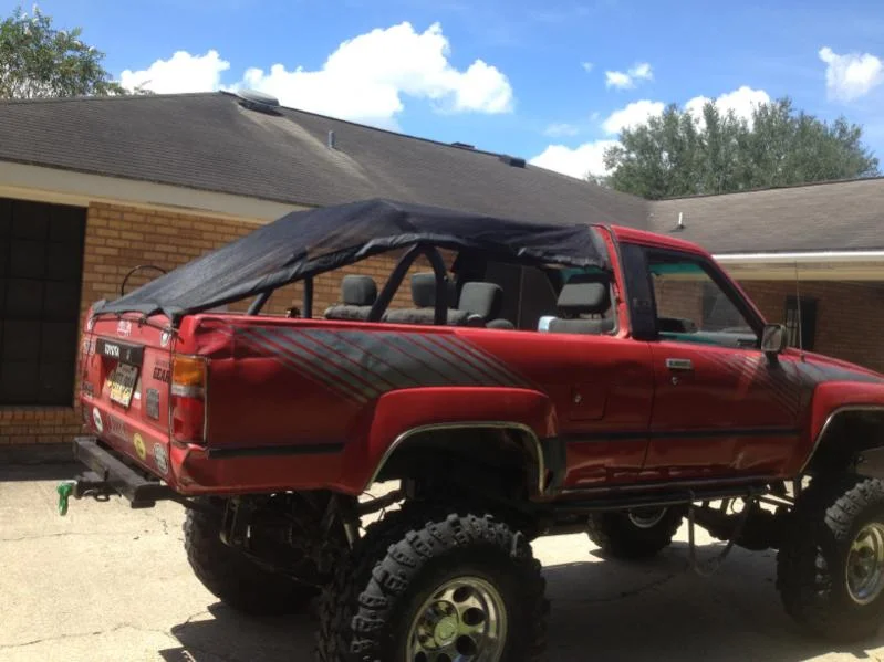

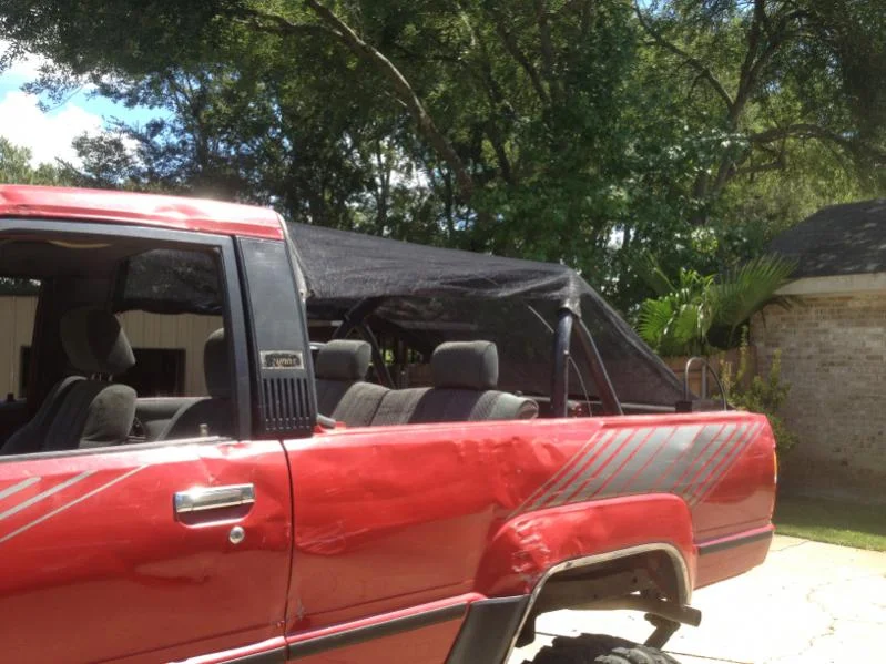

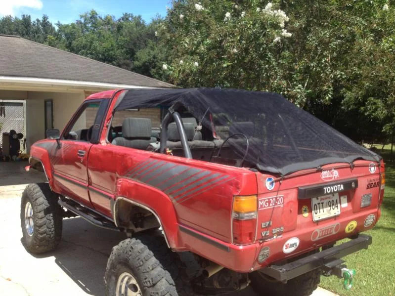

Built some shade screen for Mason out of an old gazebo cover.
That's pretty sweet. ;)
Thanks Cody Sent from my iPhone using IH8MUD
Nice looks great and would make a great mosquito net too if you decided to sleep back there :)
John, that came out nice :clap:. I remember me and Linda riding in the back of your 4Runner trying to hold an umbrella for shade. That should work out much better.

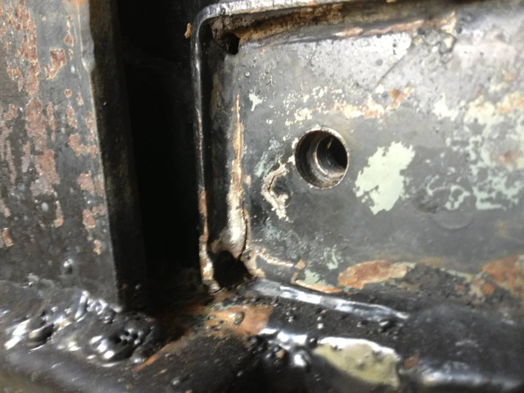

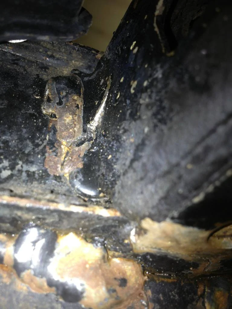

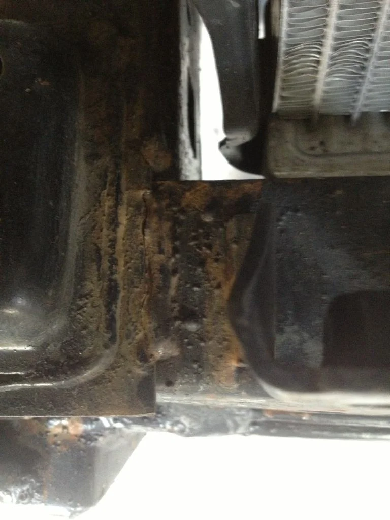

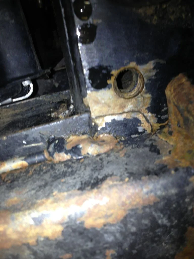

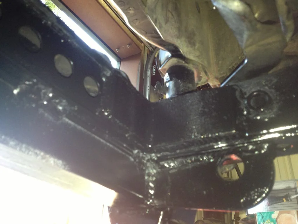

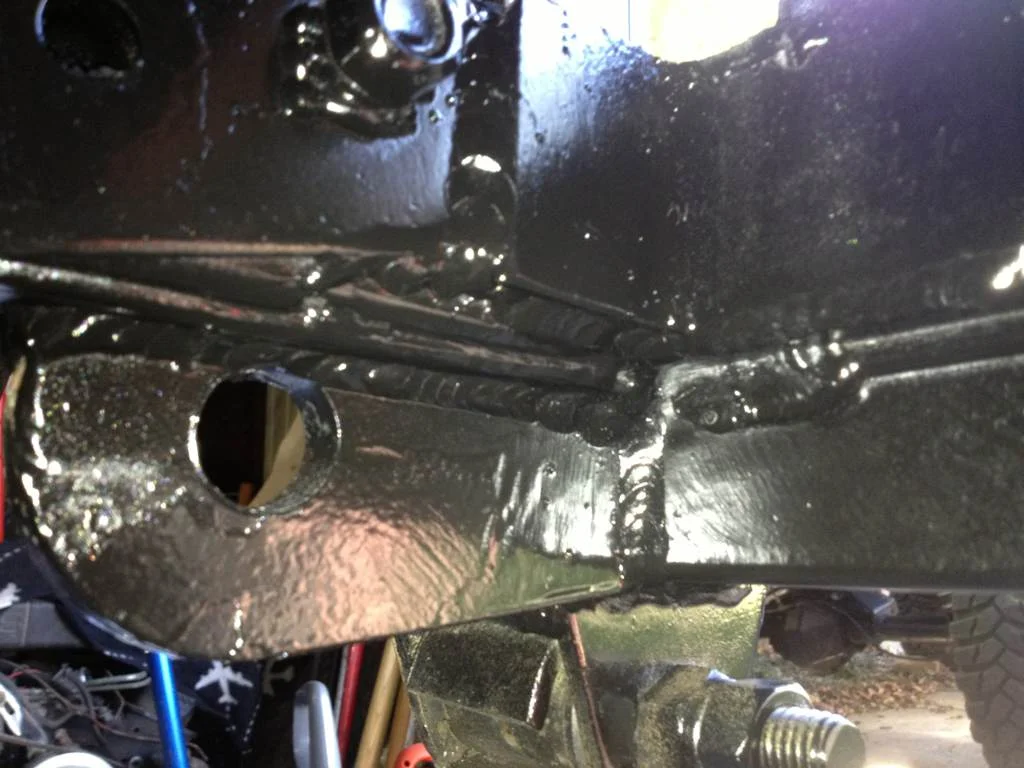

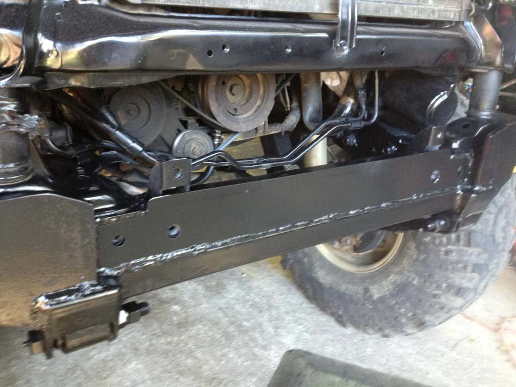

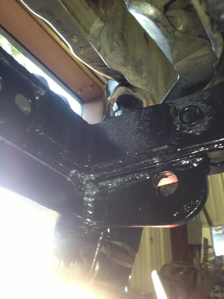

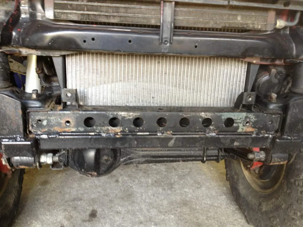

Had crack issues with the front frame crossmember right above the spring hanger. The factory welds cracked between the frame rails and the crossmember. Fabbed up a 1/8" front reinforcement plate, 3/8" angle iron brace to tie in the frame rails to the crossmember, then tied in the frame to the spring hanger with some 1/2" plates with some shackle holes. Also welded the stock welds up before adding the new metal.

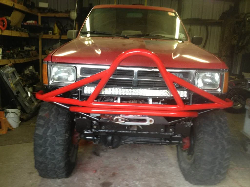

Got the bumper cleaned up and back on the truck along with adding a 30" Led Bar.

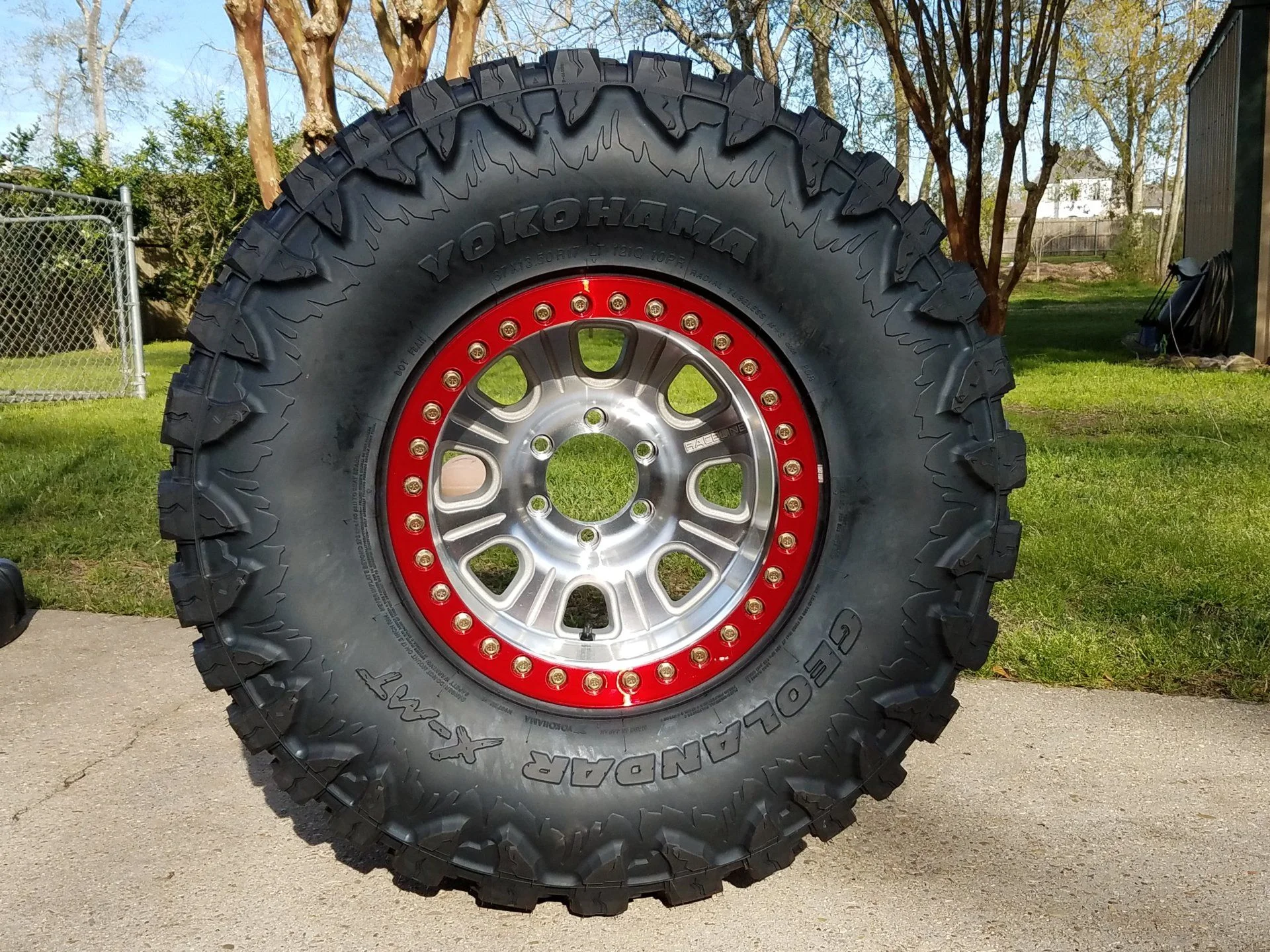

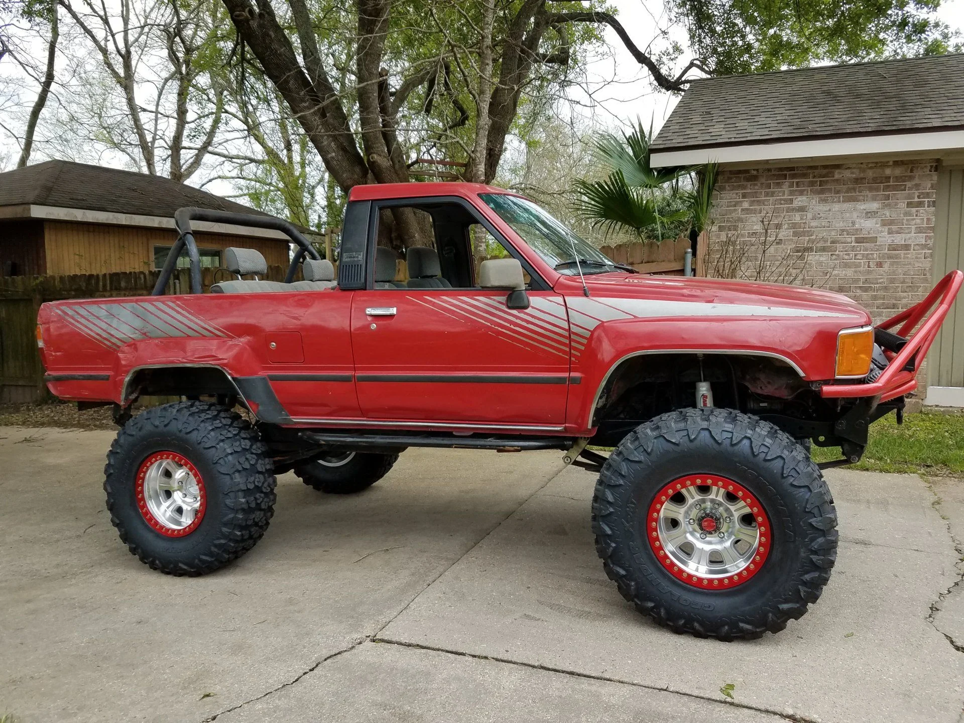

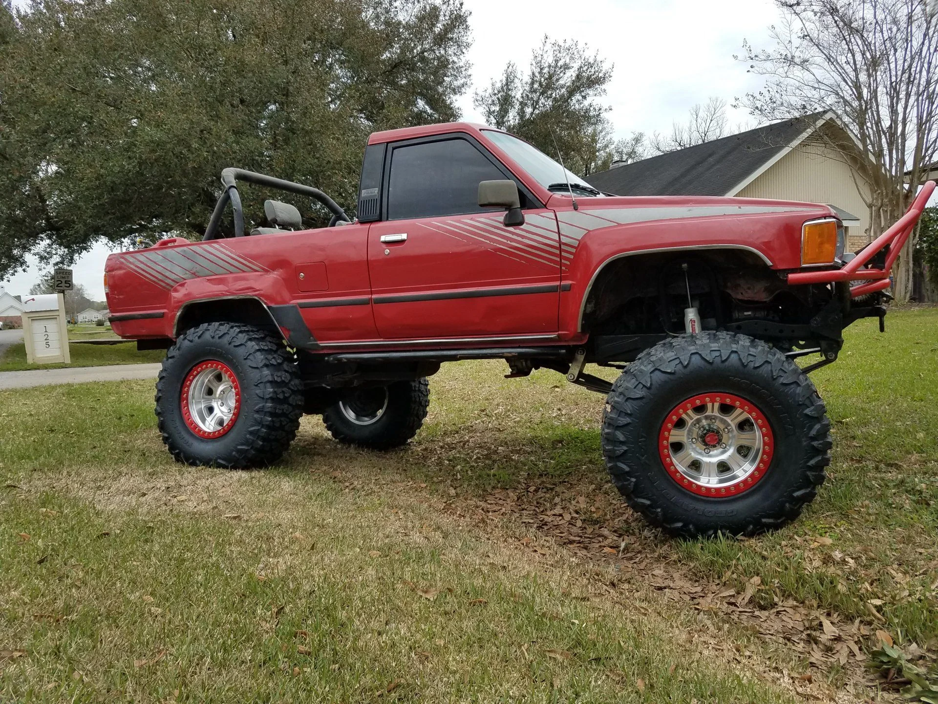

New wheels and tires.
Raceline bead locks and 37"x13.5x17R Yokohama Geolander MTX tires balanced with 10ozs of airsoft bb's.

Looks good, John. Any particular reason for going with 13.5" wide?
