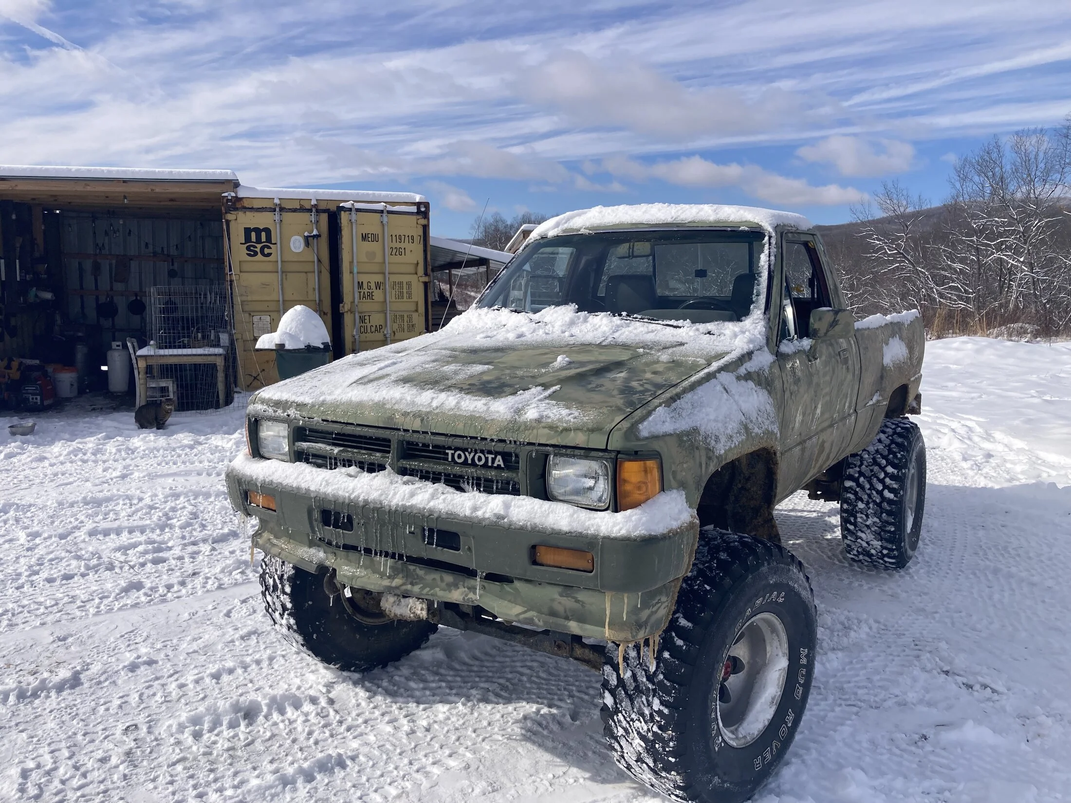

I bought an 87 Pickup and it came with the 4-5” Superlift. I have 35” tires on it.
The steering has too much play and needs to be replaced. I’m trying to figure out which parts are compatible with the lift.
I need ball joints, pitman arm, stabilizer arm, inner and outer tie rods, etc.
Does anyone know if stock parts are compatible or do I need something else?
Thanks!
