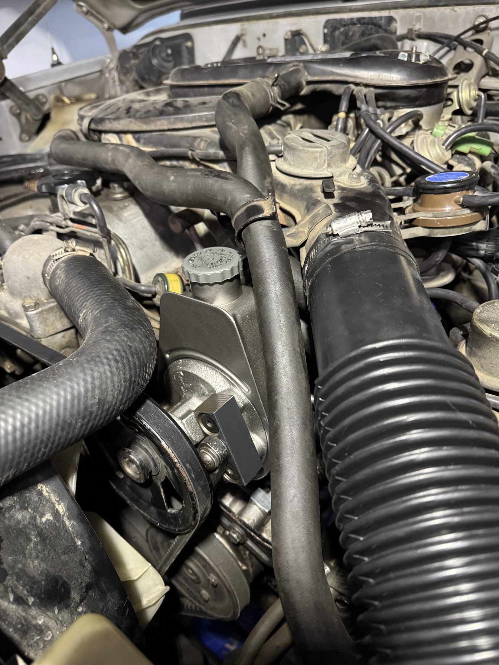

Well howdy again. I wanted to make a quick post and update the leaky power steering situation. It's fixed. I got a new pump from Napa. I can't remember the part number, but when I cross-listed the pump @orangefj45 recommended, it came up for a 1978 Chevy pickup with a 350, so that's what I ordered. It fit great, with a slightly longer and more bent return line nipple. I was able to straighten the return nipple out with a tubing bender so it actually works better now than the one I took off.
FYI for saginaw folks - invest a couple Jacksons in a pulley puller for PS pumps. I got one from Amazon in a blow-molded case for like 35 bucks. Having the right tool makes this job much much easier. If you take the pulley off with the puller with the pump still mounted, you don't have to remove the bracket from the block. Much easier and less time consuming. For install, just install the pump, then use the tool to install the pulley. It has the advantage of allowing you to align the pulley with the other pulleys shared with the belt. I just eyeballed it, but I'm happy with it. Another plus is the pulley tool does not put undue pressure on the pump shaft, so there is no danger of breaking vanes or otherwise damaging the pump when you install it.
I also replaced both the pressure and return lines with the kit from @orangefj45 and they fit great. The return line is a tad on the tight side, especially on the pump return nipple, but better too tight than too loose. Giggity. You have to use the clamps supplied as the super cool Toyota factory PS return hose clamps are too big. Slight bummer.
I saw the thread where folks were struggling with getting the saginaw on and off and keeping it from leaking. Just use the right tools and do not use o-rings on the pressure fittings. In my experience, hydraulic fittings of the type on the PS lines don't need them and they just cause leaks.
Anyway, the steering is now butter smooth and fully sorted and leak free. On to sort out other little leaks and issues. I'll do my best to keep the thread going. As previously mentioned, I kinda suck at the forums thing. I don't have just a whole lot of free time between work and kids and girlfriend, and I much prefer to spend it actually out in the garage wrenching.

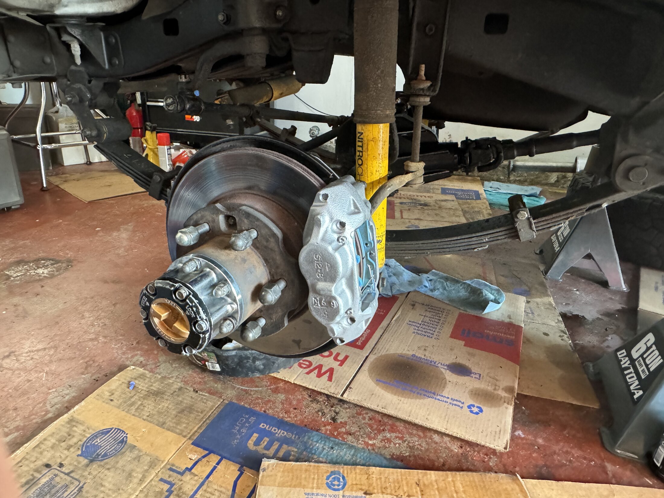

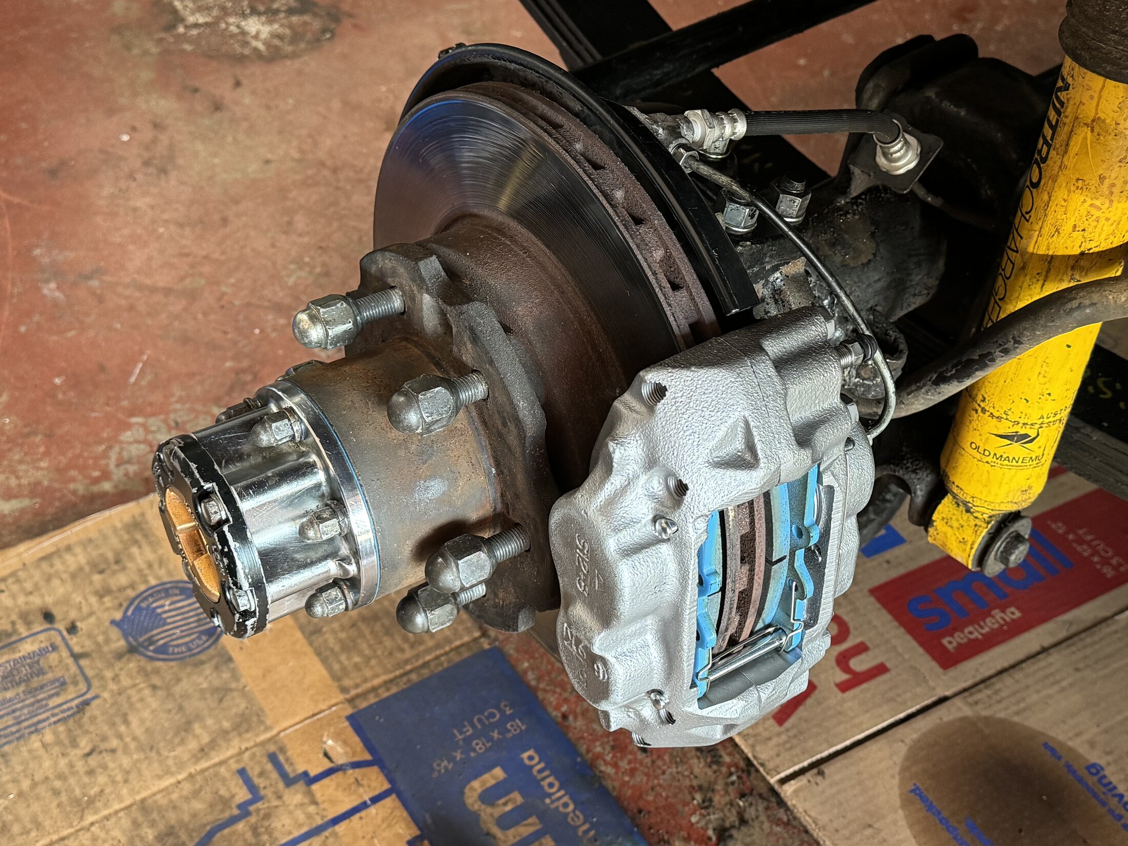

Long overdue for an update on this. I have spent the past few weekends rebuilding the knuckles which turned into a major rebuild of the front axle. I had the diff gone through by my awesome transmission guy and replaced the crush sleeve with a spacer.
I also found the soft brake lines were shot and so were replaced with Toyota units. Knuckle rebuild kit, rebuilt brake calipers, and fresh pads.
Birfs were in excellent shape, and got fresh grease. The driver side was just a mess of gear oil and grease mixture. Glad that’s done.
Also added a leaf to the driver side leaf pack to try and help with the lean, which was very prominent on this truck. Also an engine oil change and a few other bits and bobs. Ran out of gas tonight, but will di the victory lap tomorrow for sure.

Work continues and I am on to one of my least favorite jobs - re-fixing a problem I’ve already fixed. The cheap napa ps pump started leaking like crazy.
I had the rig in front of the house and noticed a piddle in the street and when I investigated - ps fluid. Dammit!!
Anyway, I got it in the garage and pulled the pump. I tried another cheap one from the FLAPS, but it was the wrong configuration. Ordered one online, also the wrong configuration. Had to return both. Giant PITA. So I took the leaky pump with the correct configuration to California Rebuilt Exchange in Moreno Valley. I use their store in Ontario all the time and they do quality work. This is the last chance for the saginaw conversion though. I also ordered a rebuilt kit for the original pump from partsgeek and will rebuild that to have at the ready. If this rebuilt pump leaks again, I’m pulling the plug on the saginaw conversion.
The good news in all of this is that while the Beast is in the garage, I pretty much finished baselining it. Fluids changed, all soft brake lines have now been replaced, the calipers rebuilt and new teq wheel cylinders installed. Rebuilt pump should be done today, and after that’s installed I’m on to the engine. I need to sort out the AIS, EGR, and the rest of the really fun vacuum and electrical gizmos.
Thanks for listening and for all the inspiration here on MUD. I feel like I’ve passed some kind of initiation rebuilding the front axle, and I am now officially a cruiser head. Maybe Russ will sell me that BJ40… hmmm.
Oh yeah, while Amazon had the Prime whatzit last week I got a deal on some Cooper Evolution M/Ts. They are now mounted and I am digging the more aggressive look.
Just heard back from CRE about my saginaw pump. They are going to replace the chinese POS pump with a rebuilt original GM pump and use the same reservoir to keep the config correct. Should be ready tomorrow AM. Can’t say enough about California Rebuilt Exchange. They have always been excellent. Hopefully this sorts the problem out for good. Will post again once it is installed.
Pump is installed and so far is dry for a first couple trips around the block. Well, not the first trip, but the second one it was. I got back from the first and was about to start throwing tools when I saw the smog pump covered in ATF. Thankfully, I saw it was leaking from the pressure line. I cinched down an extra gutenteit on it and it stopped. Thank goodness.
