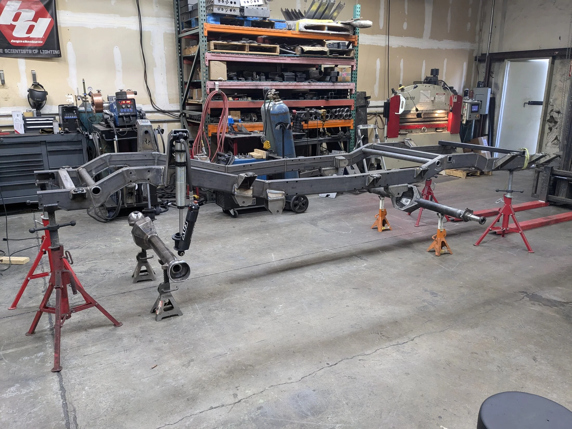

Rear is mocked up. Local dealership had 6 bushes in stock so the rear is set.

Are you planning on keeping the stock 107.5 inches wheelbase or extended the body to make it 112.5"?
That is some top-shelf work!
Ths is a custom 60 chassis, nothing to do with 80 series dimensions. Not sure why 112.5 is being brought up.
So... Will be to 60 specs to start. I may extend the arms and inch to give a little extra clearance for the 35s.
Fair enough.

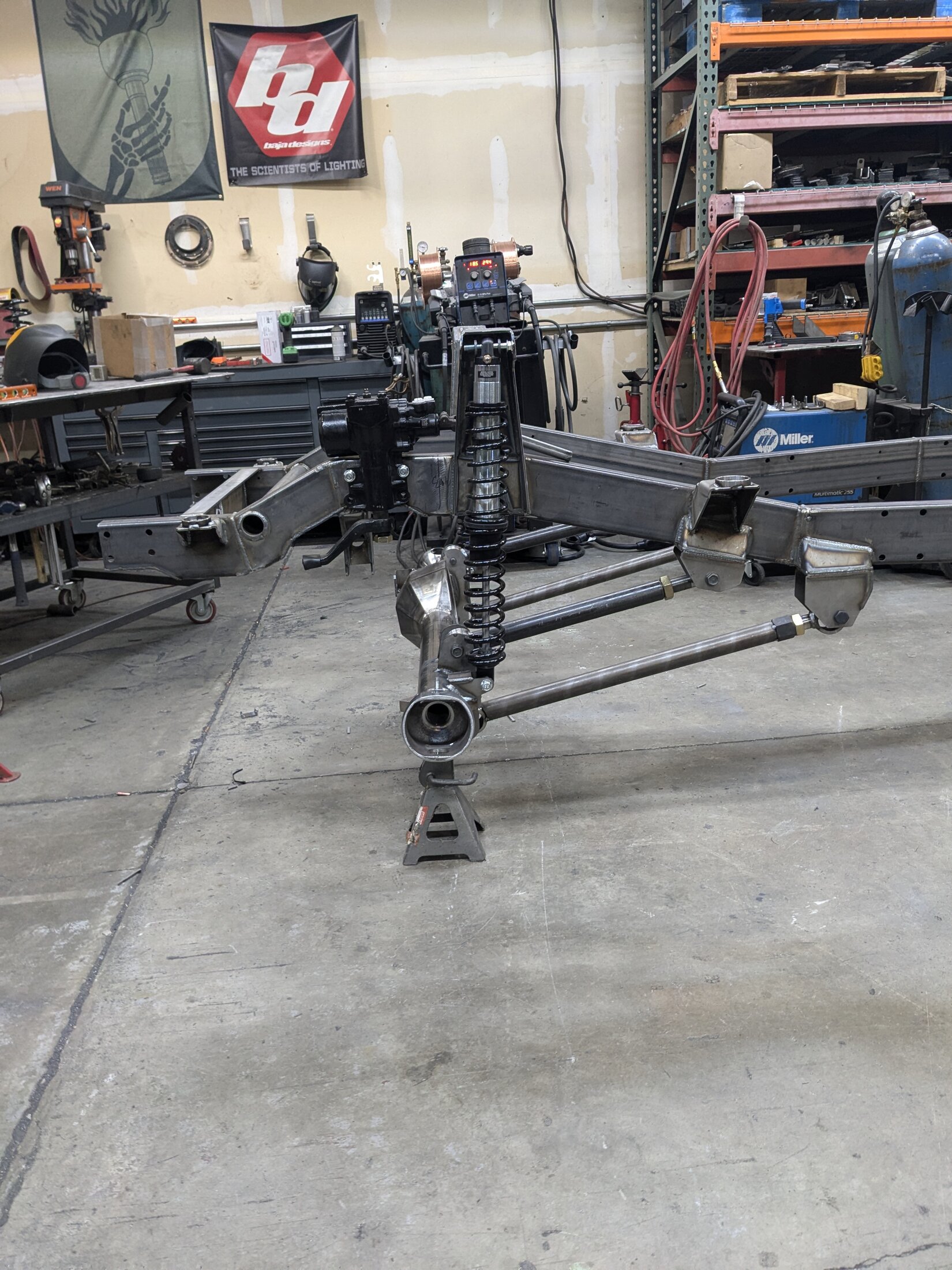

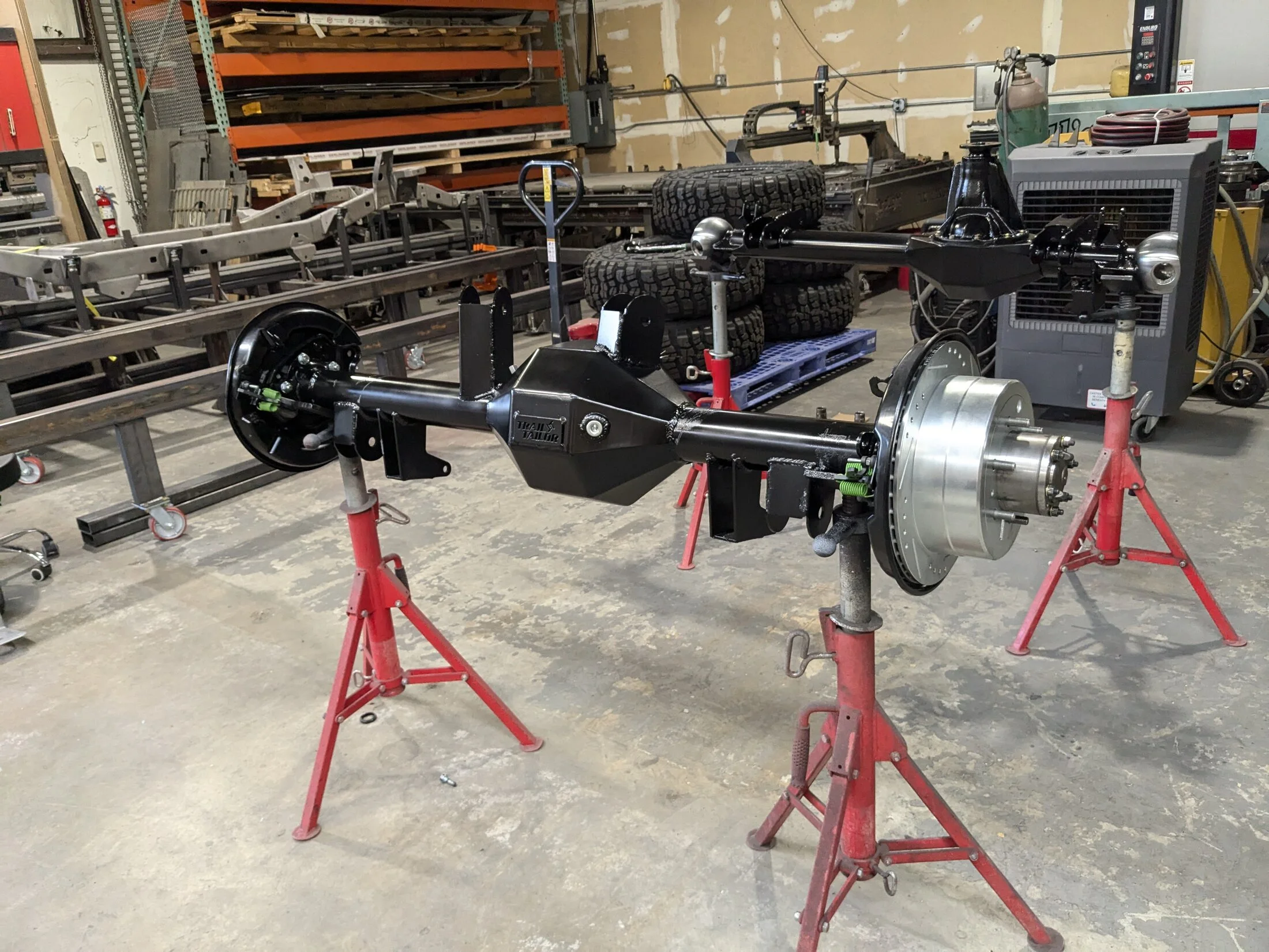

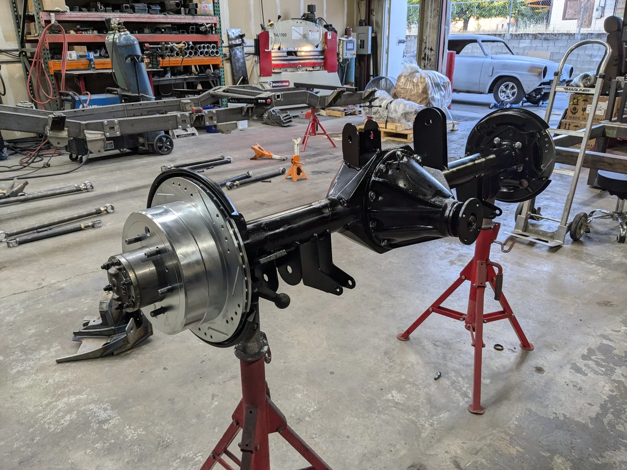

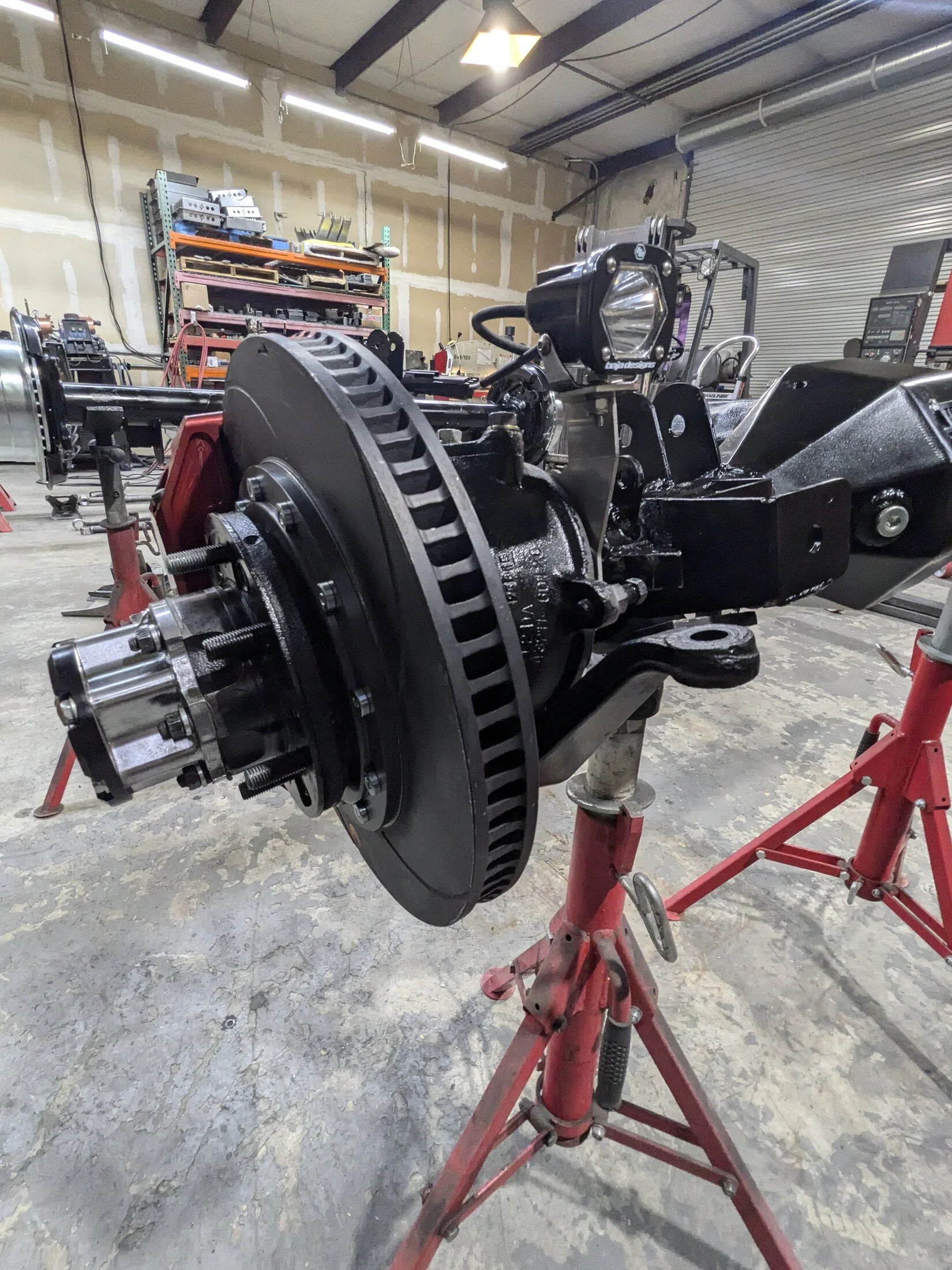

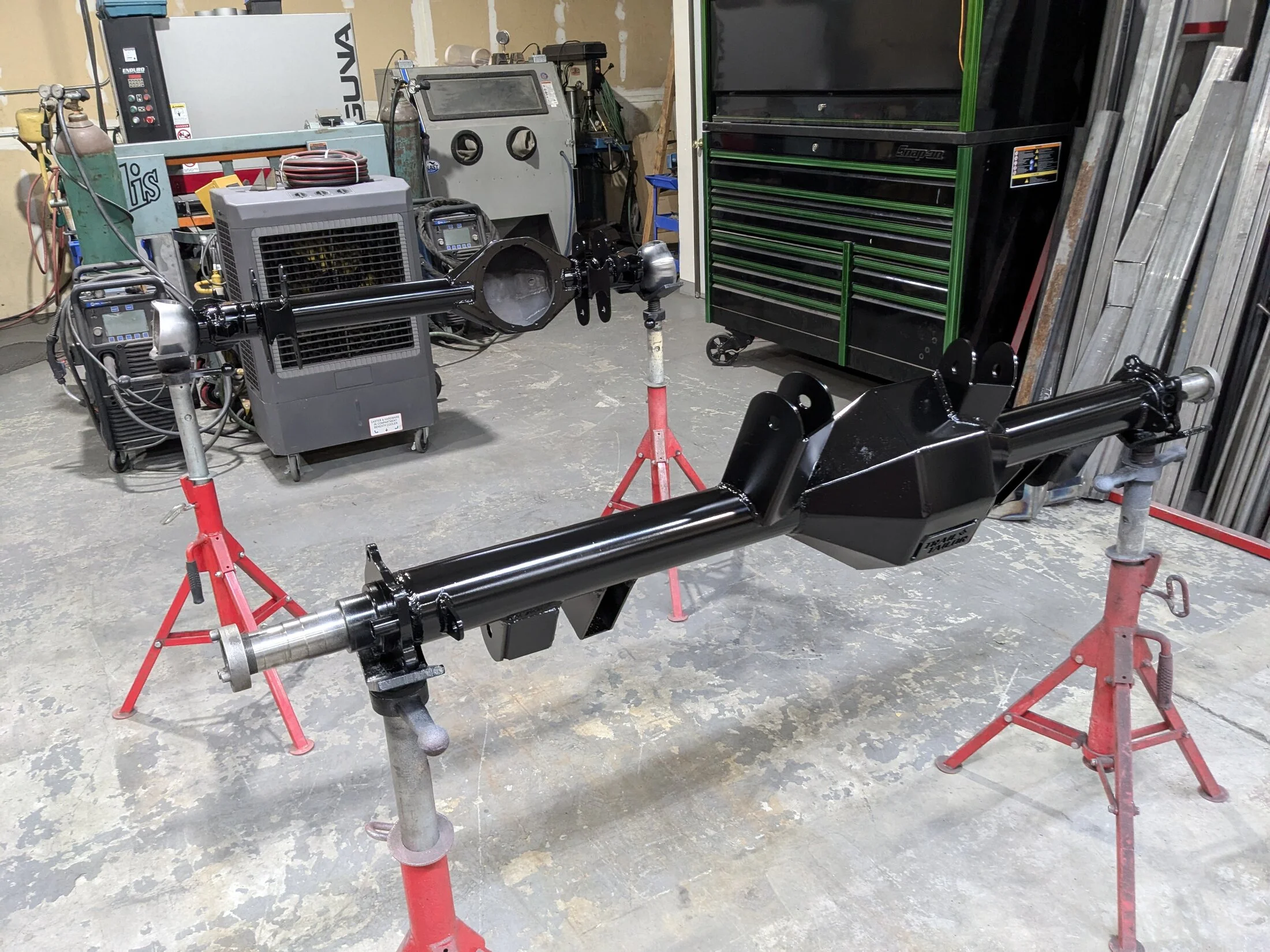

Saturday morning progress. Built the axles for the 60 series production chassis.

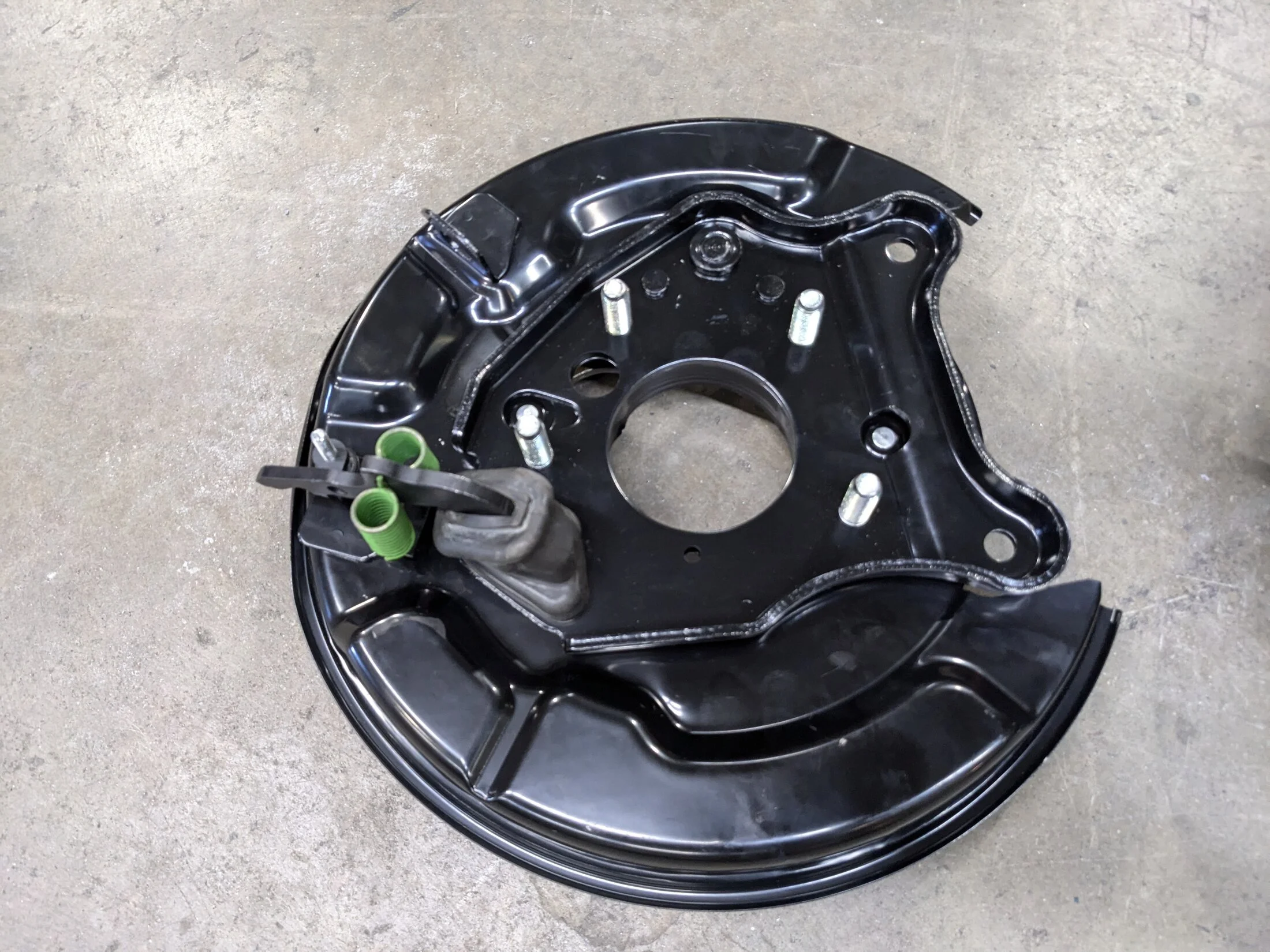

Trail Tailor custom built housings with inner seals and 4130 CrMo knuckle balls, Trail Tailor FF e-brake shields with new internals, 4.10 gears, Eaton E-lockers front and rear, Trail Tailor 4340 rear FF shafts, RCV 30 spline 300M front shafts/birfs, New Aisin freewheels, PowerBrake Stage 2 2-piece rotors and 6 piston calipers, Koyo bearings, ALBs with Baja Designs S1 spots.

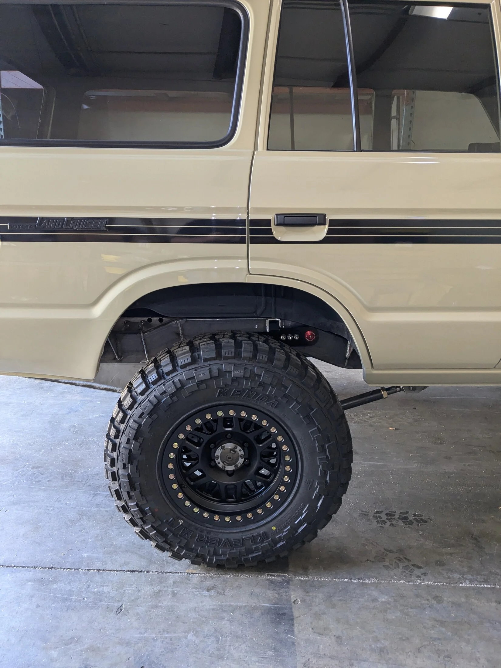

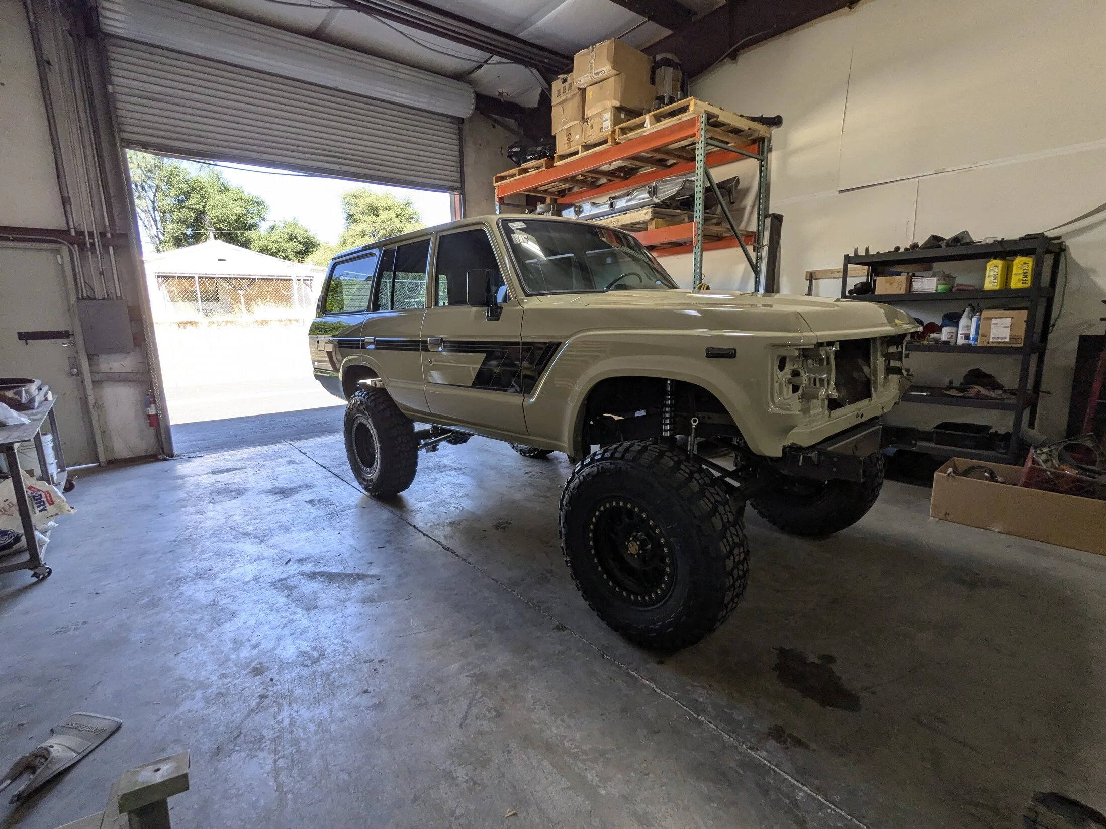

Set the body on the chassis this morning.
Should lower down about perfect with all the weight I need to still add. Figure about 2" drop in rear and 4" in the front. Looking for a .75-1.00" rake when finished.
Stretched out at 108.75" wheelbase.

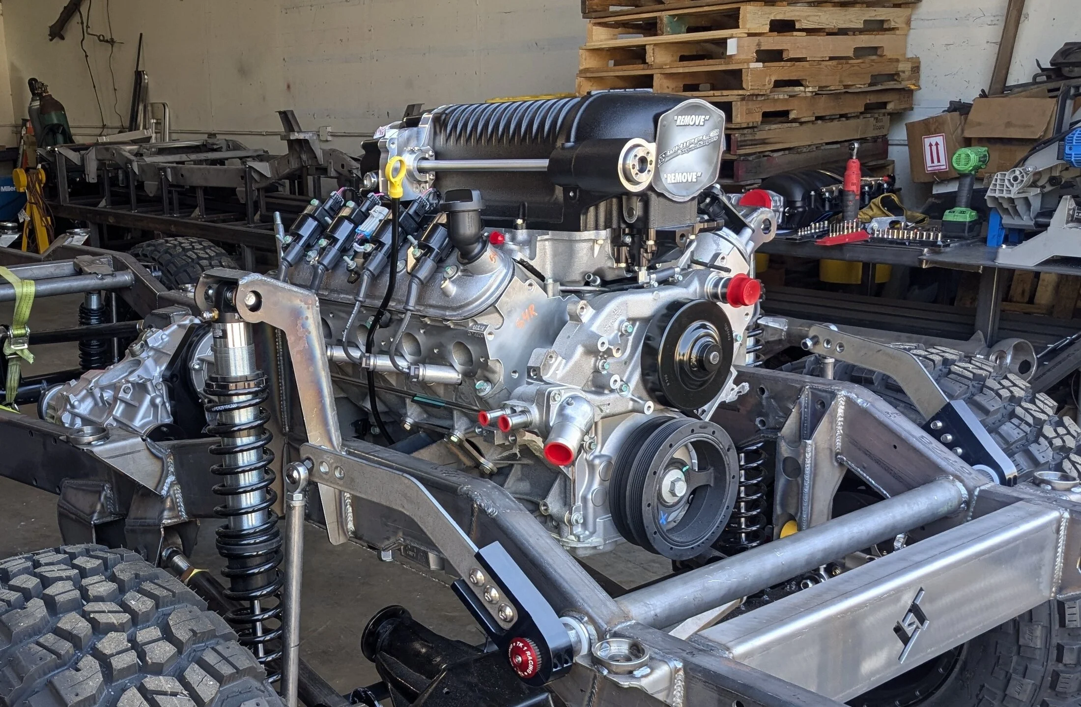

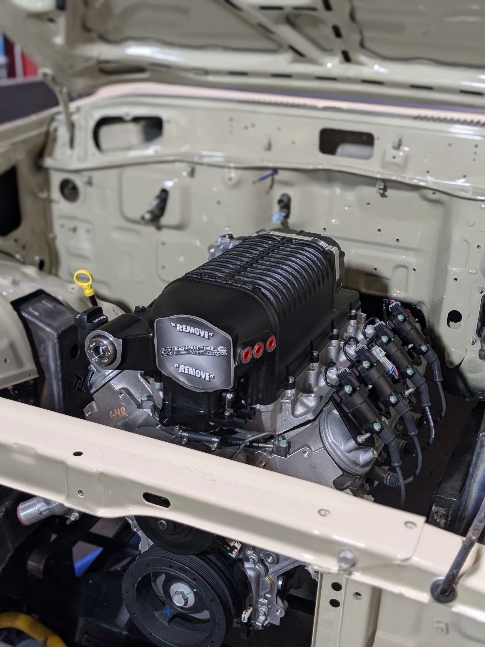

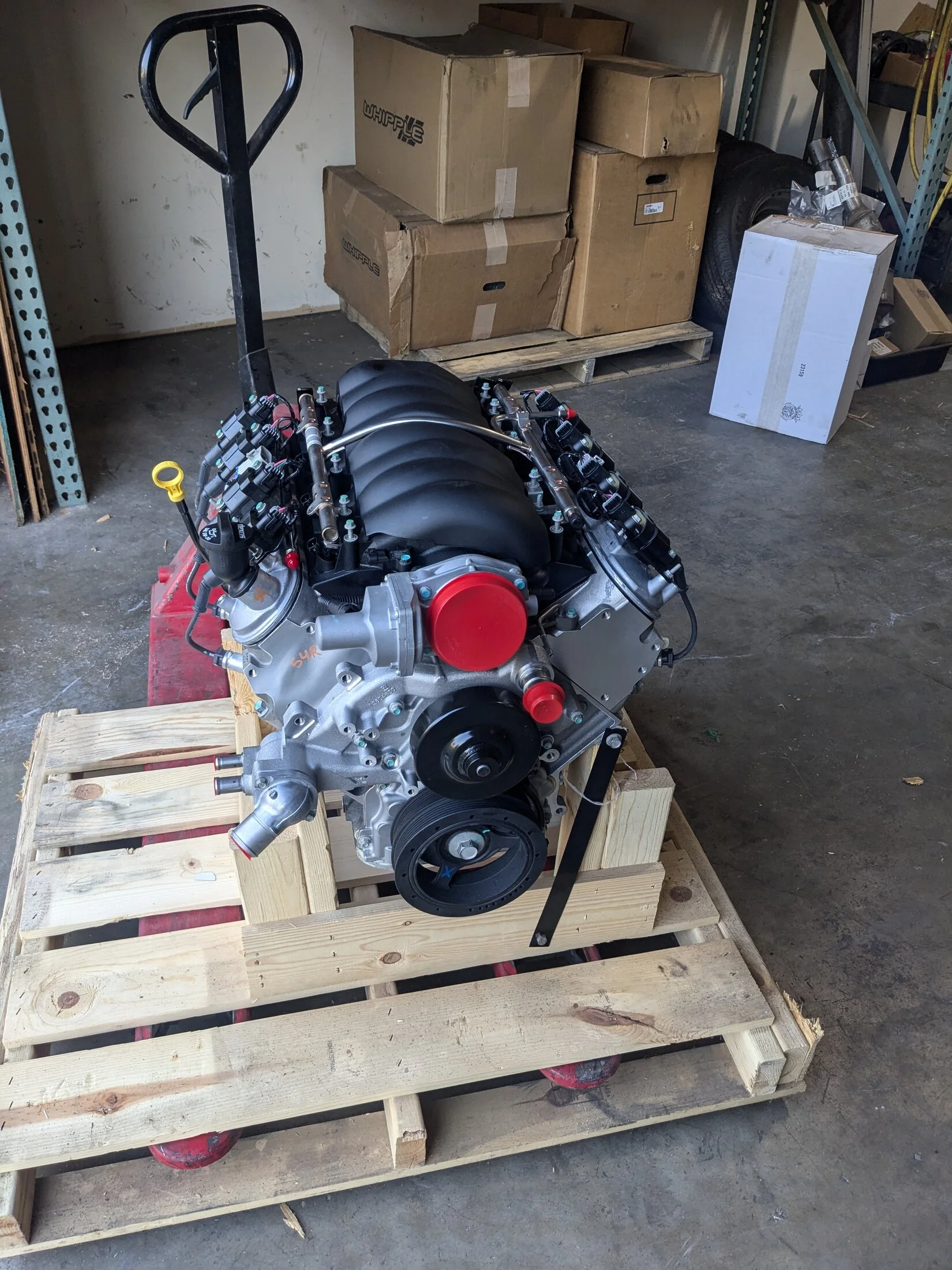

LS3, TR4050, HF2A, front and rear bumpers, 130# rear bumper mounted spare, sliders, dual batteries, skid plates, 45 gallon of fuel, small rear storage box, seats, console, interior cargo roost rack.
