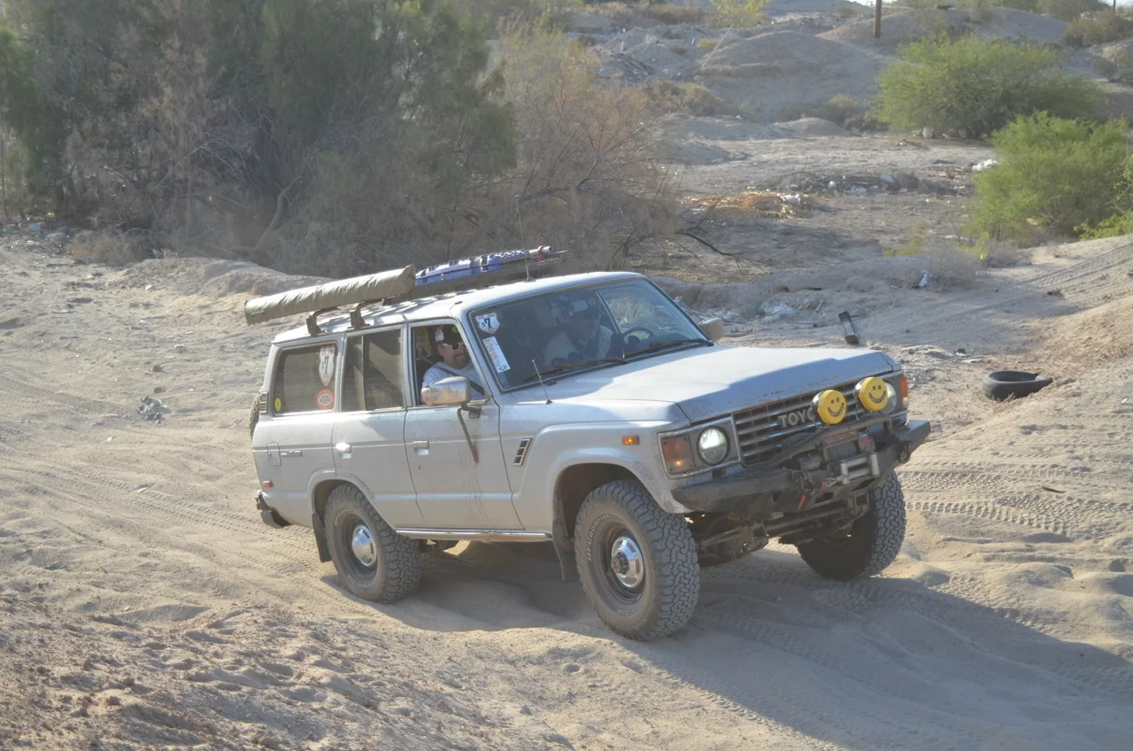

I currently have the OME 2” setup, but after running in the Mexican 1000, I need new shocks.
While down there it was recommended that I get the 5100’s in the front and 5160 series in the rear. (The local 4wd store said they didn’t have anything that would fit my rig)
I usually run with a storage/sleep system in the rear so there is the added weight to consider.
I do plan on entering the race again and putting it through the paces again all the while using it as a weekend driver.
Any help with part numbers/suggestions would be greatly appreciated
