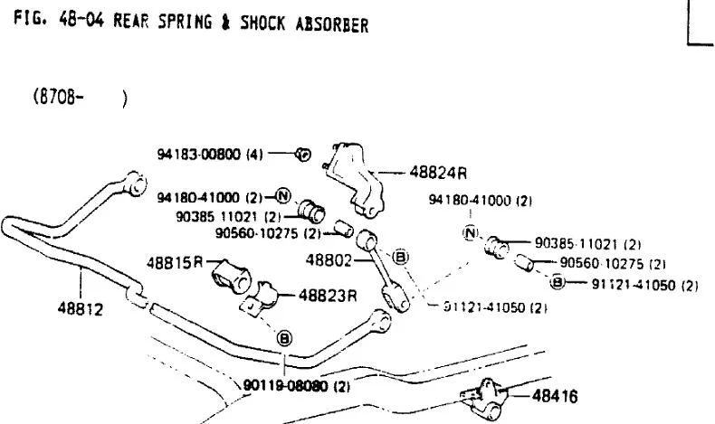

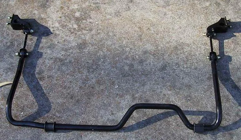

new sway bars are also available from your dealer. You'll need everything shown on this picture plus the brackets & bolts that hold the bushings onto the axles. The parts are from an FJ62, but they fit the FJ60.

87 FJ60 did not have a rear sway, but it has the tabs so one can be bolted in. I bought mine from cruiserparts.net for about $150. It had all the parts needed, but it was used - very used. I spent a good deal of time sandblasting it. In hindsight, had I known, I would have bought new from Man A Fre. It's basically the same price as a used one from cruiserparts.
