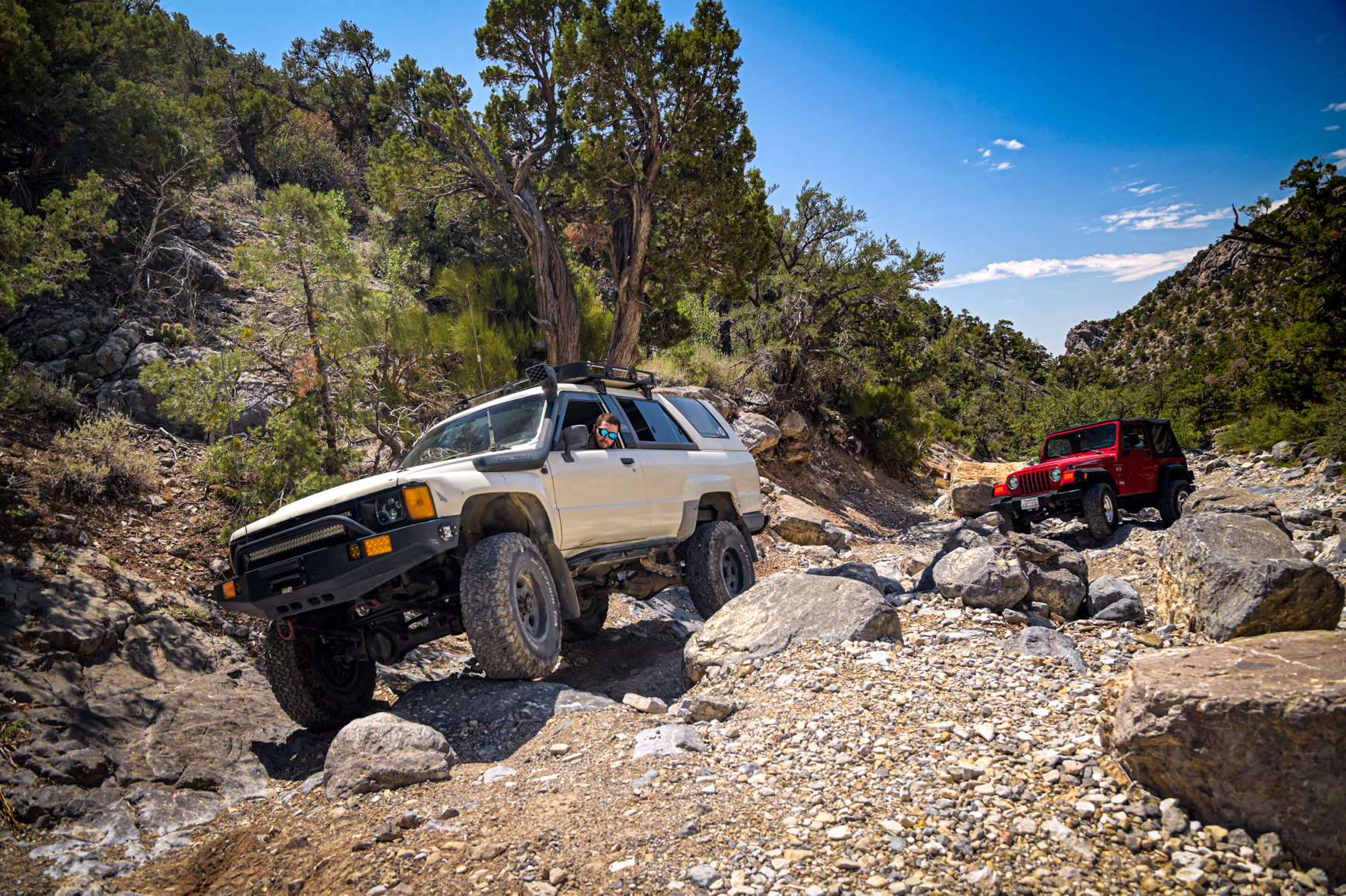

Here are some pics before I had the overheating issues or cracked frame.
