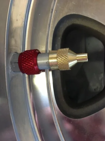

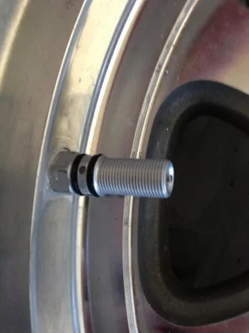

Honestly wasn't overly concerned about loosing a bead, but it didn't seem to do much aired below 15psi, visually speaking.

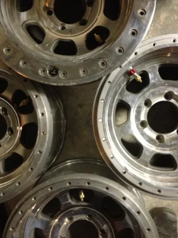

Won't be skeered for 6psi with the bead locks and the Krawlers will benefit from.
Was about to drill the rims for the Monster valves when a buddy called requesting a river rescue.
I have a greater appreciation for the FJCs long travel suspension, considering speed is a necessity on the river bottom, and lower COG.
Can add FJC, Jeep, Chevy Recovery Vehicle to the 80, though all I brought of value was a little common sense, snatch strap, and snatch block to the party.
I'd do a write up, but can't compete with NLXTACY, plus there's 400 online already.

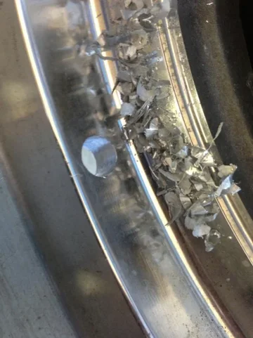

Monster Valve Cliff Notes Install.
Mark hole opposite existing stem.
Man up, and realize it can be TIG 'd if incorrect.
Drill 1/8, then 3/8", then 7/16" ( or use a 7/16th step bit ).
Tap
Install valve body with thread putty
Finish, repeat on balance.
The TRs don't offer as many locations to mount, since have to be able to access the red ring (it's the deflator). I carry a spare and first time I dislodge, will consider bigger rings.
