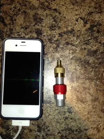

Monster valves should hit today. Can air down in 30 seconds, up in 50-60. Have to drill rims to install.

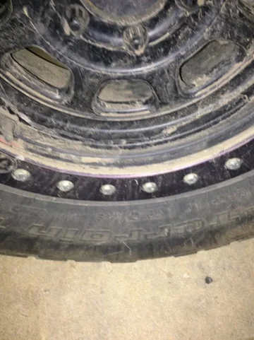

Recent discovery on the wheels, figured out when trying to order the fifth.
Gloatingly stated:
LT said:
Congrats you got yourself an elusive set of 3.75" TR rims
That ain't a good kind of elusive, at least not when trying to order a matching.
Think they're gonna rub? Bahahaha.
Meh. We have paved roads at the mall here.
Bahahaha.
Think they'll tuck behind the slim ring fairly well.
I've not dislodged the stem on these....yet.
First time they go, can guarantee the ring will get bigger.

How do you plan on airing up in the same time? CO2 bottle or compressor? My experience is CO2 is much faster but more costly to keep the tank full with bigger tires.
