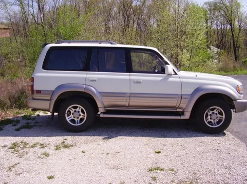

After a arduous search, I'll be picking up this 450 Wednesday from Missouri.
105k, two owner, elocked clean LX.
I'll add that I'm over budget.
Service is current, but no indication that hoses have been replaced or necessitated. I've not seen it yet, but will baseline all at Lexus of Tulsa, and replace necessary. I've history there, they've been instrumental in this acquisition and many others, and I don't mind paying a premium for a continued pedigree, in case flames were coming my way.
Concerned about a statement the owner made that he's never engaged the lockers in the 6 years, 40k he's owned.

Six years with no elock activation may require some work. Then again you might get lucky.
I'm prepared for delivery negotiations, if theres issues activating, but haven't attributed a figure to, yet.
Inevitably, they should activate with a little coercing, but if they refuse, I've no clue the cost to correct.
Any clues?
Nice truck. Looks unused.
Any clues?
This is exactly why I wish I had went with a unlocked 80 and ARBs instead.
I am not sure on cost for a total rebuild but that may be unnecessary. I have read at least one thread here where some elbow grease and time will get them back into shape.
If they're anything like the 8" elocked, then it may be a matter of engaging and driving a slalom course, but honestly don't know.
I hope it's a non-issue, but if it is, trying to have a legitimate basis by which to determine a dollar amount to negotiate to.
I've paid a deposit, and will be taking certified funds, since there's was an issue with PayPal or wire transfer on seller's behalf, and cash from which to work from, in the event this, or any other issue is encountered.
I have little doubt that it's been represented with complete accuracy, and he was quick to reply to my question regarding lockers with "I've never used in six years I've owned" and considering the owner previous to him was a 75 year old Floridian woman, I'm betting they've never been engaged.
I'll be shocked if they engage right away.
I'll be double shocked if they don't engage after a couple of days fiddling with them.

I had issues with the 8" rear elocker when I bought (used) too. It wouldn't lock unless I slalomed for a while. I regularly use, now, and it's engaged once a week, as a preventative measure, and locks quickly.
Hoping I'll get lucky.
Best of luck with the lockers. It is a clean truck. I am amazed at what your plans are for it.
