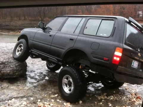

This looks like the PO of my truck's previous truck. The bumper was very tight which was nice but did not provide any protection and broke when touching a rock.
fjrohrs LX that I can thank for partially starting the migration from FJC to FZJ.
And also for the flare-less configuration. Hope I can get the white as cleanly plugged as the black.
We spoke about this last night but to reiterate.
This picture is misleading as the rhino lining is clearly visible in the daylight/not wet. I use Ice wax to keep it looking good and to prevent fade.
That being said I would not go the rhino-lined route as the product is thin and brittle. I would go with line-x if I had to do it again or would paint them.
