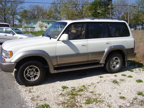

My advice to the other new guys is to request a day long inspection time. If nothing else, it'll allow enough time to know what will be involved to build to expectations. Mine are lofty.

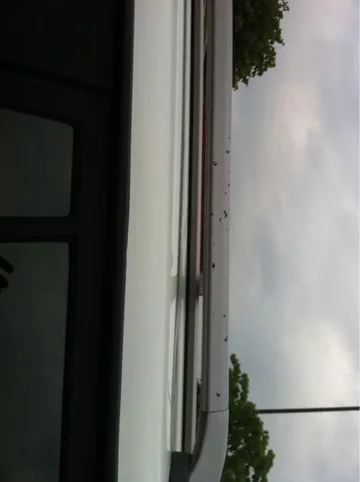

Will begin tearing down next weekend, I hope, if I can get a decent handle on the PM (already a call into Beno) Removing all the exterior components that won't be permanent, and gutting the interior in preparation for plugging the holes, removing sunroof, and lining the interior.
Going to be a lot of work. Any input is appreciated.

Going to order the hoses, fan clutch, possibly gears, and freshen all up. Start removing the flares and others. Hopefully, determine lift and install, then to OKC (I hope, price determining) for plugging and sunroof removal (it's coming out. Prevent a future issue, and lose 30lbs, or so).

Planning to delete sunroof at the same time as roof rack, spoiler, flares and cladding.

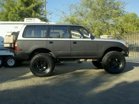

Lining the roof white, doing what's possible to be done on the remaining white paint, and lining the sides, just unsure if it'll follow the flare pattern shown (Fireguy's) in a similar color
Or doing the whole side (sorry to whomever I'm not giving credit to) in tan like this.
You already know I'm crazy. I'm considering this when under the knife.

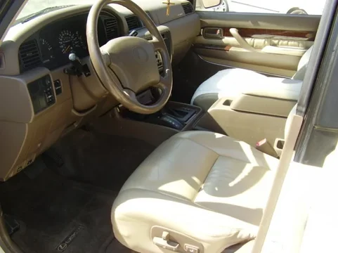

Hoping to strip the interior, apply deadener, weld it all up, line x, then go from there. Hoping to two piece a headliner and raising the front where the sunroof cavity was. replacing front windshield and gasket, gasket for rear window, and going to find the window sills ( bottom of window on side) to swap at the same time. Also, whatever the hell it takes to get leg room. I'm not a contortionist, and feel like one driving.

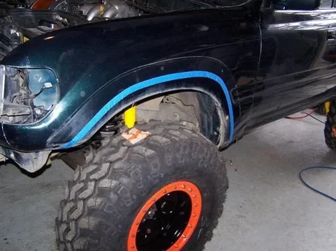

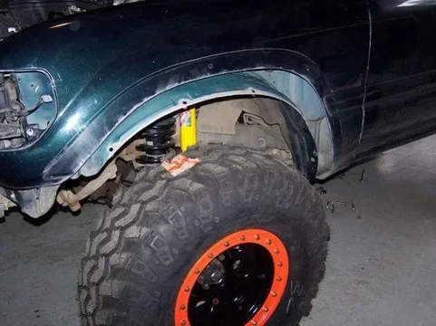

Delancy, mind if I ask if there is a thread you got those last fender chopping pics from? Would like to see more. Never really thought chopping was for me, but that looks good!... for way down the line.
That's from Mark's (helocat here?) PP80. Thread had CM06 in title, so old. Will try to find a d link.
Here's the end result. 4" lift with 37s.
