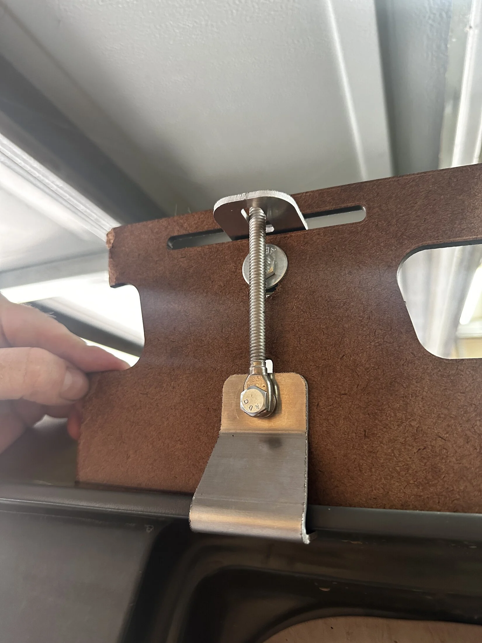

Modified the revision a bit, increased the height and revised the clamping hooks. So far coming up with off the shelf hardware for clamping hooks is the biggest challenge.

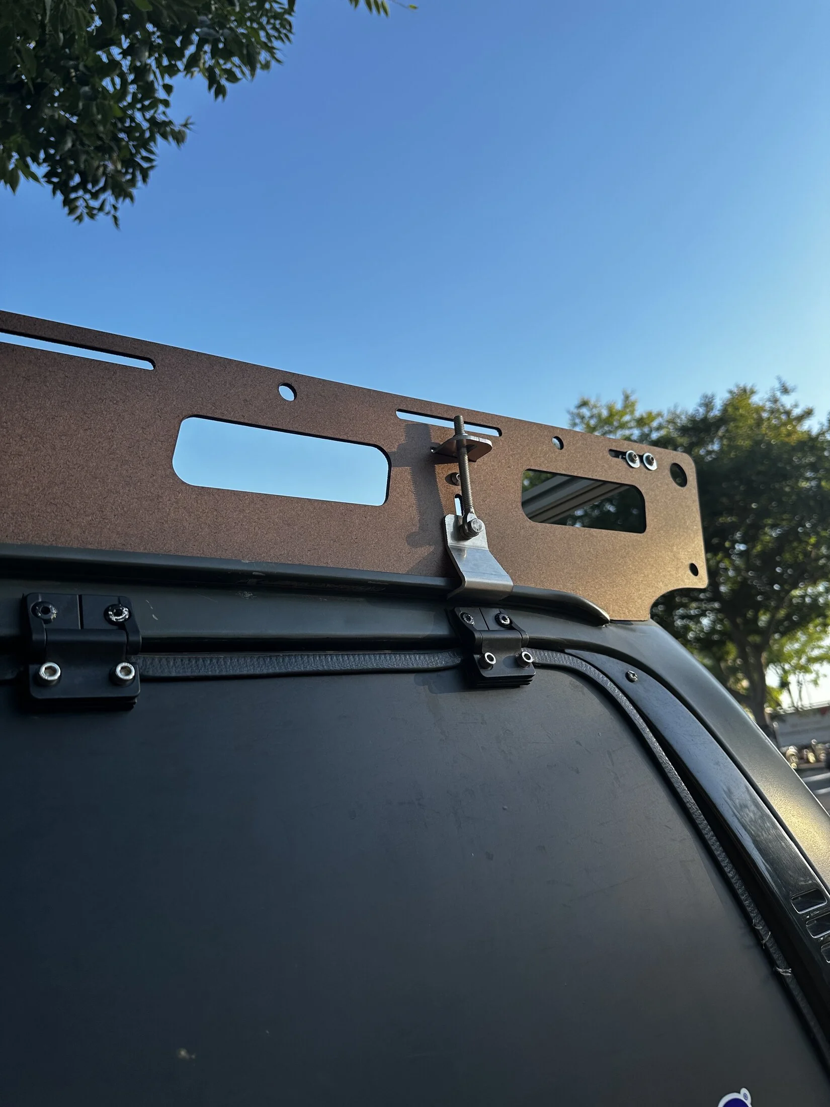

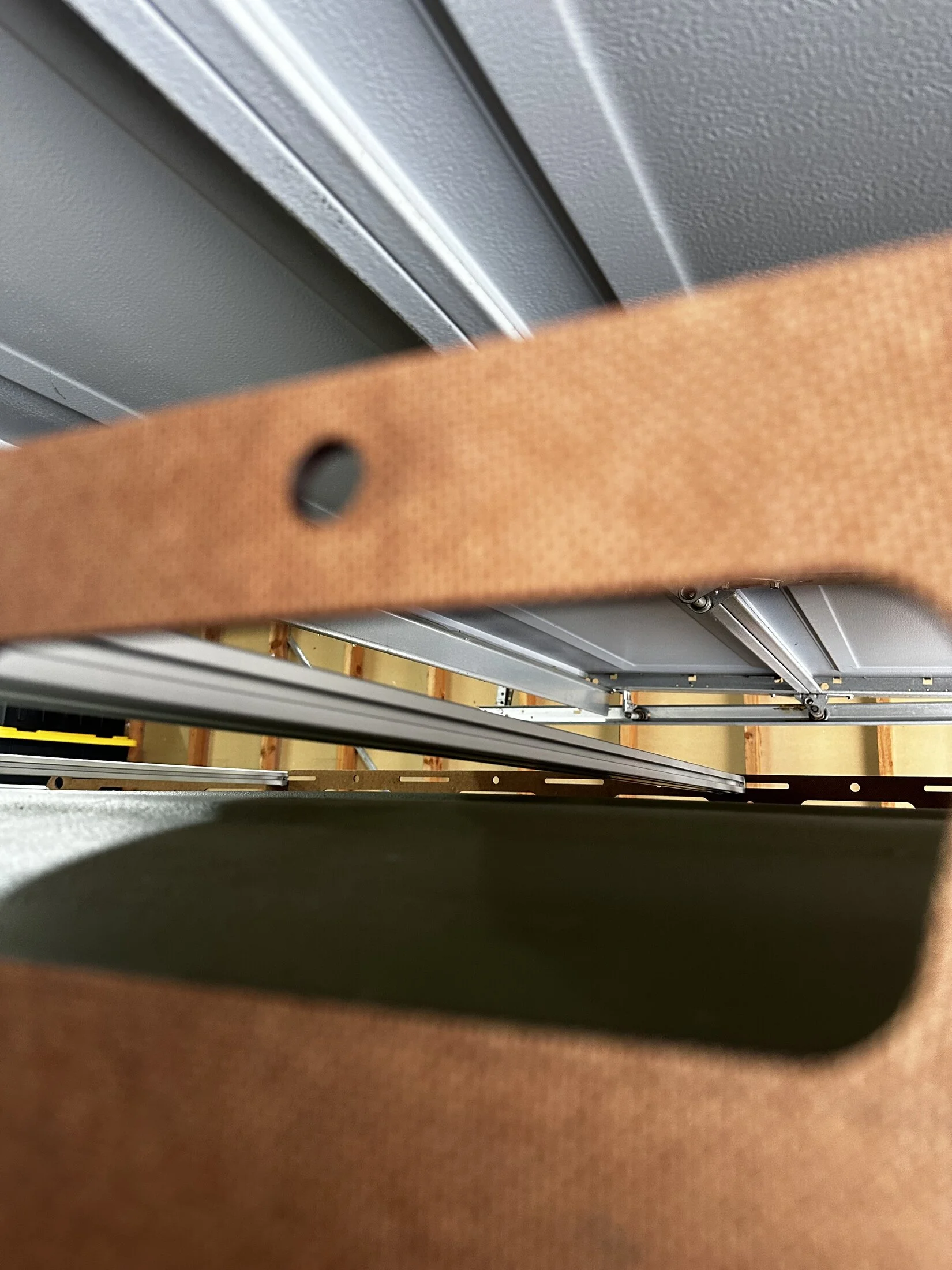

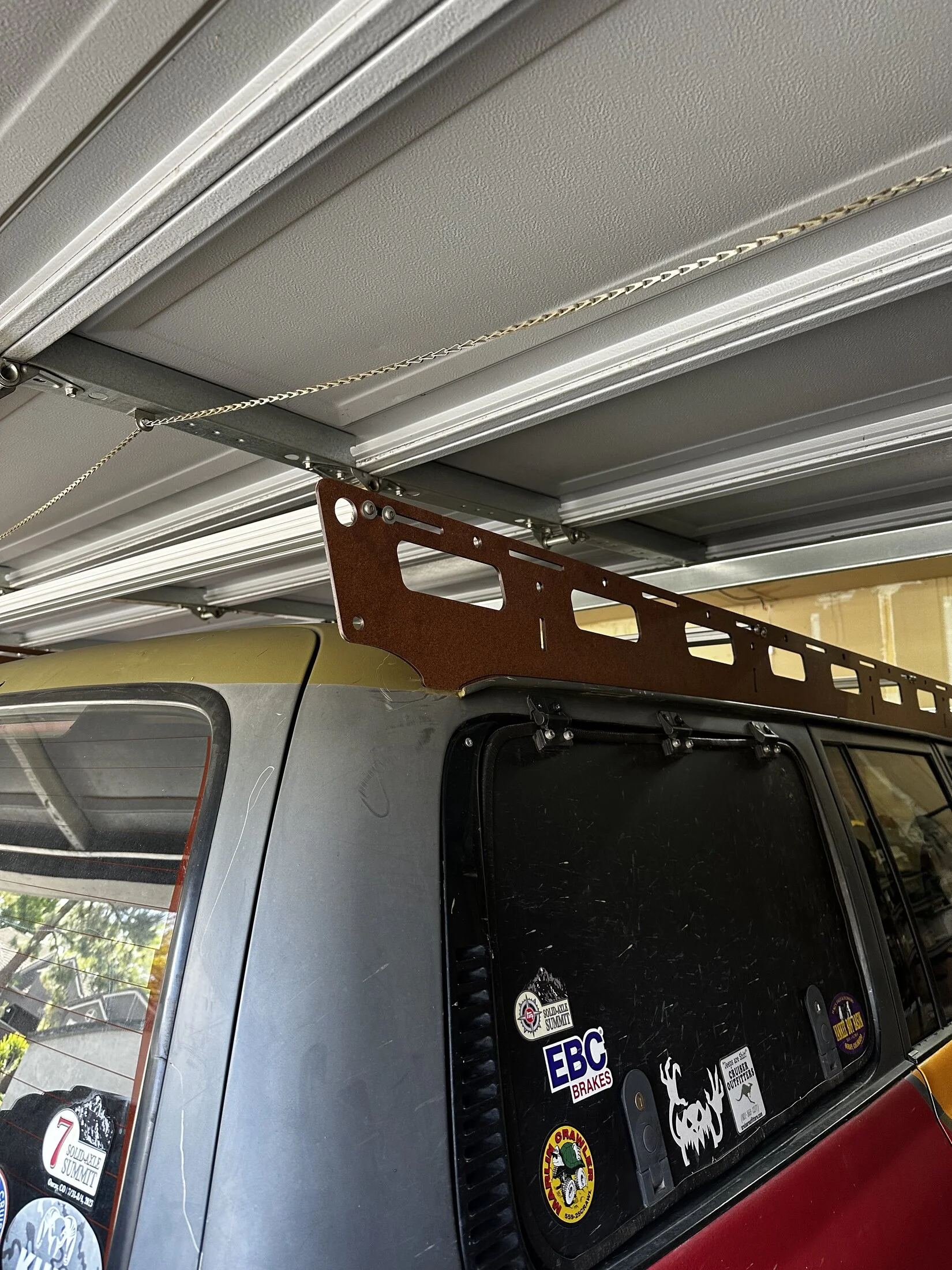

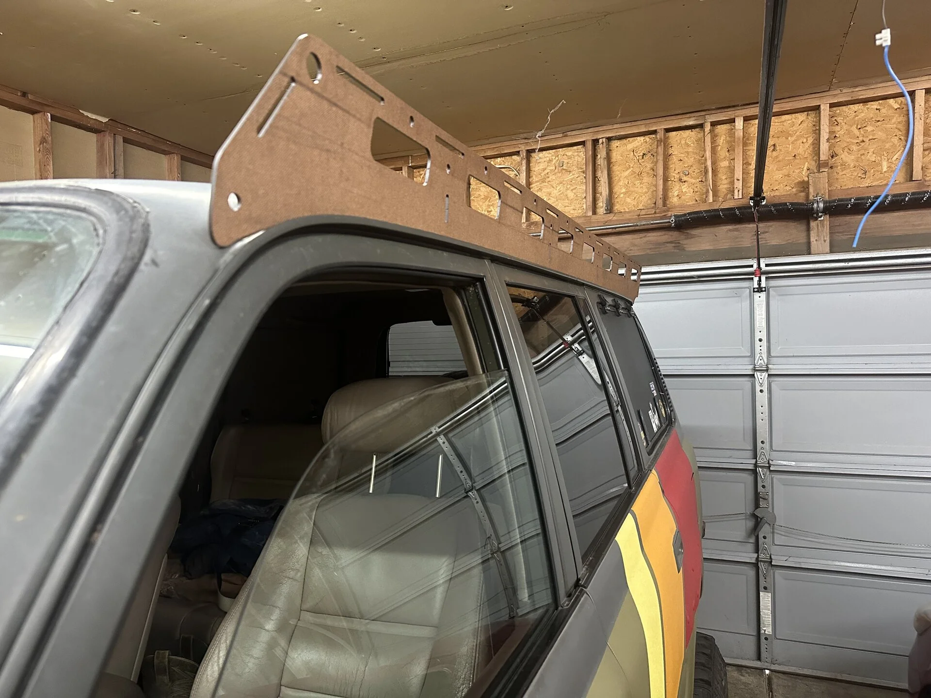

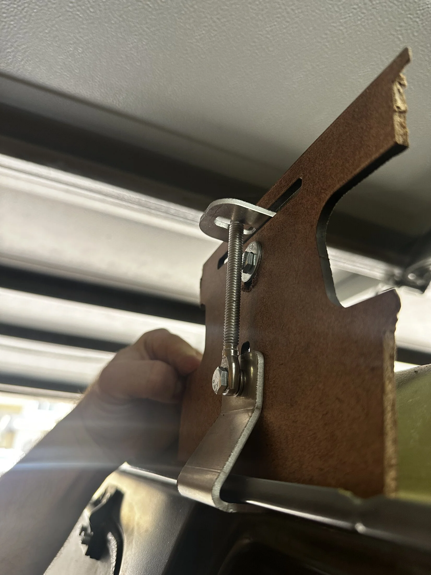

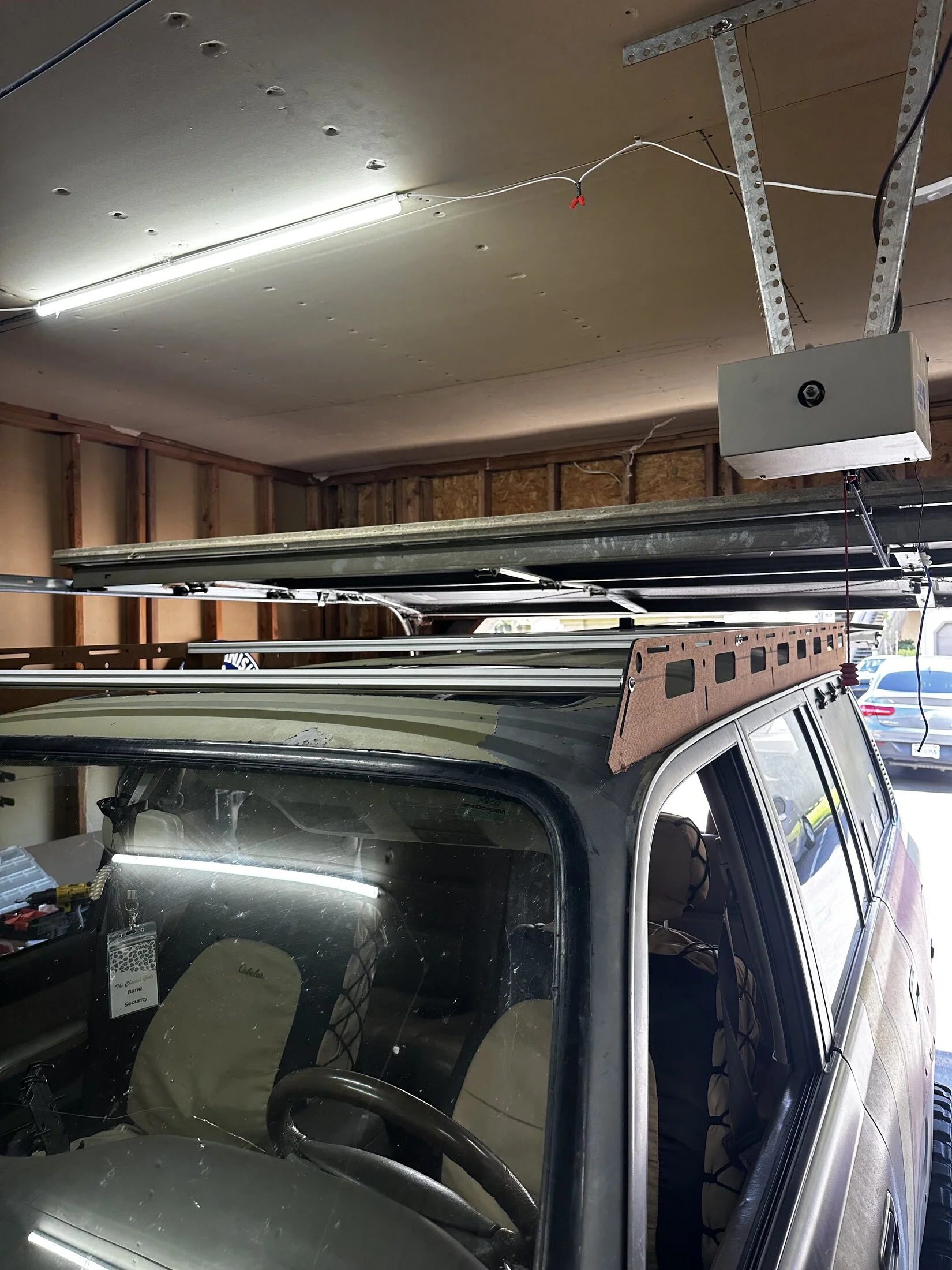

Here’s a masonrite template for fitment. Looks like the rear is too long, I don’t have a factory spoiler installed but those who do, might run into issues.
Progress update 3/4/24

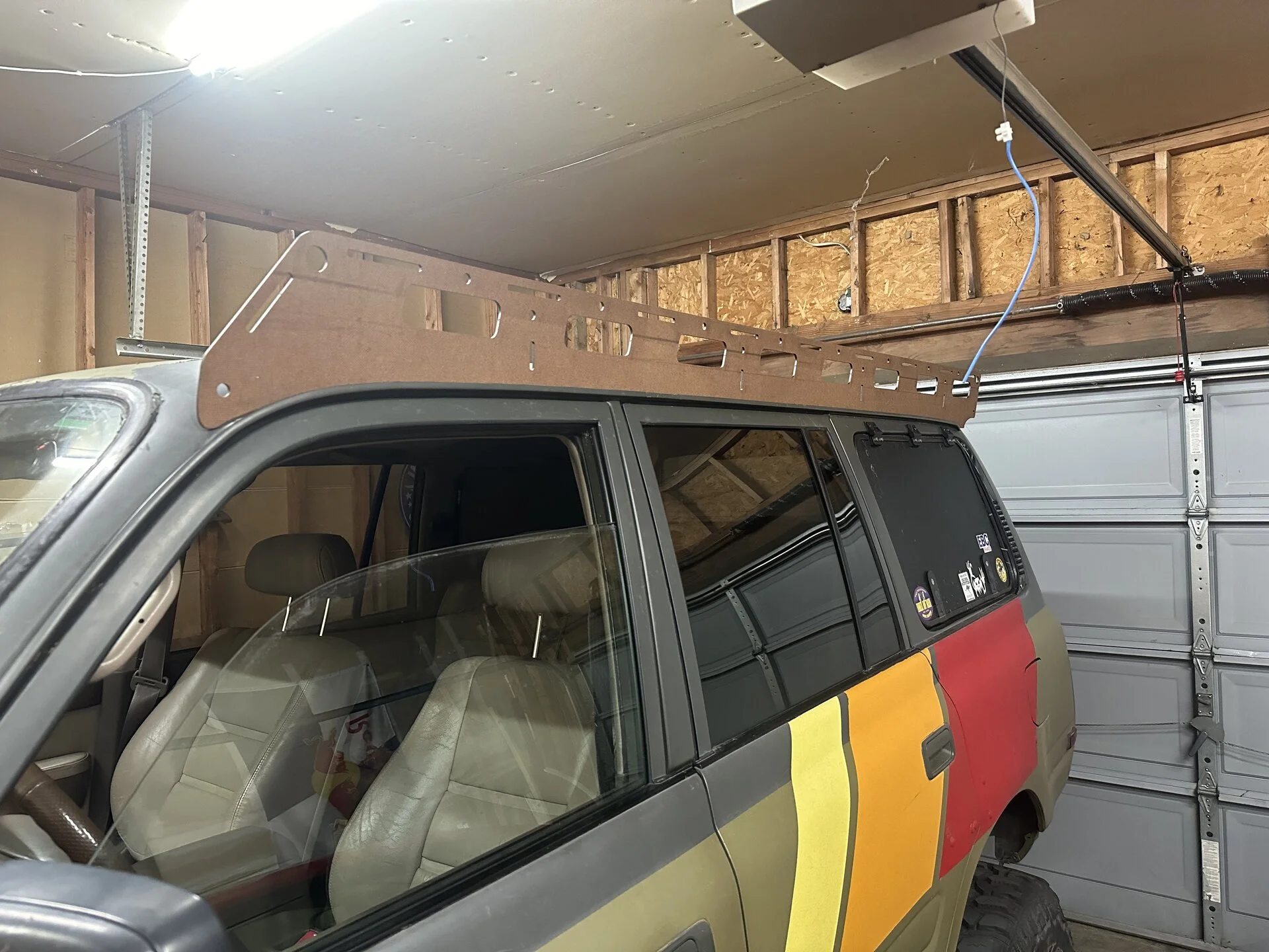

Reason height is increased? I'd prefer low and tight to fit into my garage with 37/38s......thats just me.👍
Yeah I’m in the same boat. I thought I would need more height for the gutter clamps but that’s no longer the case. I’m going to take about 1/2-3/4 off the total height.

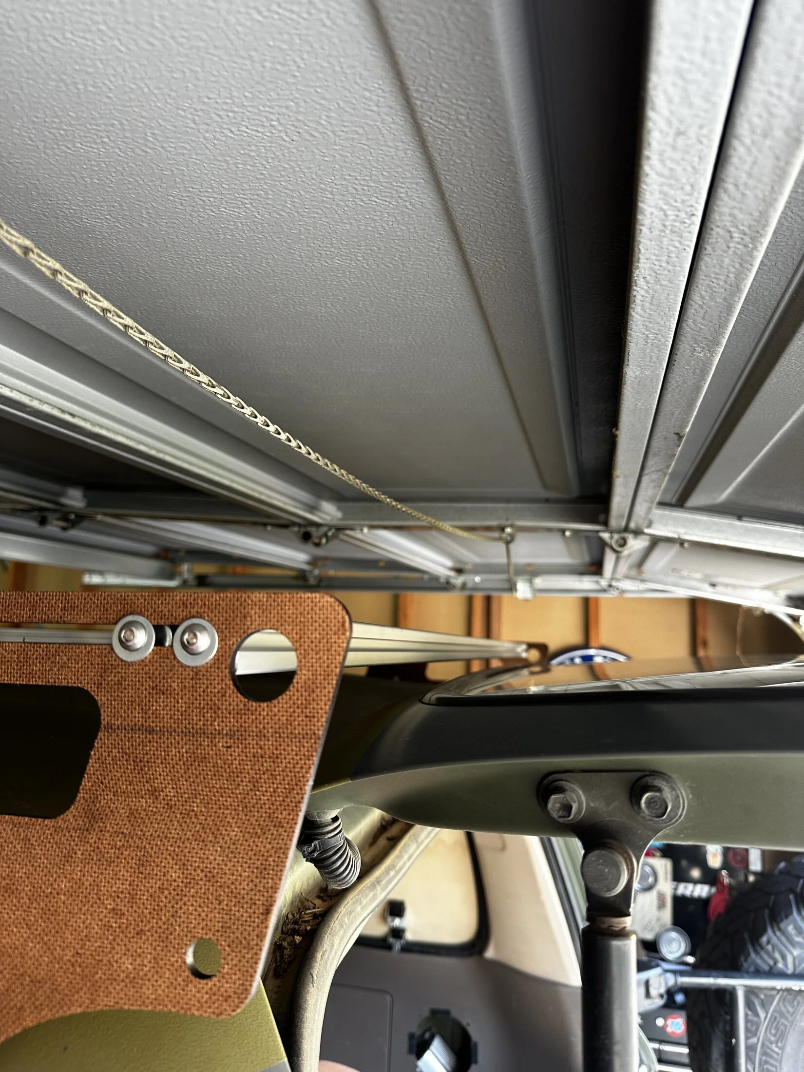

Do happen to have the rear spoiler on your rear hatch?
No rear spoiler on rear hatch

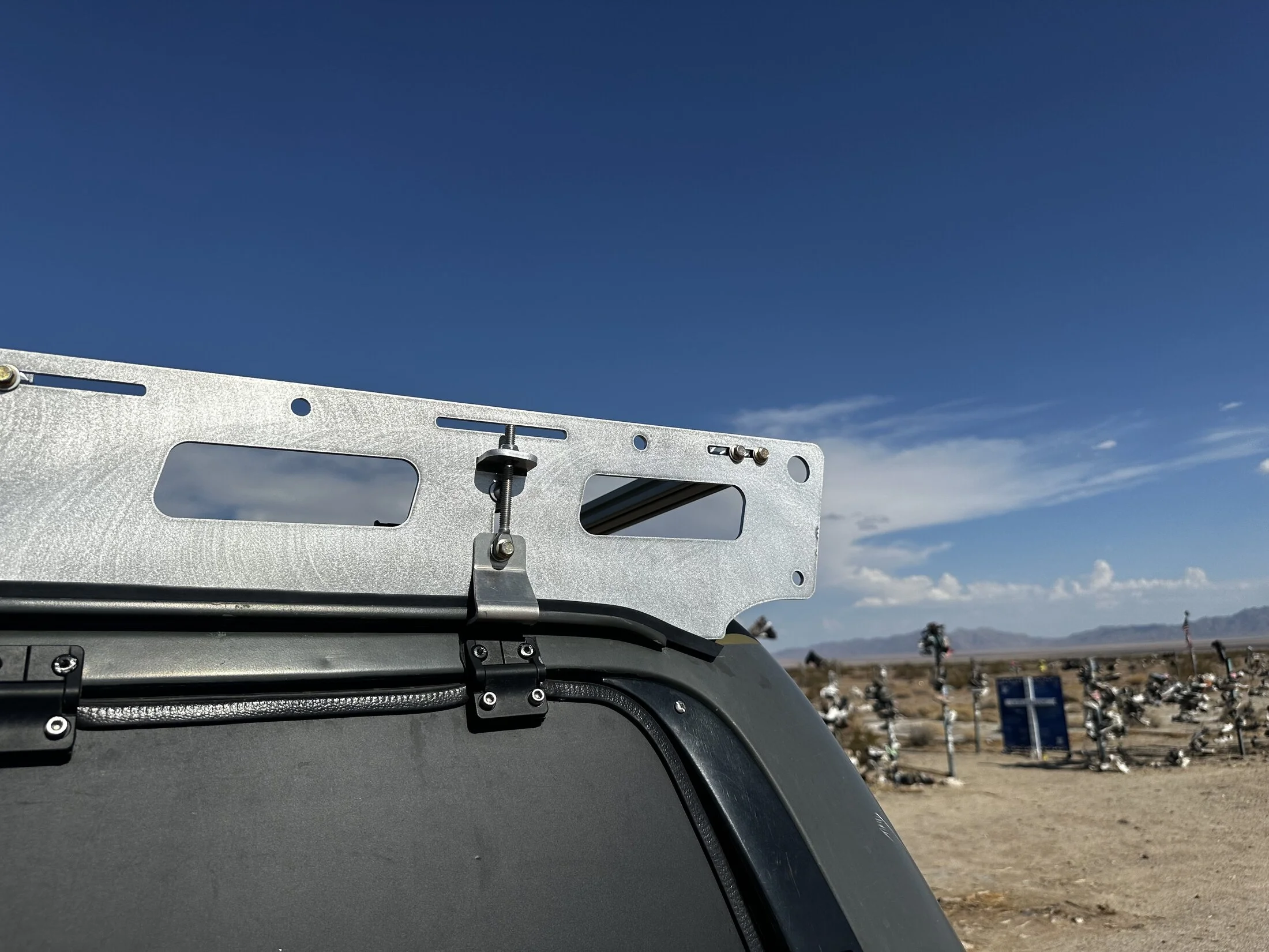

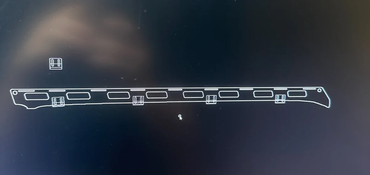

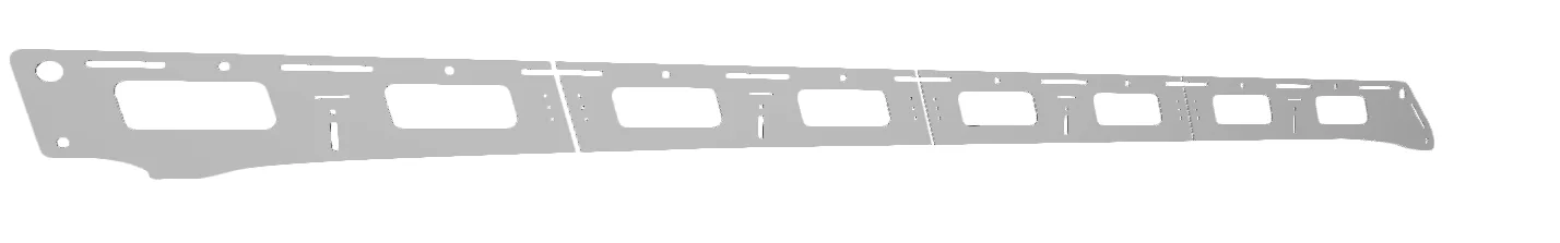

Still working on the rack. The hardest part is the attachment to the railing system. I’ve polished out the side rail, can come in 3 lengths,
Half rack
Full tack
Extended rack (will not fit with hatch spoiler)

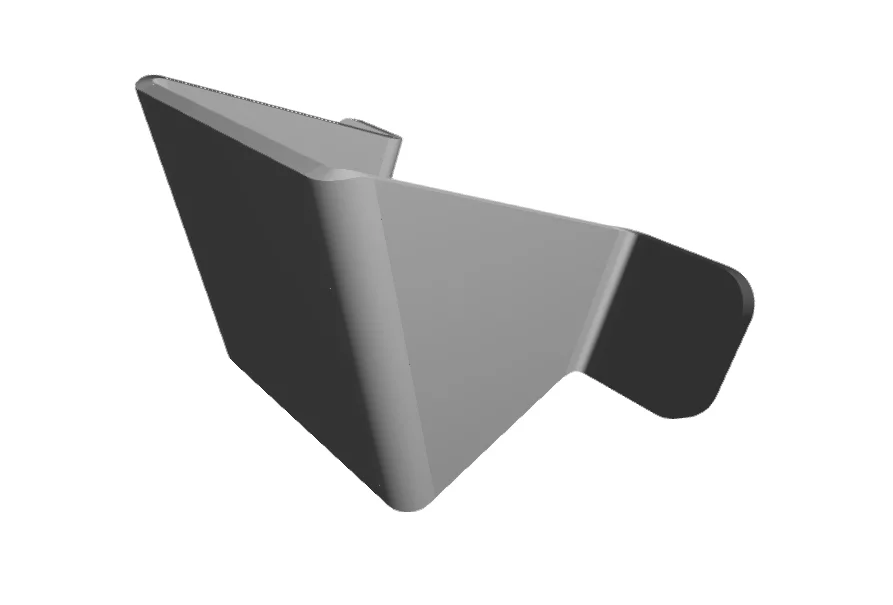

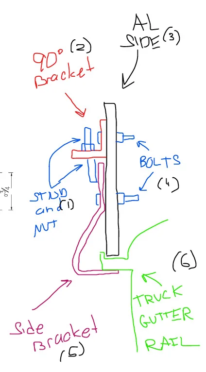

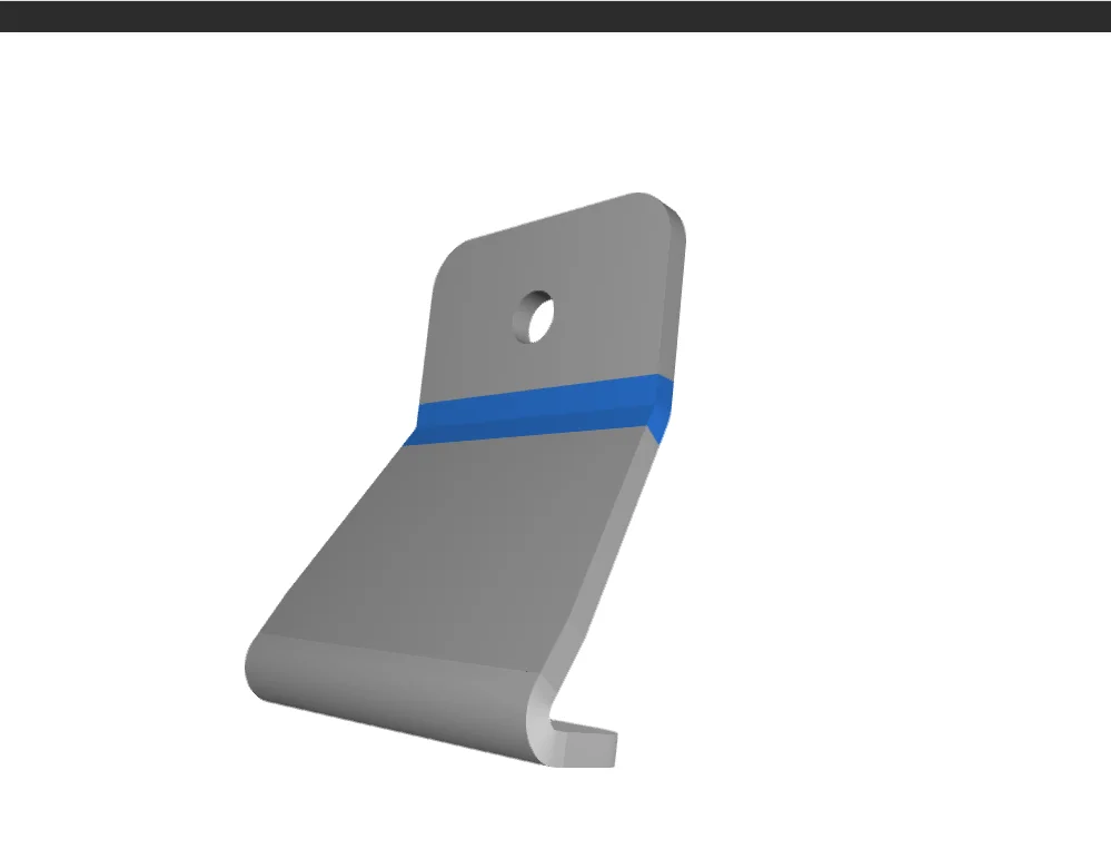

This is what I’m doing for the gutter mounts, basically a modified con-ferr design. Keeping it simple.
Modified the design a bit to avoid welding, as that add expensive labor hours.

Currently, I've got the side rails at 3/16th out of 6061 T6 aluminum,

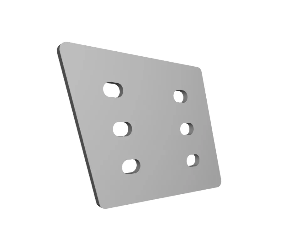

Backing plates for joints are 1/8 of 6061-T6

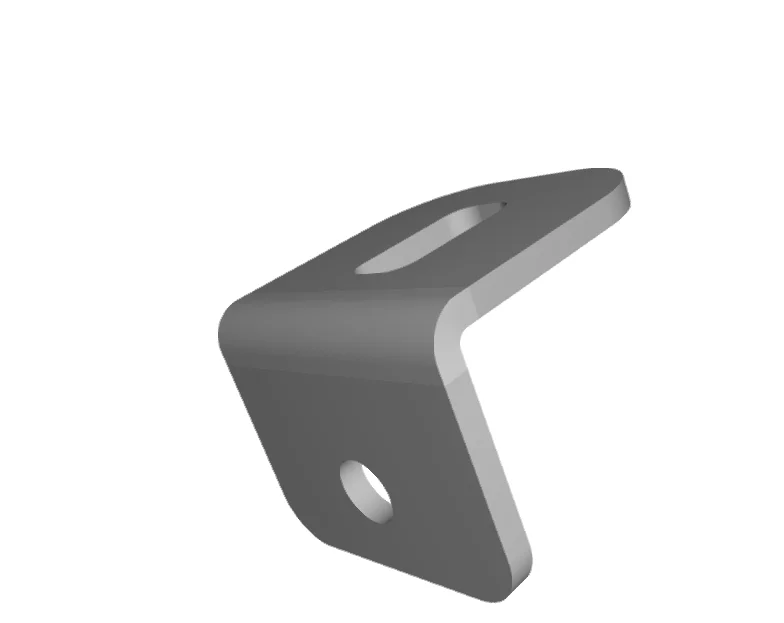

Brackets are 1/8 of 5052-H32

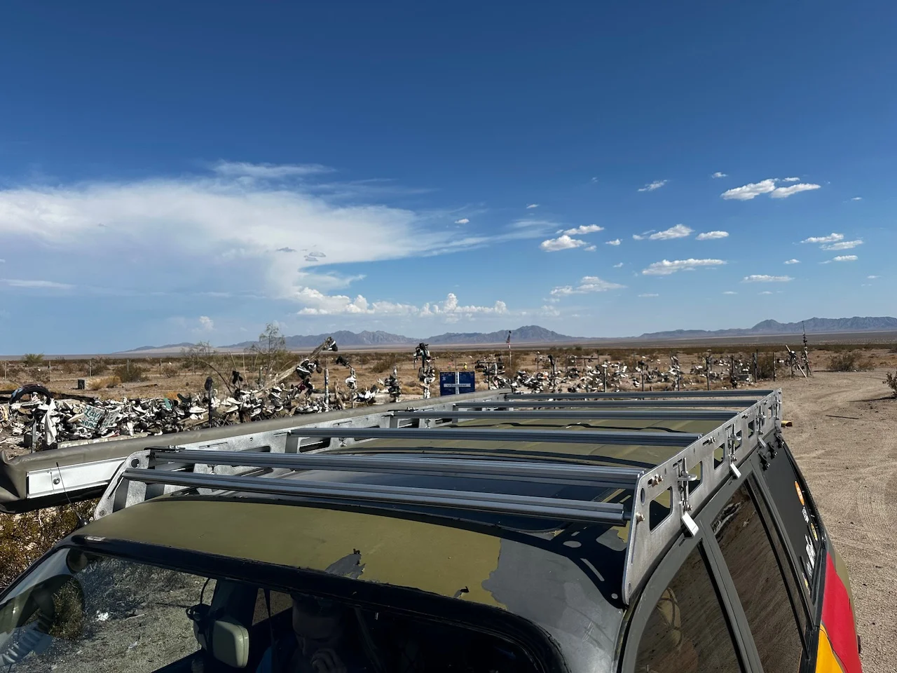

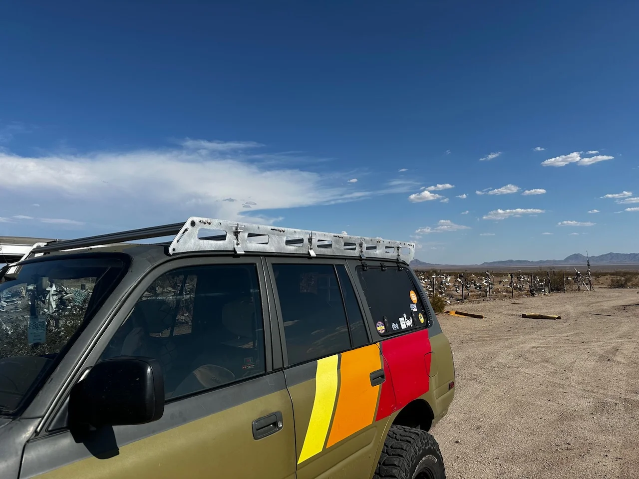

Ran new aluminum side rails for a week in San Juan mountains. Few discoveries:

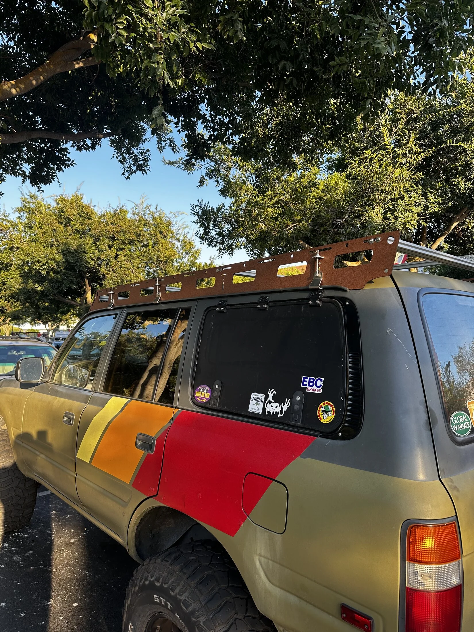

The front is too short, definitely need to make it 5” longer, otherwise it looks kind of funny.
It also appears you cannot have a straight line from front to rear on the gutter rail, unless you have a bend in front and back. That appears to be because the roof/body is actually convex horizontal as well as vertically.
The curvature can be improved a bit, I will relief some areas on the front and rear of the rack to make it “hover”.
The roof rack is 52” wide, I had to shim by 51” 8020 hehe.
The 1/8th 5052 gutter brackets worked fine, but I think I will I’ll upgrade them to 10G stainless to make sure they don’t bend. The 3/16 90* brackets are plenty strong. I do want the roof rack to give before you bend the body of the truck by wrenching on it too hard.
3/16 6061 profile is plenty strong, but the number of standard cross rails will increase. It feels a bit too flexy when walking on it.
Can we get a further out side view? I think the shorter front looks good in these pictures. Great work!
