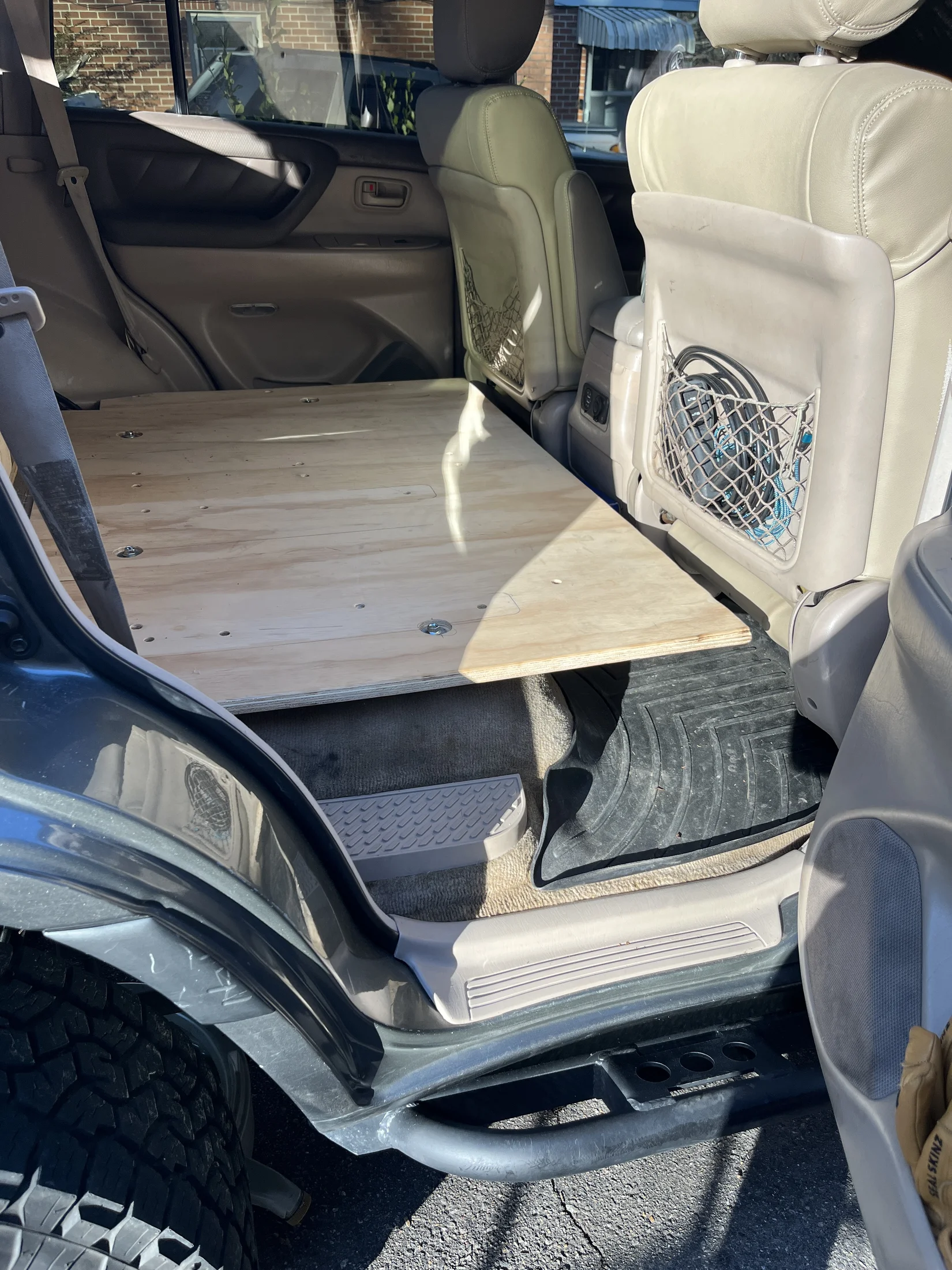

in my 100 i removed the middle seats for a trip out to MOAB this year. Used a 3/4" piece of plywood and bolted it down to the seat anchors. end goal is to wrap it with outdoor carpet and thru bolt tie downs
FJ62 but same concept. I did this in my 4R about 15 years ago and it worked so well I did it again in the LC. Fits all my recovery gear plus a lot of other random stuff.
