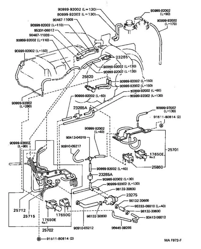

I've found the first hose but cant seem to find the item # for the hose on the left.
Several dealers have online parts sites with the Toyota parts diagrams on them; Olathe and McGeorge Toyota come to mind. @beno can get them for you, if you don't want to do the work yourself, and he probably has them in stock.
