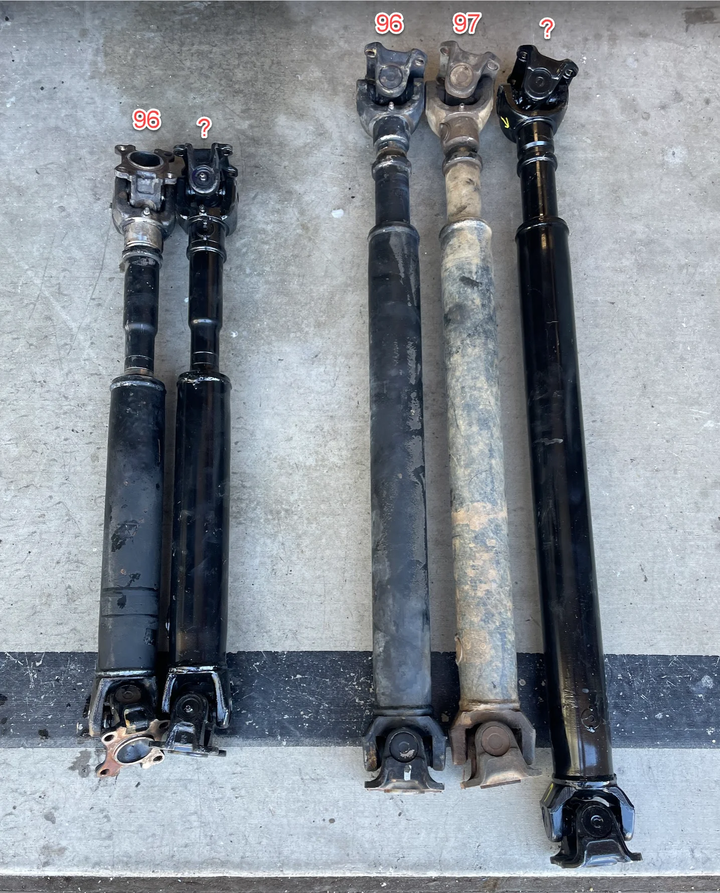

Quick question, do the 3FE and 1FZ powered 80s have different length rear driveshafts?
I have the ones from both my 96 and 97 matching in length, but the spares I picked up a while back match on front length and are longer on the rear. I am having Tim at Precision Products rebuild the ones that need it, and the whole point of having spares is that I done have any downtime. Guess that plan got blown. I have Tim shorten the spare to match length.

The early 80's don't have a viscous coupler, so the transfer case is shorter.
Trucks without ABS systems have longer shafts.

The 80s with the vicious coupler transfer cases are shorter than the older non-vc ones. I can’t remember the years, but i bought a set used and found the same issue. I had my local driveline shop shorten it and all was good.
