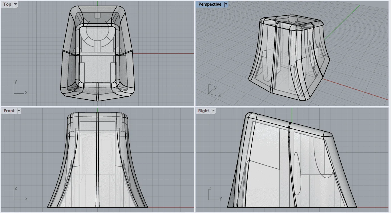

i'm working on designing a cupholder mounted where the ashtray pullout is right now! Hope to have a test print in a week or so.

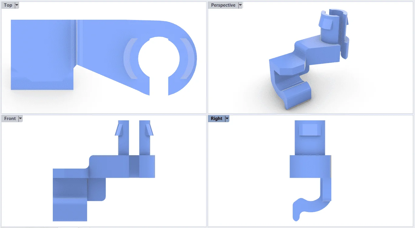

here is the little clip in the door handle. i’m planning on doing the other one at the handle but also that little plastic collar that comes with the tumbler. if anyone has a busted one of those or a tumbler with it i can borrow i’d be interested.

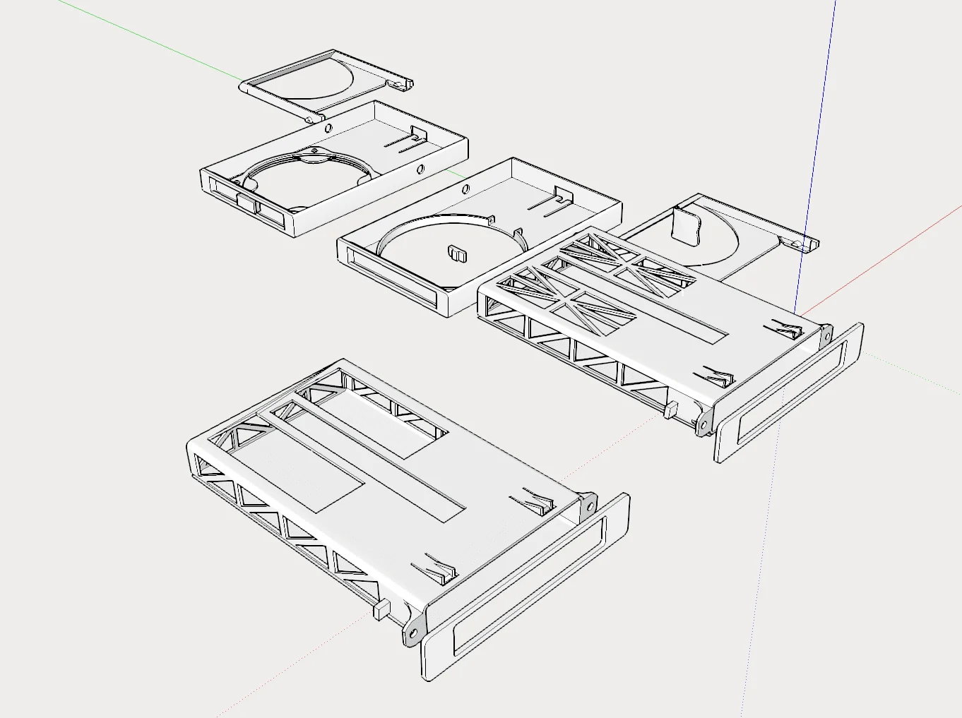

Here's an old phone pocket cupholder I designed in high school. (before I had my license even!)
I printed a test version in PLA, it screeched like crazy and its strength didn't inspire confidence. It would support the 1L Nalgene it was designed for, but a major hit with a full bottle would've probably snapped the drop-down support piece. It also doesn't have the push-in, push-out convenience, just used a little knob and slide with a slide stop. (I was lazy)
Nowadays we have PET variants which would work WAY better for noise/strength, although carbon fiber nylon might be necessary to support a full Nalgene, especially so it doesn't creep under the heavy load in 150F+ temps. Or maybe print holes in the corners to press in lengths of 1/16 welding rod.
Also, it was modelled in Sketchup... those were dark times. Definitely won't be doing that again.
Next time I'm up late with nothing to do I'll see if I can remodel it in Solidworks with the push-in push-out and a beefier bottom support. I'll upload it to thingiverse when I do.
(Also, now that I'm experienced to know layer adhesion strength isn't an issue, I'll make it print standing vertically so you don't need to remove a ton of support material-that's why I had the "truss" structure down the sides, to help me poke out support structure)
