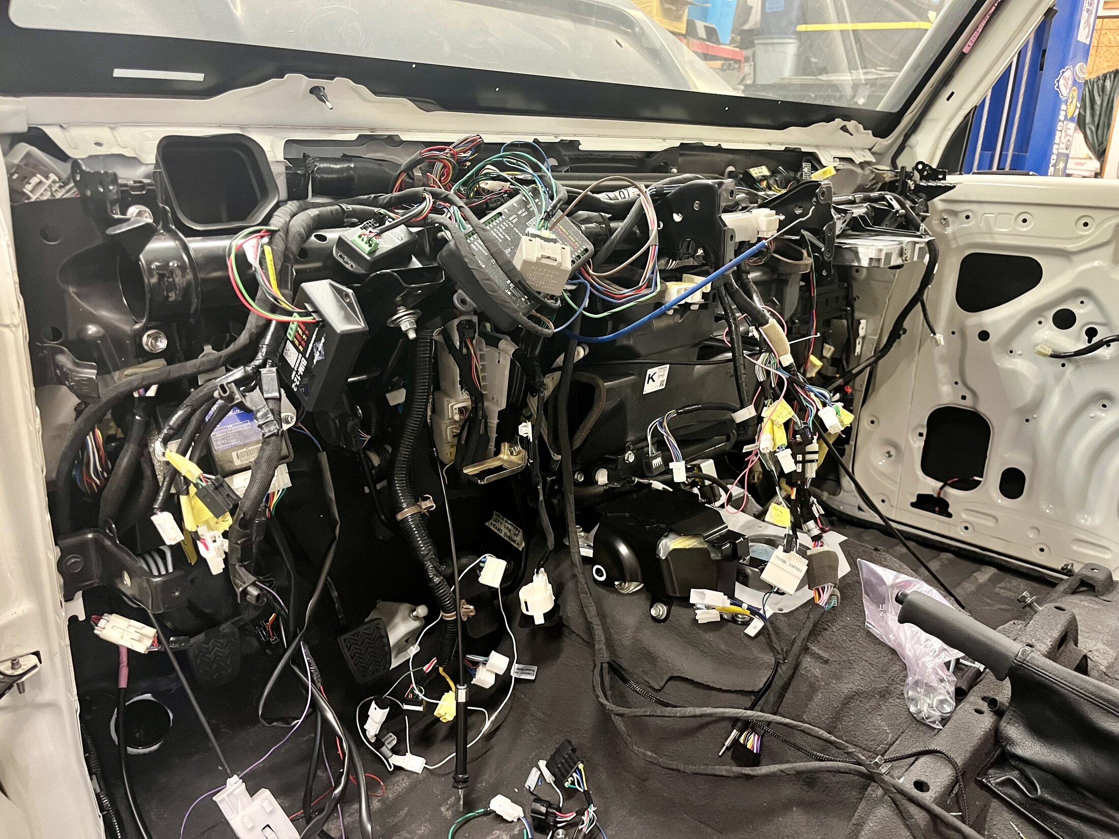

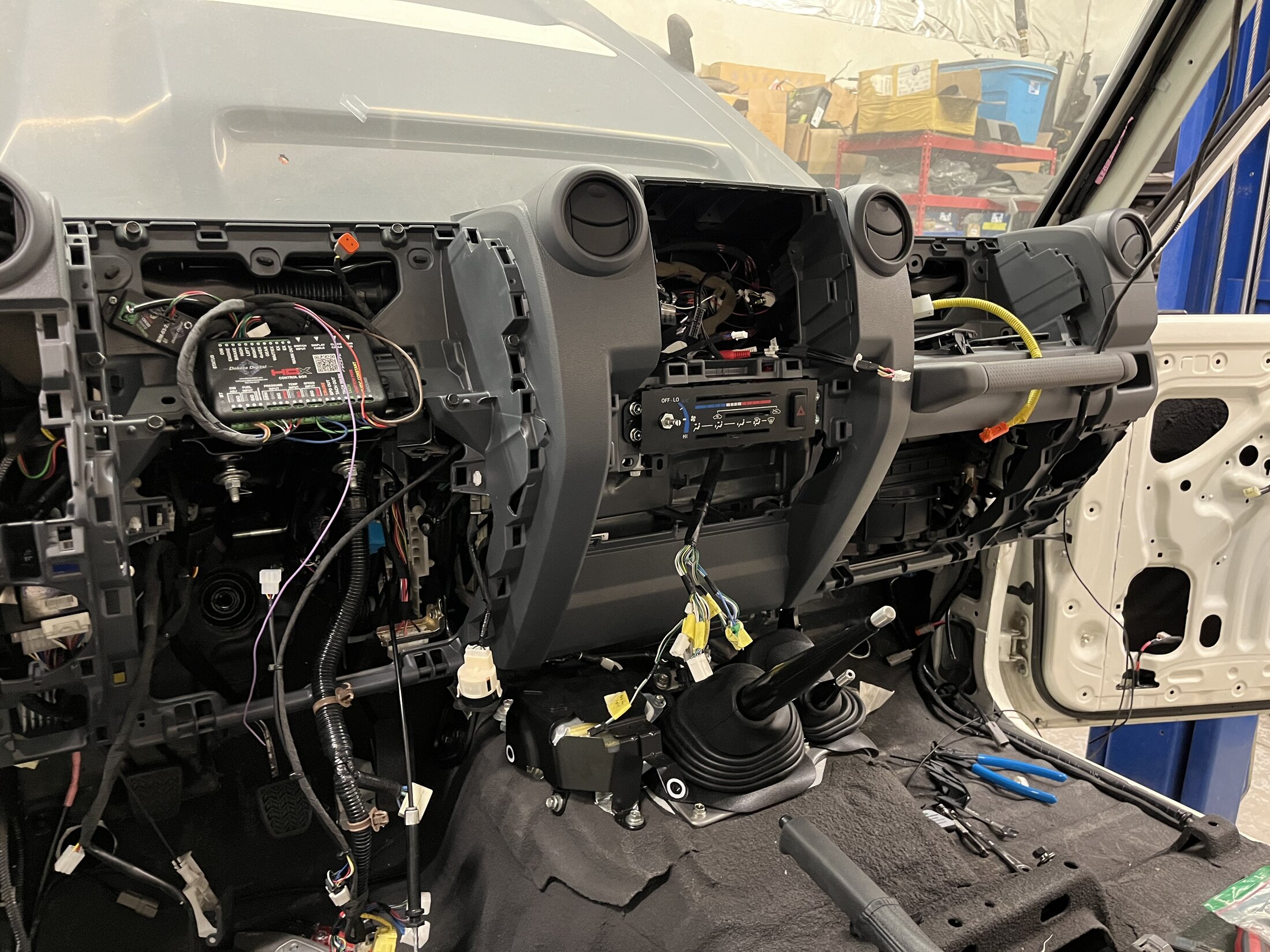

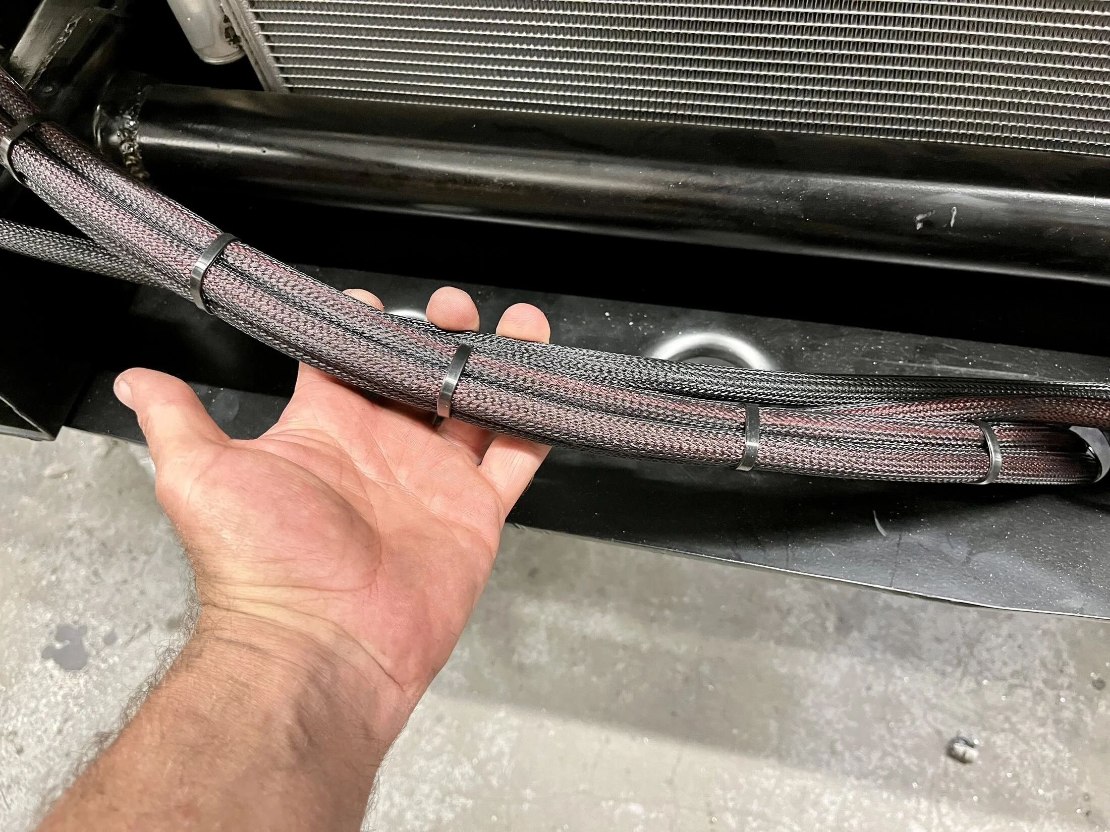

Our final pull of the dash, wiring harnesses now being finalized and wrapped before the final install of the dash.
Cheers

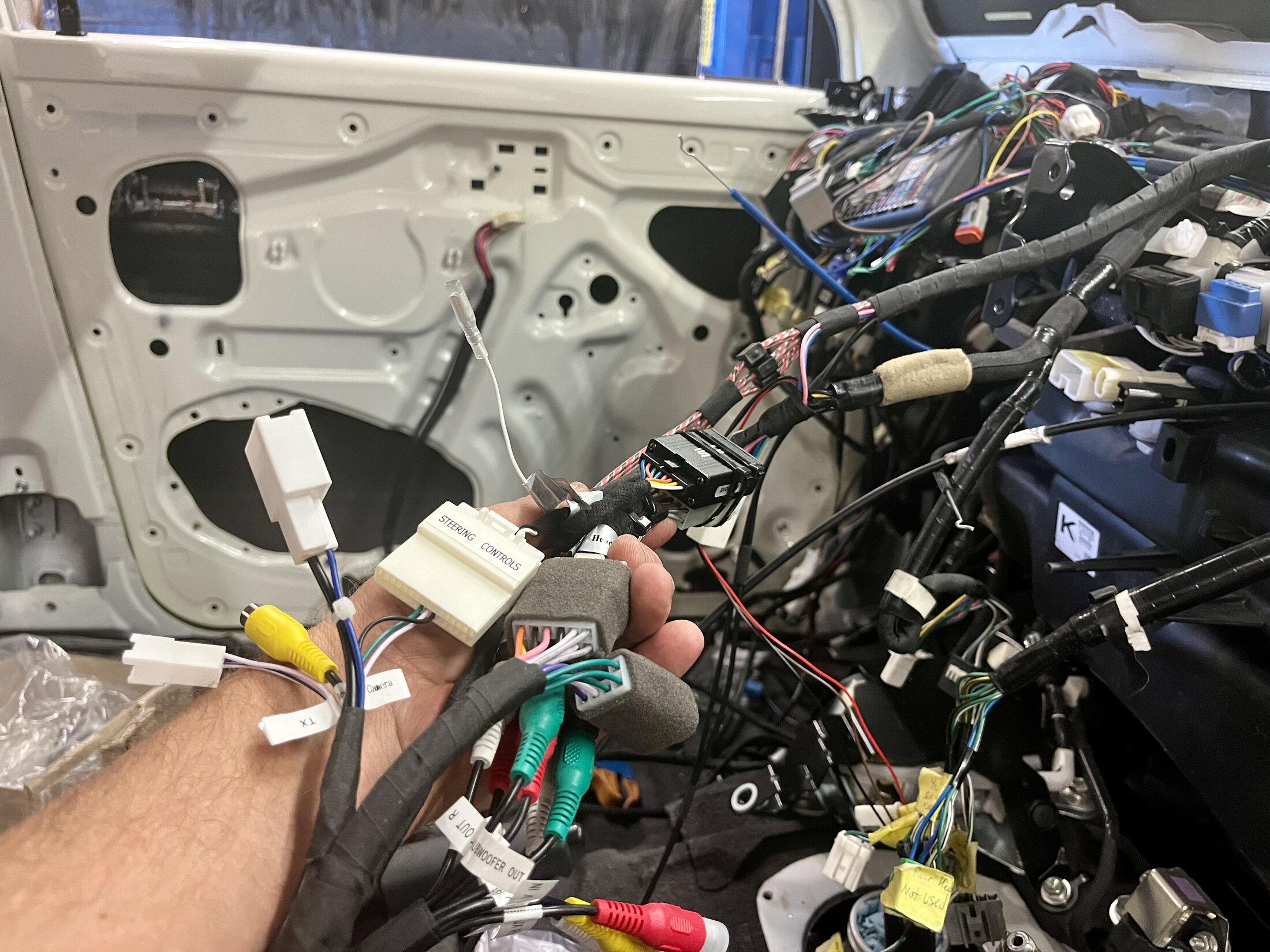

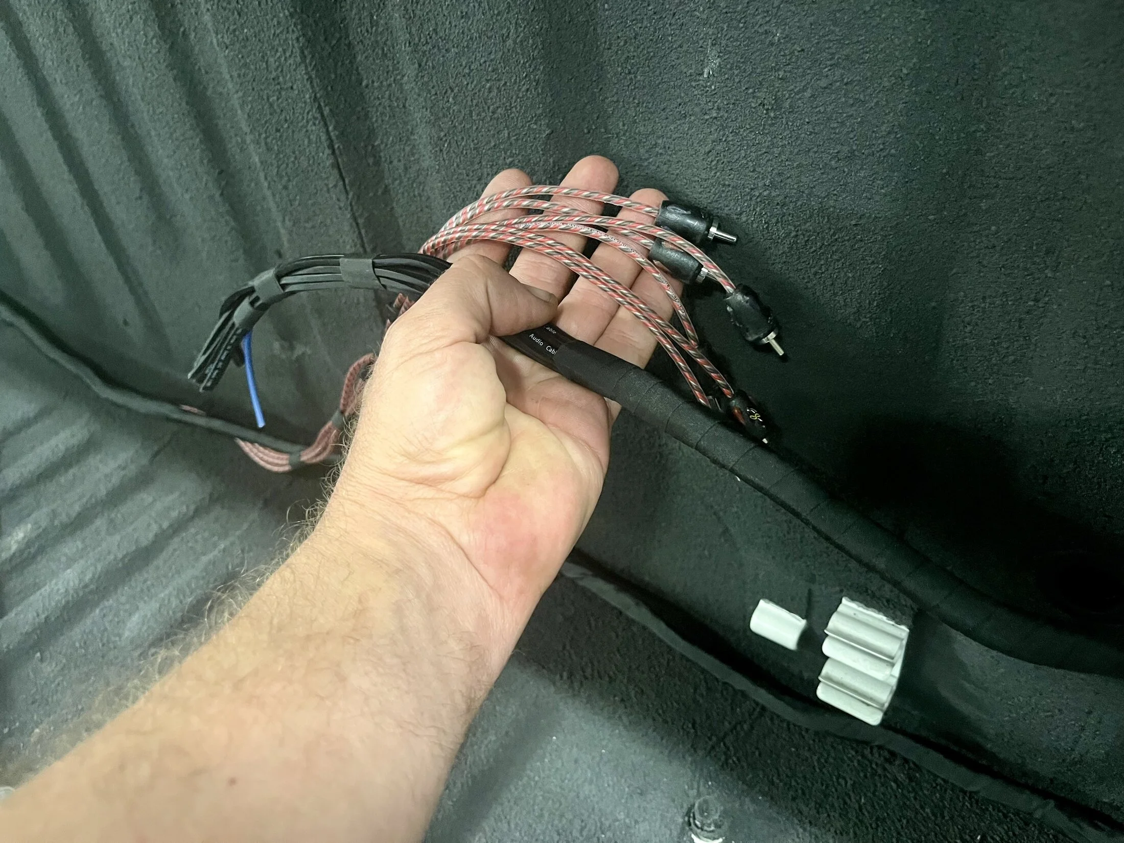

Stereo stuff. RCA cables ran and speaker wire to all four doors ran, harnesses wrapped.
Cheers

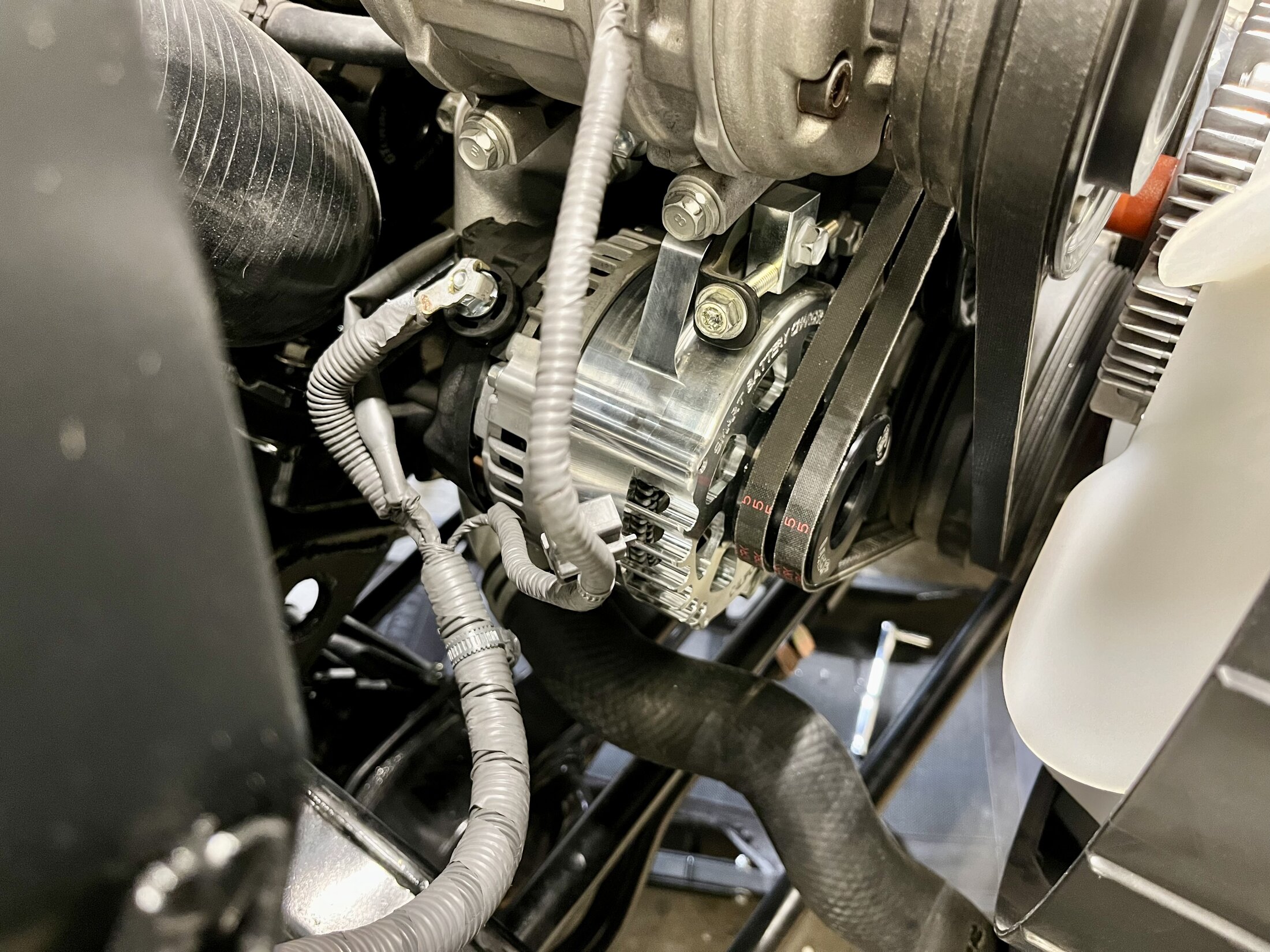

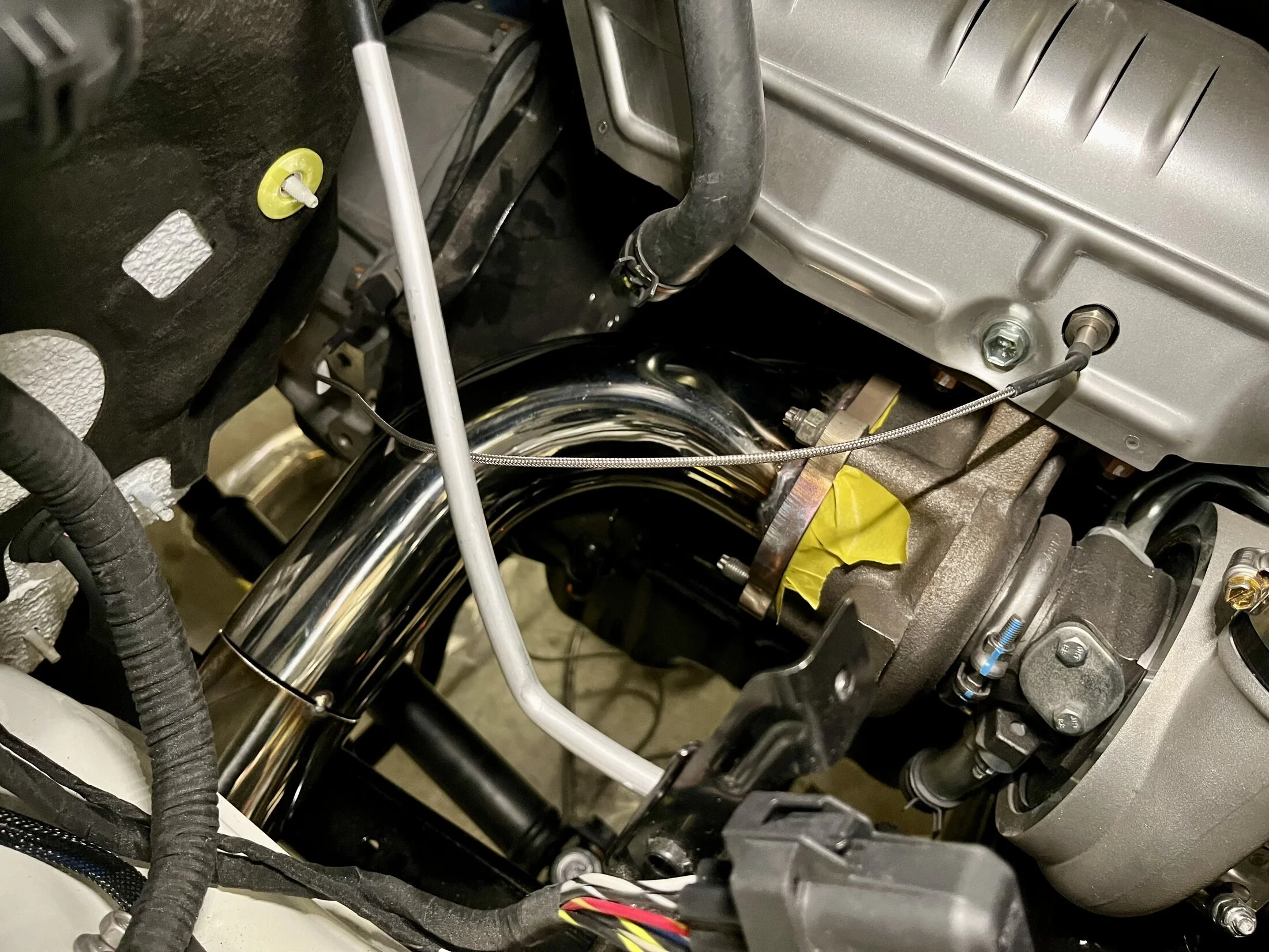

Lots going on with this build. More pics to come but I forgot we got this M2K 180amp alternator recently. Super nice.
Cheers
fu<kin sweet

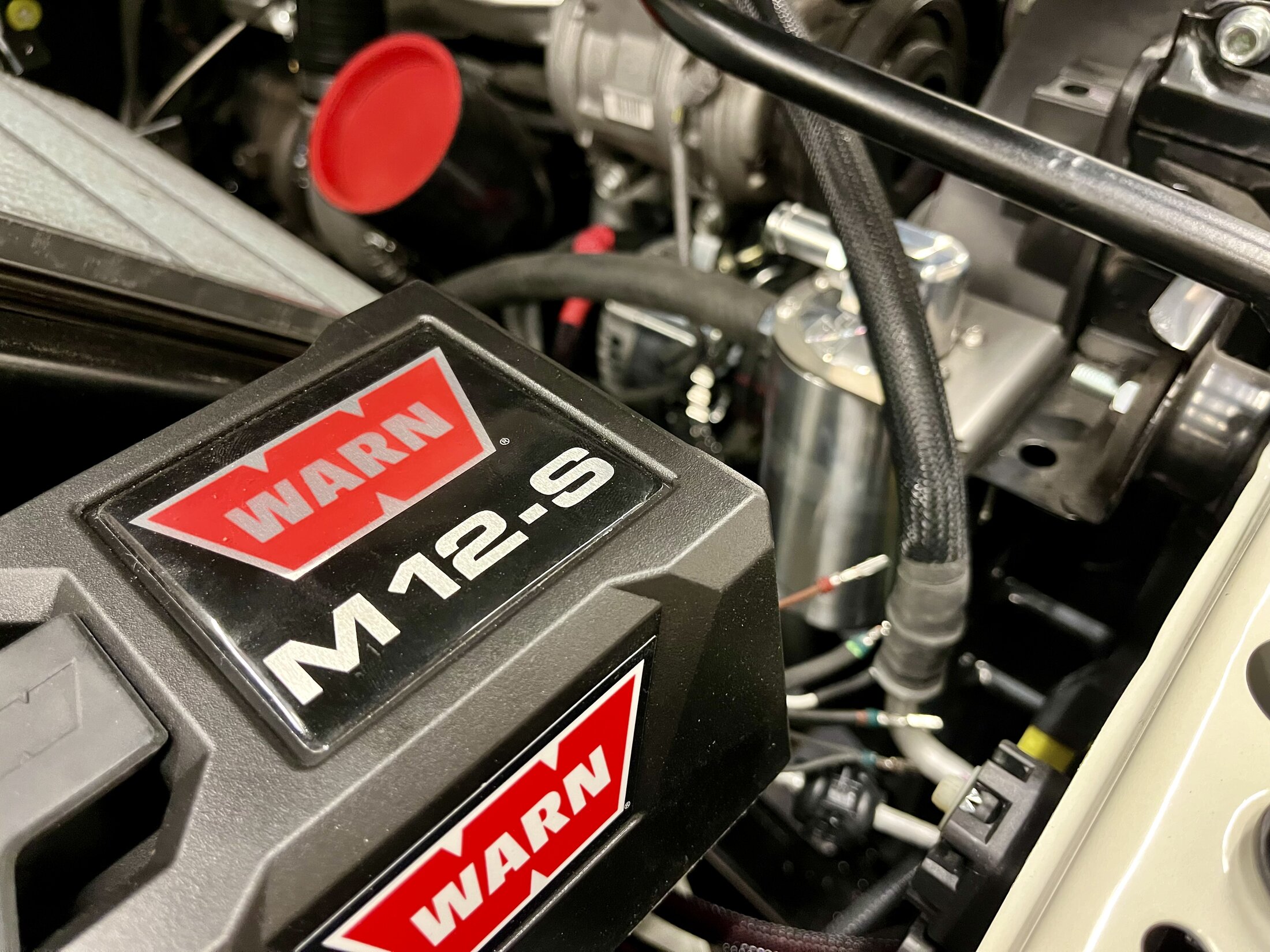

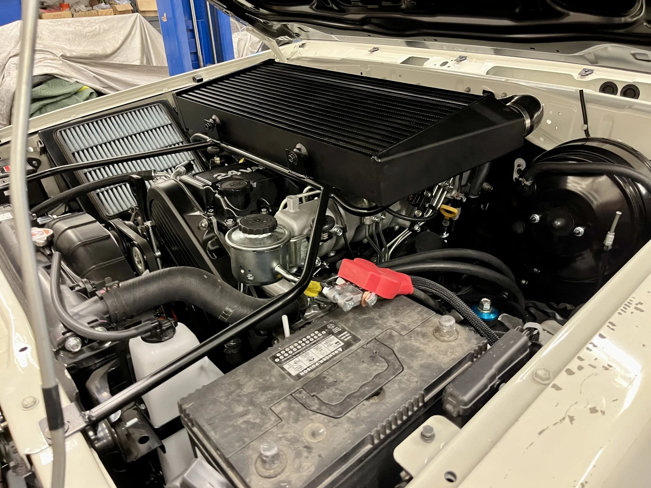

Remote mounted the winch control box under the hood, here is our harness for that.
The winch control box and catch can mounted.

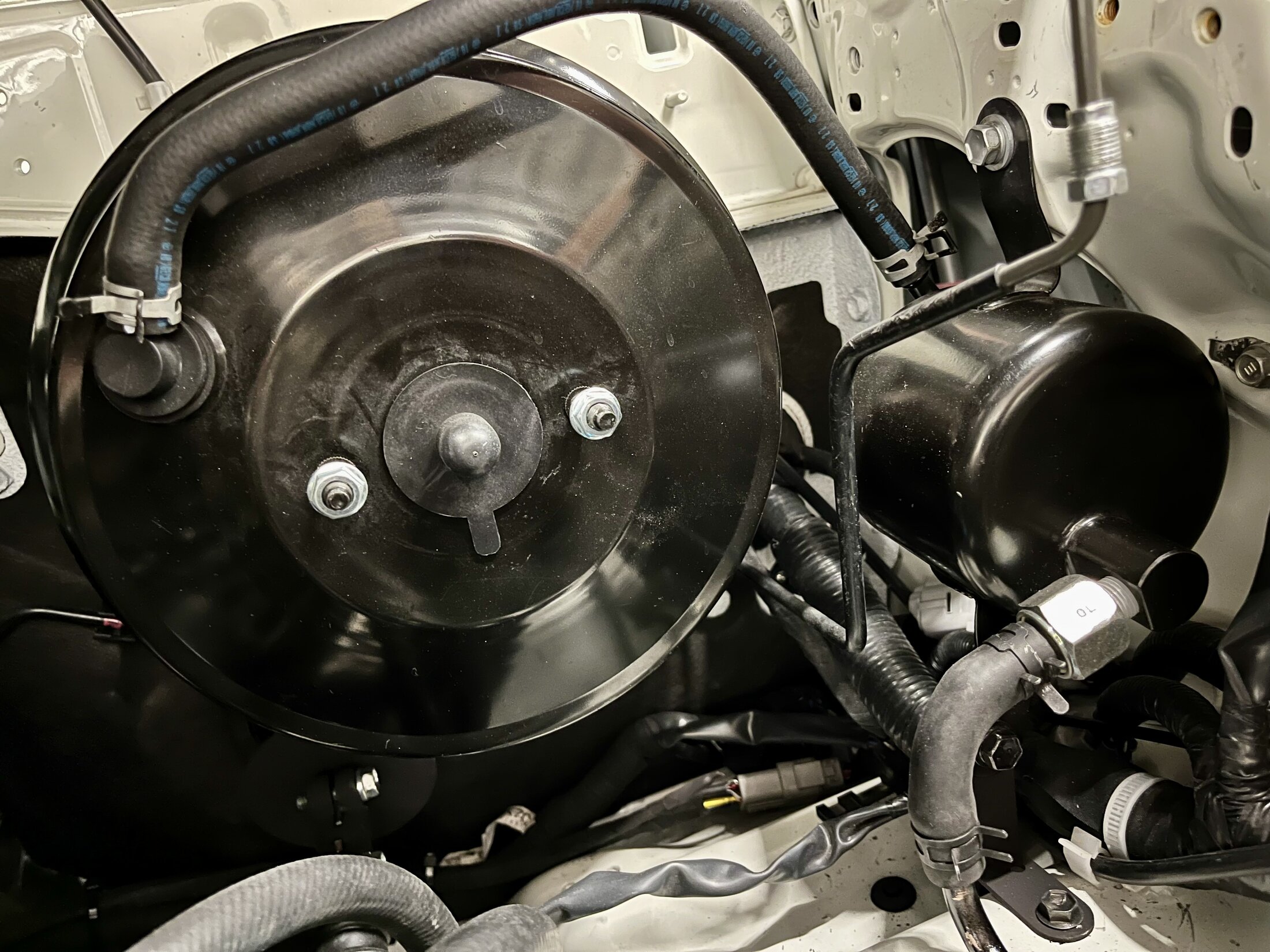

Vacuum system plumbed and reservoir mounted.

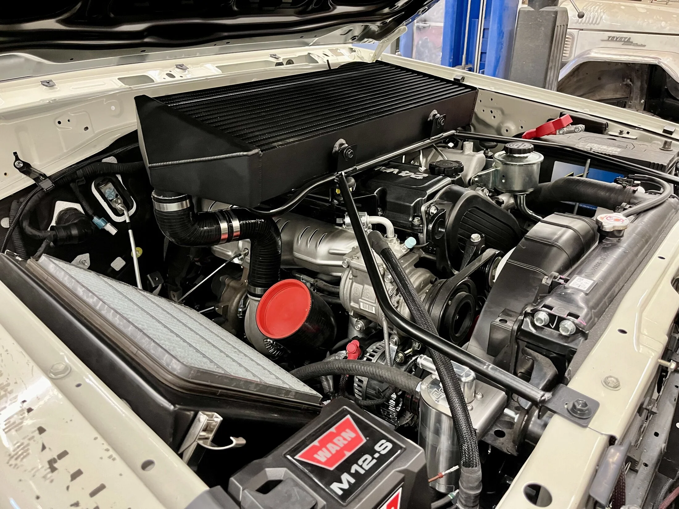

Engine bay is filling up, it will be full when we are done.

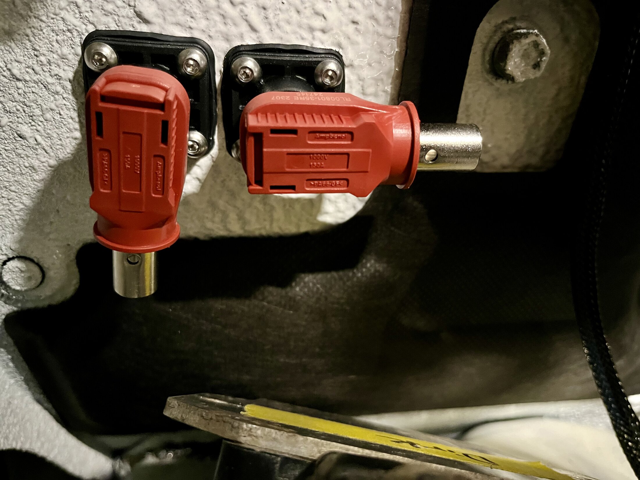

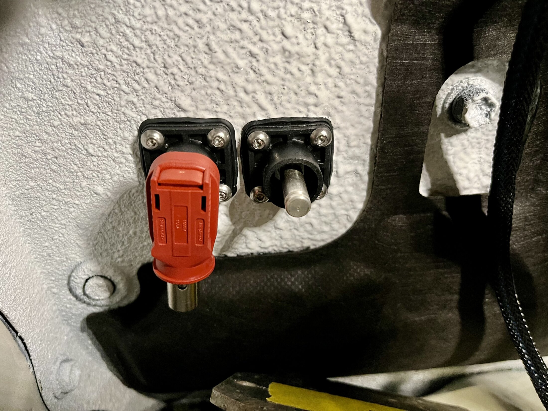

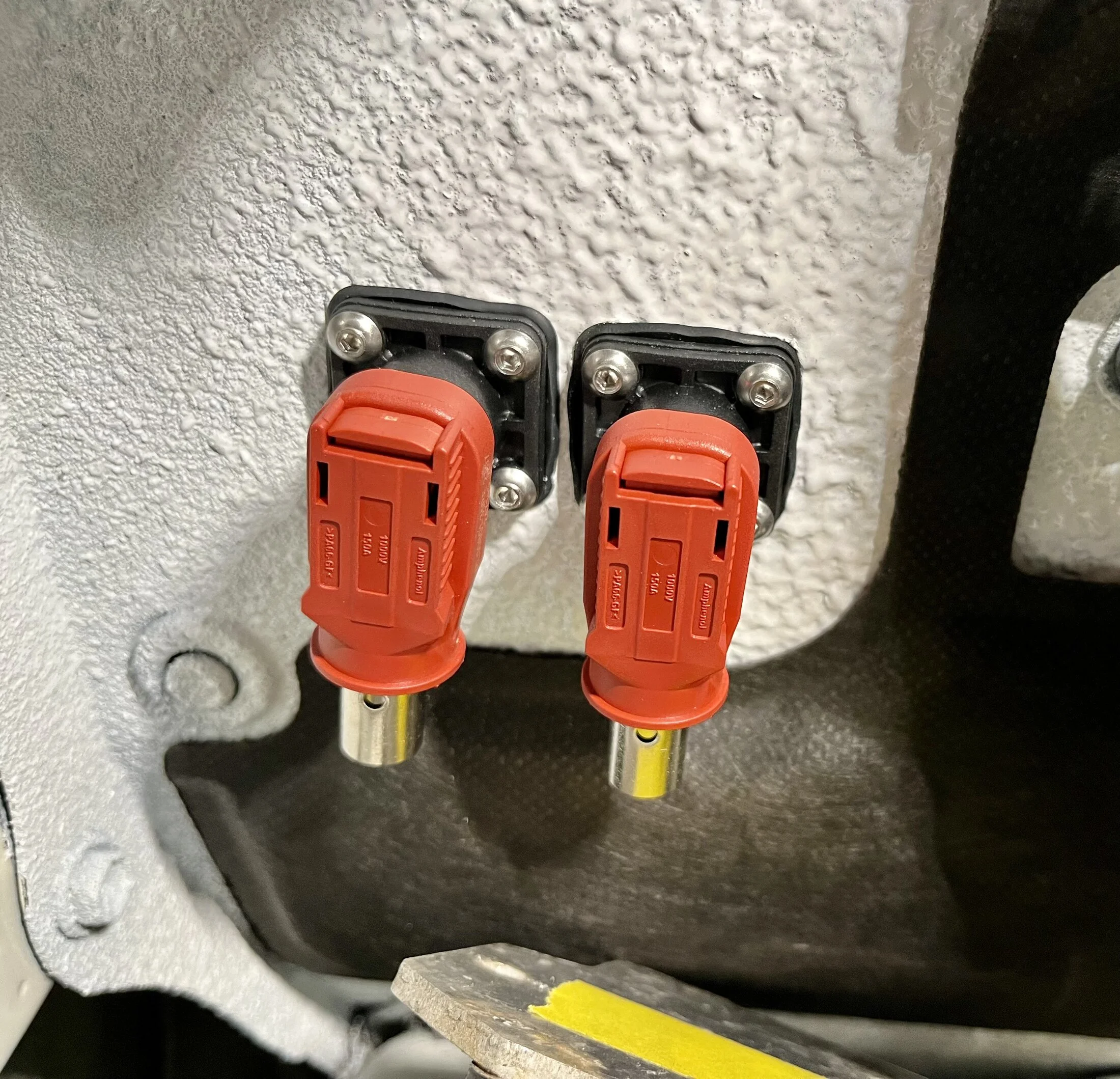

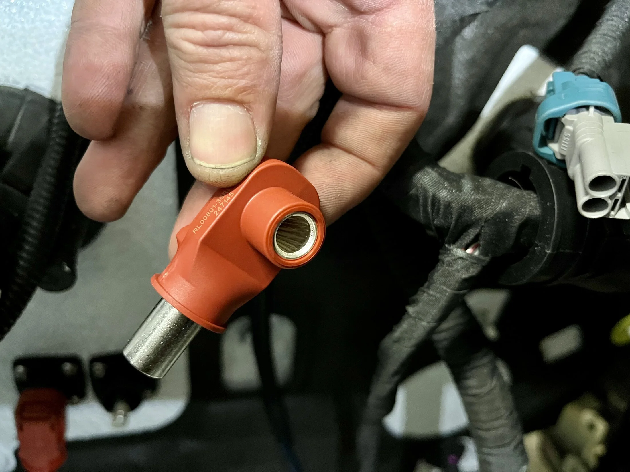

A new favorite of our shop for firewall pass through(s), used here for power to accessories.
Cheers

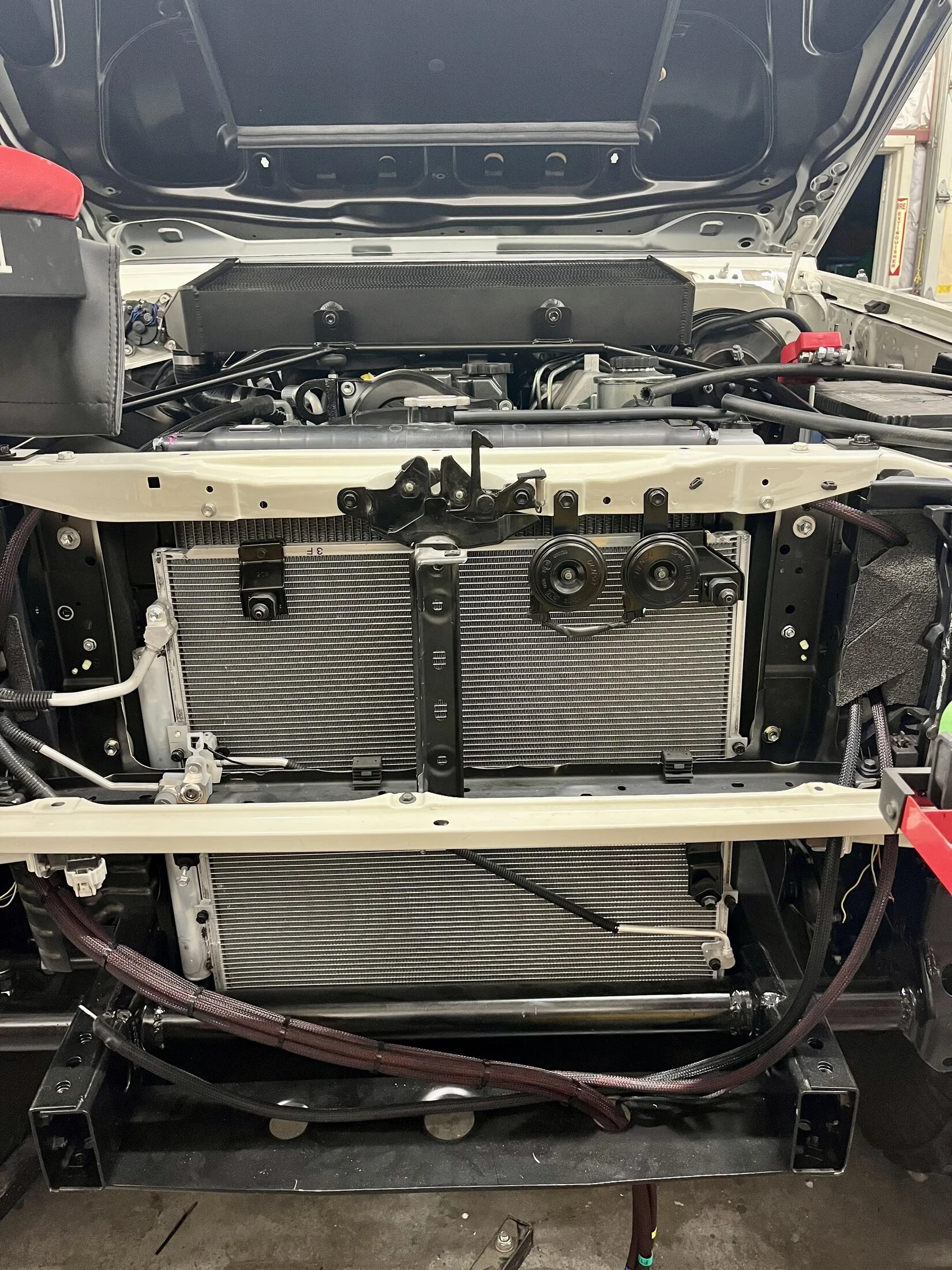

How’s the surface area on that!?
As I have mentioned in other threads, Toyota nailed it when it comes to cooling in the wide nose 70-series. It also fits oh so good in between the 80-series frame rails at the bottom. 🤩
Cheers
Cheers
you missed out on 1.5" of air flow....
bad form 2/10
