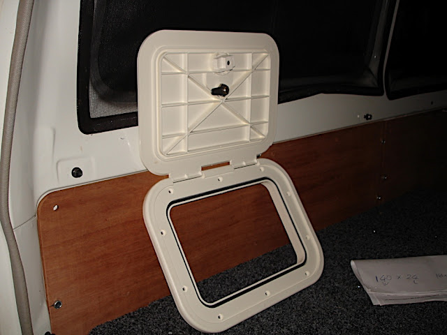

Thanks, good tip on the neoprene. I originally had planned marine hatches into the panels. Got the hatches but they are slightly too large... Will have to see if I can modify a bit. Nothing much happening at the moment with work really getting in the way.

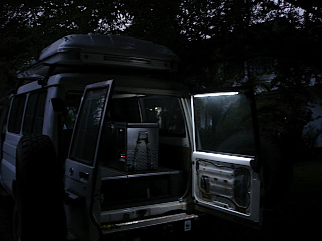

thanks for the words of encouragement folks! So just before Christmas DHL delivered me a parcel from UK containing some very cool LED caravan awning lights that I bought off fleebay... My idea was to supplement the crappy rear interior light and rig one up to illuminate the rear door where a drop down table is going to go. When I ripped the innards out of the carravan lights they were perfect - 50cm long by 1cm wide with 30 LEDs and fully waterproof.

Then I wired in one of the LEDs to the rear interior light (just removed the festoon bulb) so it works off the door - what a difference!
Then I wired in my two batteries - but the complete wiring is a LOT more work - but I am impressed with their performance. I have had the fridge running since Christmas morning, set on minus 15. When I hooked it all up I was on 80% SoC and when I turned it off today at 6pm (27th) it is on 58%. Not bad considering ambient is about 32 Celsius.
Here is the rear door table LED in operation:
These are the marine hatches that I will try to cut down to fit in the rear panels:
